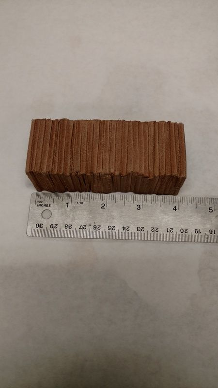

I thought I would try alternating thicknesses of leather, this is 7-9oz and 3-4oz cut into strips and roughed up with a file.

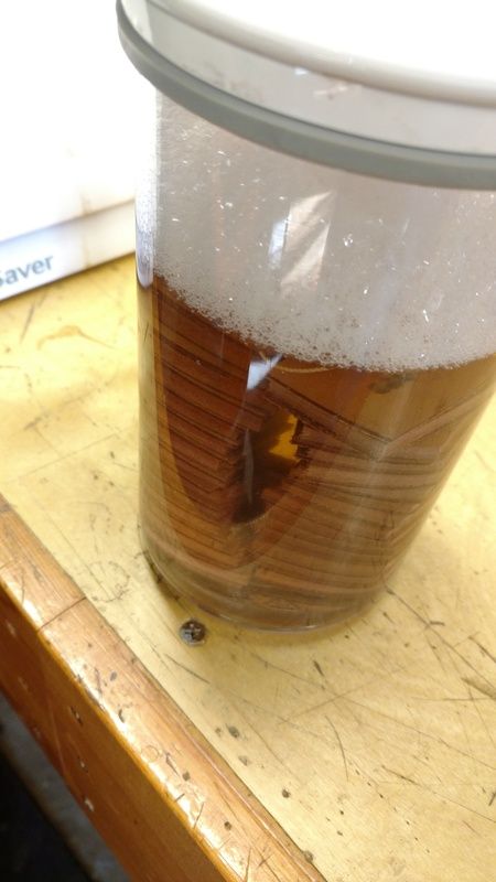

While the blade is normalizing in the oven, I'll punch some holes for the tang and soak them.

I use a vacuum sealer jar filled with water and a bit of dish soap to draw air out and soak the leather, so I can compress it. The vacuum seems to really draw the air out well.
I tie a string through them to keep them in the order that I cut them in. That sounds pointless but if there's variances in the thickness of the leather strips, it will be gradual instead of jumbled. The accuracy of the eye is a great but evil thing.

The 6 1/2" of leather compressed down to 4" (60% of the original size). The outside looks wonky, but just inside should be nice and even.
I've got a theory about this and it might be complete garbage, but all of the old leather stacks I see that didn't get great maintenance over the years have separated leather discs, loose pommels and guards. I assume this is from the leather shrinking and not solely from poorly attached pommels and guards. Compressed leather shouldn't shrink or swell even if it's neglected. Any opinions on that are welcome.
Dang John looking good! I agree I do not see how that leather can ever get wonky as tightly as it's packed. Liking the two sizes of leather.
I agree with you in that compressing the leather washers will make the handle less likely to shrink but I think all stacked leather handled knives need to have some sort of regular care to prevent shrinkage issues. I've seen leather stacked knife handles and sheaths develop a whitish colored mold on them from being stored in a moist basement over a period of time and also I've seen and repaired a few stacked leather washer handled knives that the leather washers seemed to have completely dry rotted until the handle would crumble off the tang. For what it's worth, I've tried treating my stacked leather handle knives with super glue, tung oil, polyurethane varnish and snow seal, they all seem to work pretty good but I like snow seal at the moment, the more you can do to eliminate moisture content in the leather the better off you are. I look at the old Scagel knives that are in good shape and wonder what he did, eliminate all the modern finishes first of all and what do you have left, some sort of oil and guessing by the dark brown/black color of his the handles, likely treatment would be linseed oil which was a popular finish in them

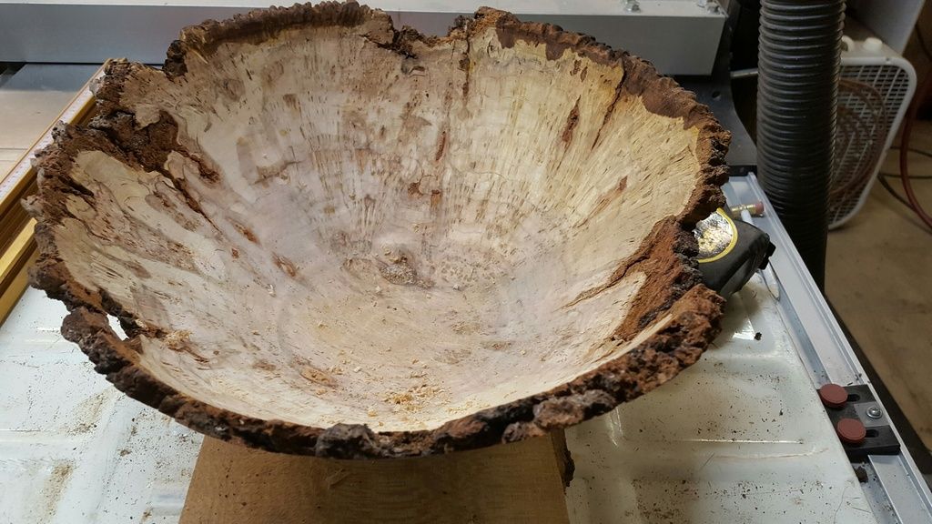

Don't know if you saw this one or not , it's in the rough out stage. The burl that I sent you for scales the other week this is the bigger half. The thing that's nice about turning is nothing is ever the same twice, even production bowls are always a bit different. So your always doing something different, using different skill sets, style's ect... About 14" wide and 8" high. This was a fun one. :D
That's gonna be a beautiful piece, that burl has great figure to it.
If by "fun one" you mean "Insane RPM's of puckering fear", then I agree:D.
