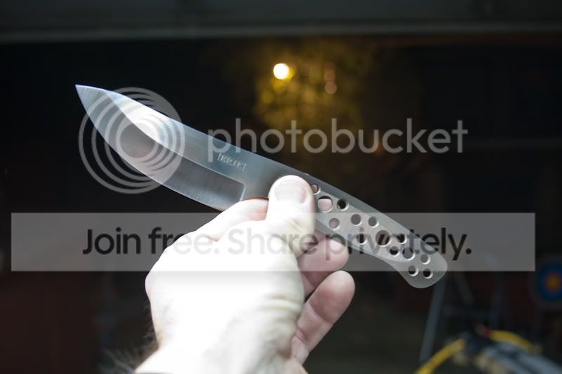

I think I over-estimated my window on second look Jonny. It's more like 5 weeks. :eek: I did ship em, wish me luck. In the meantime, I can play with stuff like this - you may remember it.

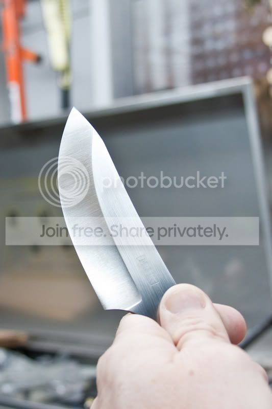

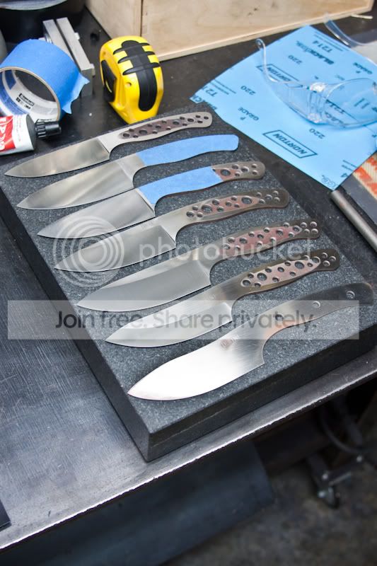

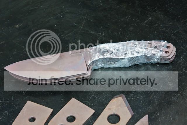

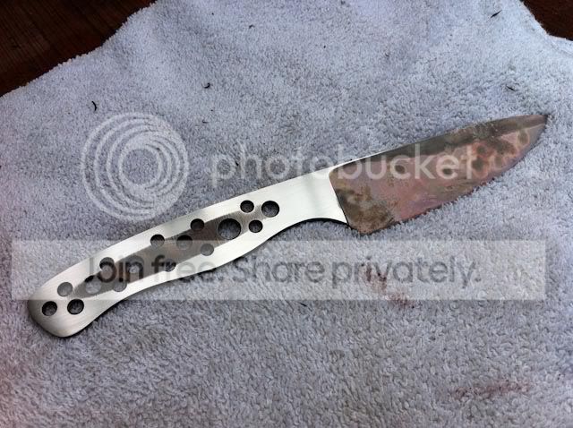

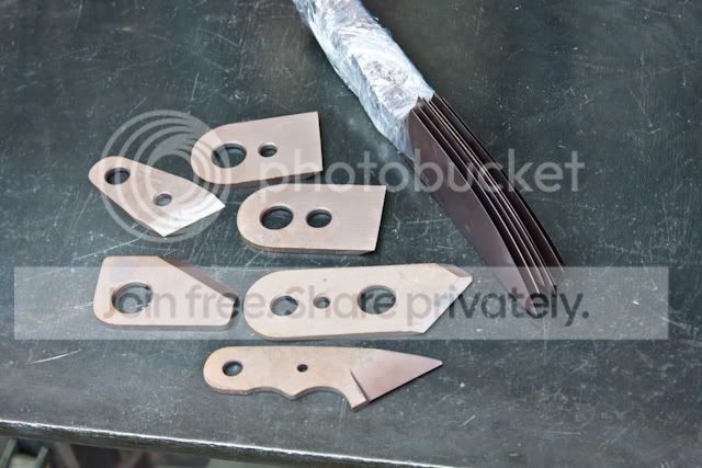

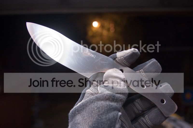

Here’s the batch after HT and with affair amount of bevel/flat work. This is my least favorite point in the process. To me, they always look better pre HT and/or post slabs.

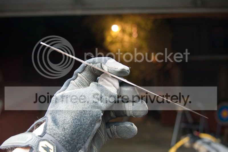

The one on the bottom needs some disc grinder love – It’s a vertical taper throughout.
Here’s the bottom one up close.
here’s a bad picture from the cutting side.

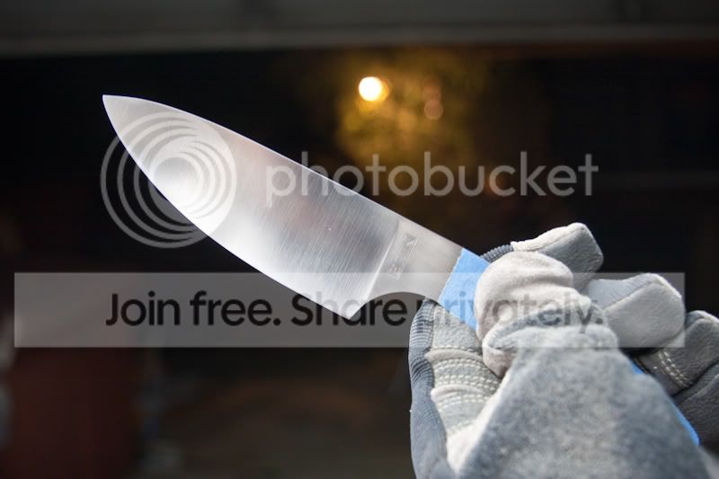

This one should be cool. It’s less skinner and more EDC, but I like it. I have a friend who I want to make a leather sheath for it. He hasn’t said “yes,” yet, so we will see.
This one may have the most visual appeal.

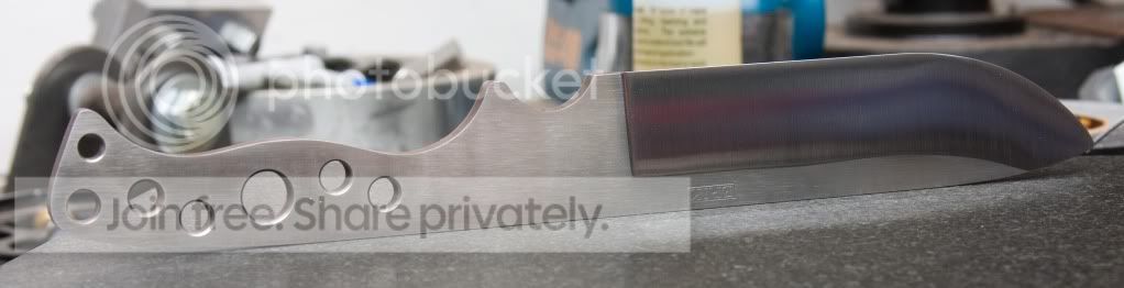

This one is pretty clean so far. Distal and tapered tangs, but heavier. My tapered tangs need more taper.

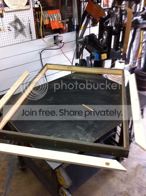

Here are a couple things I did during my downtime, outside of some other knives that you may or may not have seen.
Playhouse for the kids.
Frame for my sign.

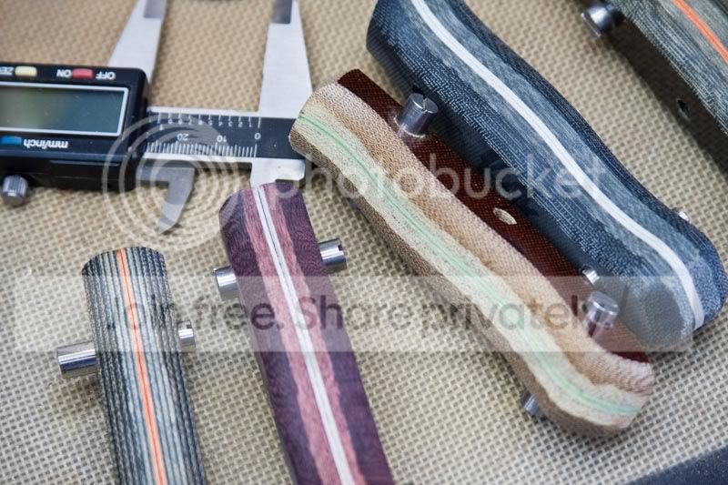

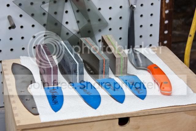

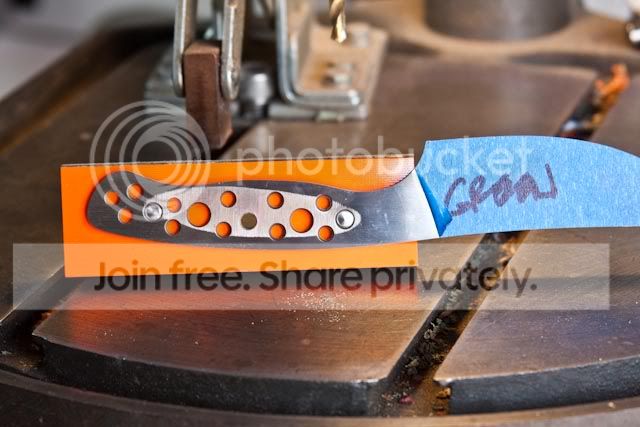

Thanks fellas, I imagine some will have scales on board next weekend for some of them. When I taper the tang, I also taper the scales so that everything is square before I get drilling. The disc grinder with the deck attached comes in handy for that, along with a caliper.

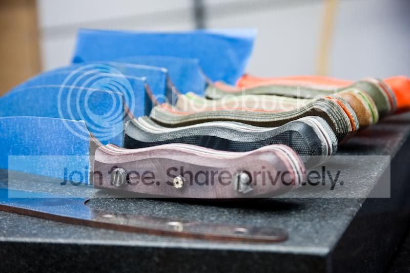

I finished 4 other knives and a dive sheath, but with the holidays, and needing some belts and paper, it took a while to get these going. Thanks Daniel and Matt.

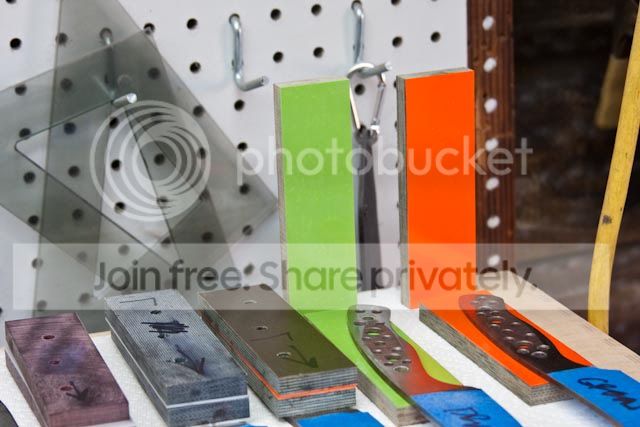

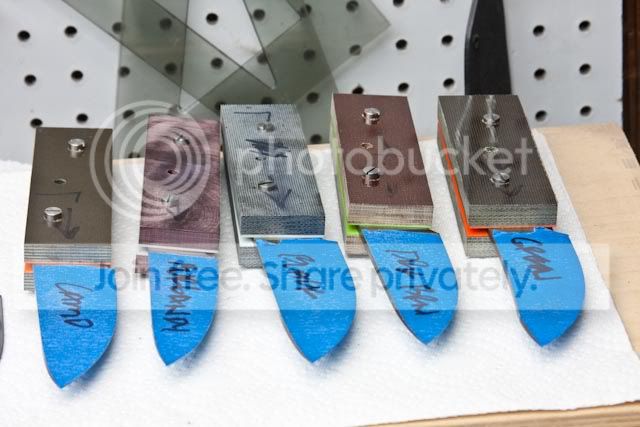

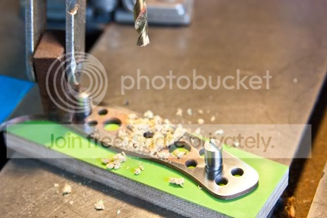

Here's where I am today. The slabs are camo, black, dark brown, and green canvas, and burgandy linen (all micarta). The liners are all g-10, white, grey, toxic green and hunter orange. The bolts are stainless and the center pins (not shown) are mosaic. All of the tangs are tapered but only by about .030-.040. (not much, I know). The slab prep and drill process is so time consuming, that in the future I will only taper when it's going to be a big taper. Some people shim their slabs for drilling on tapered tangs, I prefer to taper the slabs and drill flat. Either way, it's a process - especially with bolts.

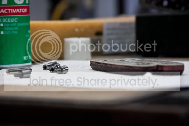

I roughed out the slabs and got 5 of the 7 bolted and glued today. I have to search for black epoxy filler, as the damn mosaic pin had voids throughout.
