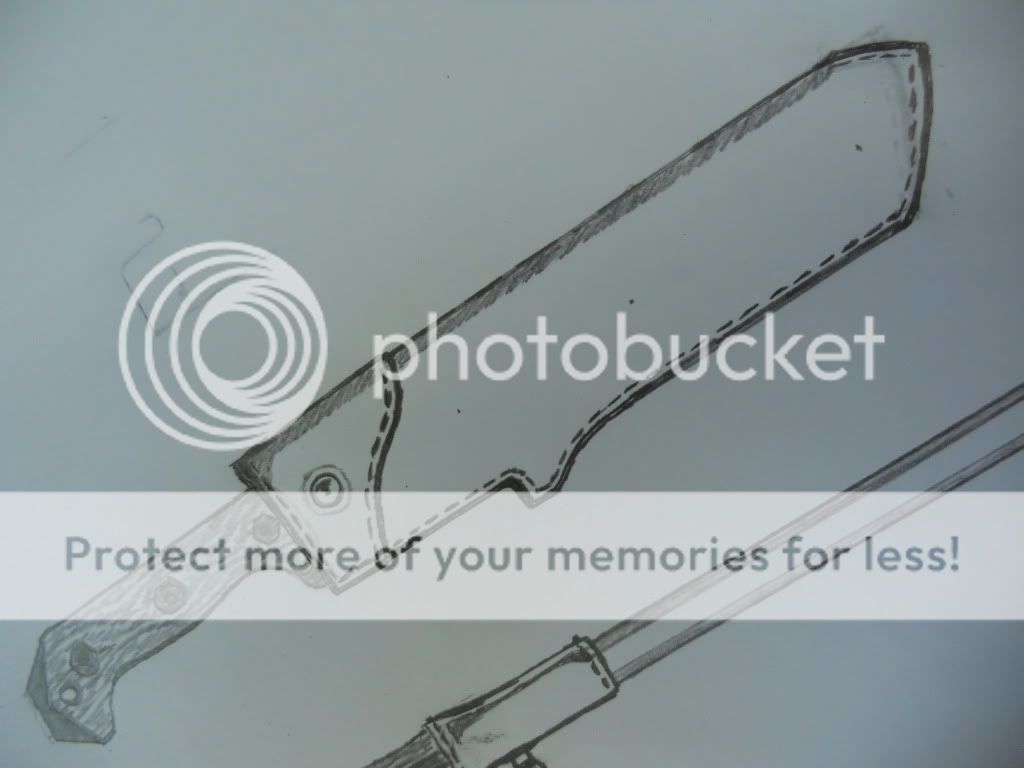

Ok, I made this up really fast because I'm out of state and probably have a long weekend ahead of me, so I should go to sleep soon, but here is my entry, just envision it being made out of leather, without the ugly square shape, and this is for either the 2 or the 16, modify the scale for either, but being of essentially the same blade geometry, with the exception of size, it should work fine.
Edit: One of my friends taking an engineering class asked if they could do a quick mock up (he's just learning to use CAD programs and wanted something not so theoretical), this is what he came up with, please note that he did this from only the black and white I posted above and the specs of the knife from the database, my original idea included snaps on the belt loops so it could be put on and taken off without removal of ones belt, and obviously the strap around where the handle goes would have snaps and be sized to the knife, nor he did not have time to include the strop or tin portion either, but that is something that he needs to know more about knives for, but like I said, he did a quick mock-up without much CAD experience or input from me as either of us would have liked. This picture is not part of my actual entry, but I thought it might interest people more than my black and white boxes...
Here it is:

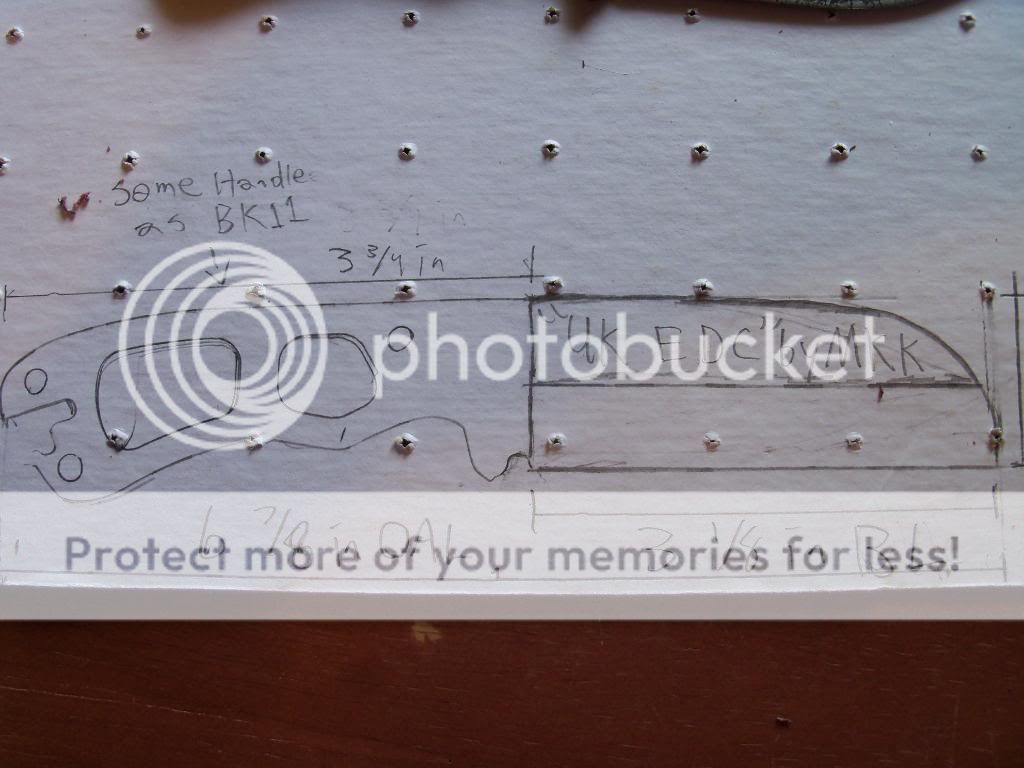

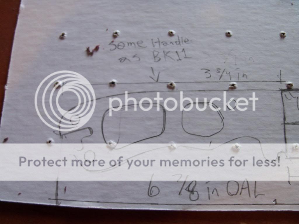

Thanks for doing this Sky....this is my first entry...
OK, here is a quick and dirty sheath set up moo-cow style....piggy backed with a bk 11
I'm not an artist....so even if this is quick and dirty, it might not get any better than this..

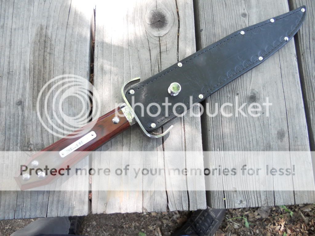

Now, the solution to this problem was taken care of a long time ago, in the form of an old-fashioned stud sheath. You know the kind I’m talking about; a basic pouch sheath with a metal stud sticking out at a 90 degree angle to prevent the blade from sliding down your pants. You can see these types of sheaths in old pictures of the Wild West and on antique knives.

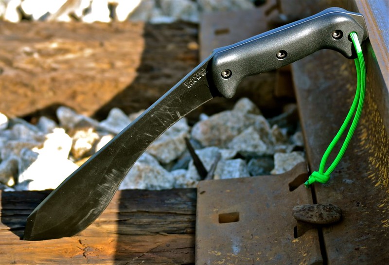

I have such a sheath on my Ontario Bagwell Helle’s Belle, and it makes carrying the blade easy to do.
Which brings us to my design. It is intended for the bigger Beckers, specifically the Machax or the BK-9. I’d be willing to bet this would work great with a BK-6 too, especially carried crossdraw through the belt with the edge up, like a katana. The design could house a BK-5 or 7 as well.

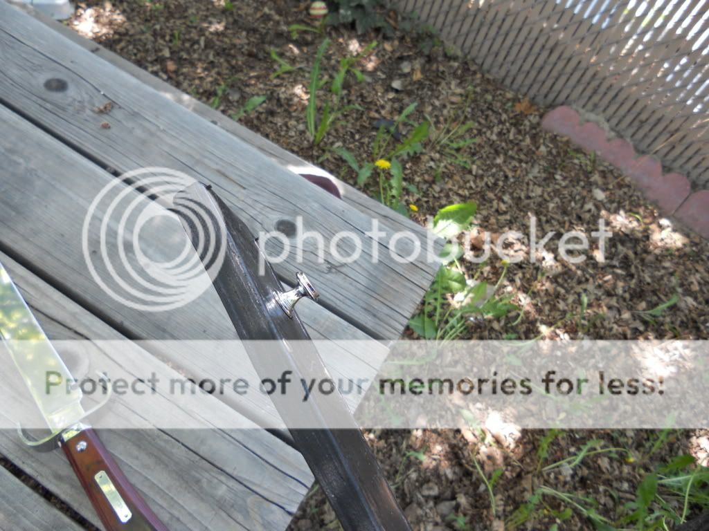

You’ll notice that there is a reinforced strip of leather at the mouth of the sheath. The stud is mounted between the sheath body and the leather strip so that if the user somehow damages the stud area, Sky can easily replace the damaged strip and the sheath is good as new.
There is a welt of leather that looks like a hook on the back edge of the sheath, mounted just over 2” from the stud. This is there to act as an anchor and keep the sheath in the belt on the draw, yet should not prevent the user from pulling the sheath out of his belt on command. Merely push the hook in as the sheath is removed, and the sheath should come out just fine.
