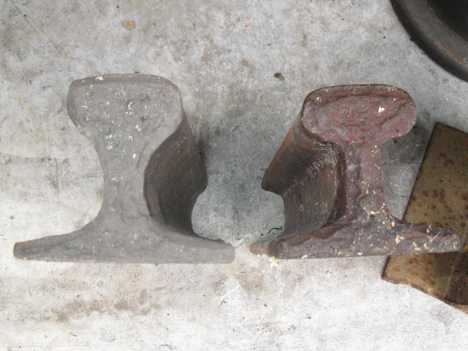

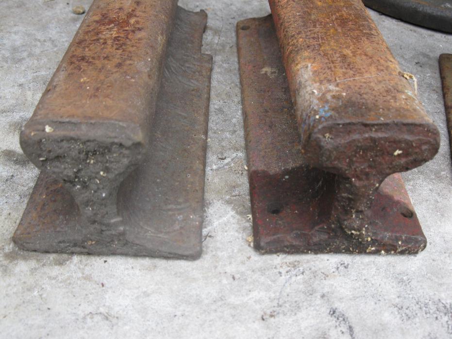

Examples of track cut by hand:
You can see that it was scored about 1/4" deep all the way around. Then the cut would have been propped up over the end of a tie. Hammering with a heavy sledge would then shear it off (relatively) cleanly along the score line.
If you had the tools and manpower aboard the train you could repair track in front of you with material from behind you. Then send a telegraph back to let them know to sent a repair crew out.
