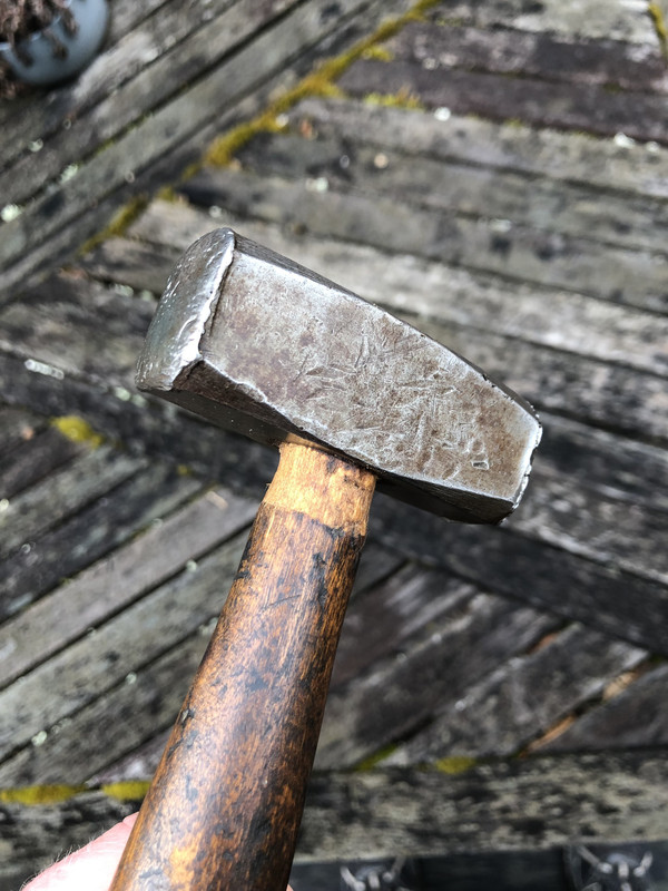

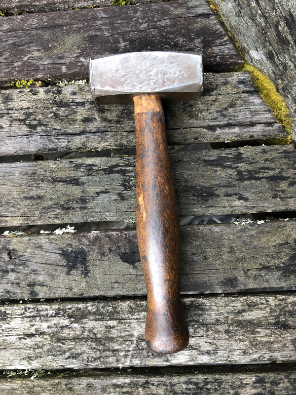

Here's an interesting one, found today at an antique store. No markings on it, about 4" long, handle is 10".
Odd duck for sure. It's handy to have both straight pein and cross pein hammers but I personally wouldn't want them on the same hammer. In typical forging you strike first with the pein then follow with the flat side of the hammer on the high spots. I wouldn't want to stop and switch hammers in the middle of a heat.

Is it possibly a saw maker’s hammer of some sort?
That's a good question...as I look at most straight and cross peins thinking how could this work on one of my blades...too heavy, to small, not suitable, could work if nothing else...just the first few thoughts whenever I see one...:rolleyes:
I hear that, but it probably depends on how big the saw is and whether you are tuning it or making it:
Saw filer set
Just guessing at his hammer.
What can you share about this beauty example? A filers hammer or saw makers maybe?
Are the hammer faces flat/flush or rounded?

Square_peg is probably correct in that Travbud’s hammer is for blacksmithing.
Miller, that is one that was in my grandfather’s tools.
He was a saw doctor by trade and blacksmith by necessity as well from what I understand. The faces are both dressed with slight rounding. It's 3lbs 7oz with the handle.

Well guys, I got curious and decided to pop the head off the handle and get a weight. My initial guess was way off, the head actually weighs in at just shy of 11oz.
Would such a lightweight hammer be of much use to a blacksmith? It seems like it would be more suited for "adjusting" instead of really moving metal.
Another thought, maybe it was intended for sheet metal/tin work?
I would say that this was a "saw doctor" hammer..... this type of hammer is used, with the saw on the anvil, to straighten, remove dents and bumps, and tension a crosscut saw.

The straight and cross pein now reminds me of a few things Warren Miller suggests how and when to use each the straight and the cross pein when doing just that. To straighten, tension, bumps, and the like.
Yes, you're right. That weight wouldn't be for blacksmithing. More likely for repousse or other sheet metal work.
