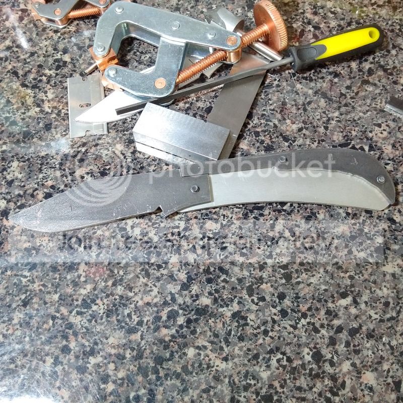

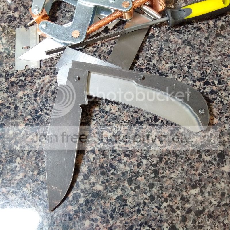

I'm working on my first slip joint and was wondering what I've done wrong or could be doing better. The spring is a little loose in the pocket right now but if I take out the middle pin and put a little pressure on the back spring it fits pretty well. I'm guessing it will be OK when there is a bend in it. The back spring is around 1/16" proud so I think there is going to be plenty of room. When does the bend get put in and what is the best way to do it? Once I round off the corners on the back of the tang the blade should sit in a little deeper. How much room in advisable between the edge and the back spring? I'm using 1/8" pivots to hold it together instead of pins.
It looks like a good start but you should pre-load your spring, not bend it. Personally I like my front spring pin to be a bit further back (about a third of the space you've got), even if I want a heavy spring, I don't want it stiff and under as much tension, although some will disagree with me.
I'm about to hit the sack, but if nobody explains how to preload your spring against the pivot, I'll explain tomorrow.
The spring should be pre loaded, that is the tip of the spring should be lower that the tang when the blade is opened by about 3/32 of an inch. Its easier to harden and temper the spring first so you know what the spring strength is and adjust the tang and spring to get the right opening tension. I agree the middle pin needs to be moved back to prevent excess strain on the spring.

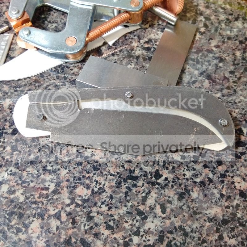

Also in your second pic the spring should be sitting all the way across the tang, for a better walk and talk.
Where it's at now Will Work but will bind a bit coming from half stop to full open.
But it will work how you have it just not ideal.
The only way to correct it is to build a longer spring or rework the notch of the knife where the spring sits in the open position.
I use a light table on my paper templates checking all these variables before I start cutting steel.
Looks like it's coming along good.
Each one you will pick up a little more knowledge.
Thanks for the replys. Regarding the pin location, I went off an existing Lanny's Clip template so I assumed it would be good. I was just looking at the fit of the back spring and I think I will make a new one as I filed it a little too short and there will be a hairline gap where it sits in the notch and meets the spine on the blade. While I'm at it I will cut the notch further into the spine to hopefully alleviate the binding issue.

I think once a small radius is added on each corner it will be slightly better, although the spring does seem like it may be just a hair short.
I do agree with the previous post that pre-tension should already be set by the time the holes are drilled in both the back spring and the handle. There are a couple of ways to do this, and while I have bent springs forward in the past, the best way is to drill your center hole in both the spring and handle, pin everything together, then kick your spring forward and drill your back hole. I also use a method where when scribing the back spring initially, I will scribe only the back half of the pattern, and then kick the front of the pattern forward and scribe it in a "pre-tension" position. It is then basically cut out in a pretension shape from the start.
If I'm not mistake, this is from the smaller Lanny's Clip pattern that I drew up in AutoCAD? (Based on Tony Bose's original design, of course)
I had drawn everything as it should kind of "finally" end up, though if you go strictly off of the pattern, it's not going to work exactly.

Lo/Rez, to get rid of the hairline on the spine you want a less than 90° corner on the notch, and/or a slanted front spring face....they should meet only on top, closing at the spine. Just have a look at Ken's picture to see what i mean. Also i suggest to have the spring a little longer than necessary (blade not completely opened) until the last fine tuning, to make up for the spring flex, which will have the blade open a little more and the closed position with the point a bit higher.
