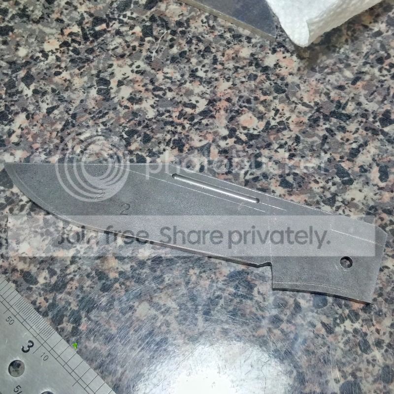

I made the new back spring for knife #1 and heat treated both. I ended up messing up the blade on the 2nd knife so I started another one and got my first nail nick done. I'm not moving too fast.

I like that nail nick. Did you mill that in?
Thanks. Yes I did. 1/16" ball nose end mill. I did a test run in some mild steel and then did this one. I'm new to all this. Just got my mill a week or so ago. It's around 50 thousandths deep. 3/32" blade stock.

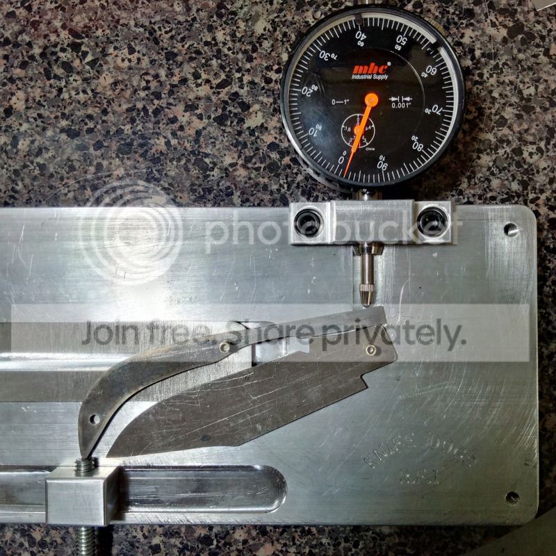

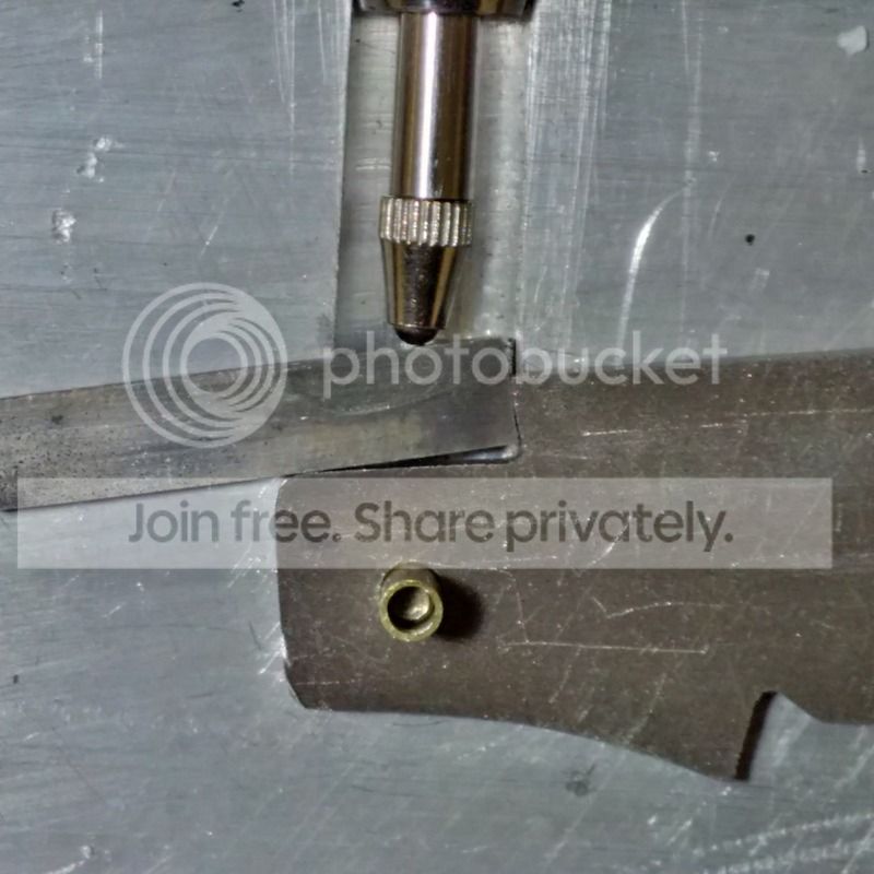

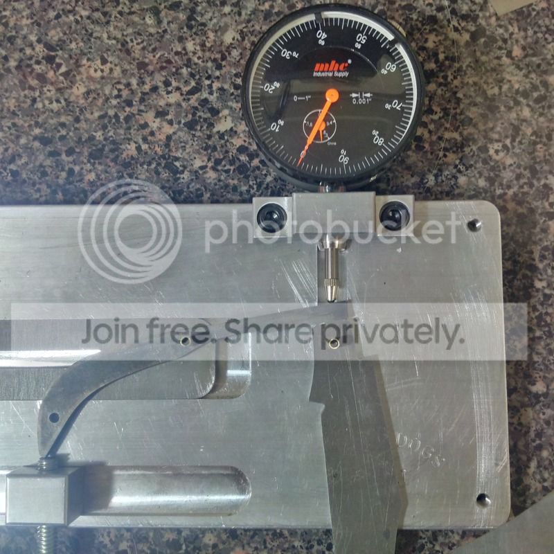

I messed up the back spring on knife #2 and will be shelving that one for a bit. Thankfully I'm working on two knives. I have it somewhat close on the rise and fall indicator but am concerned about the blade and back spring fit. What do I do now?
The spring is pretty strong still. Should I take more off the walk part or file some more off between the walk and the center pin?
You are going to have to get it lower in the open position, (more off the top of the tang)
then work half stop, and fully closed from there.
Ken.
To lessen the stiffness you have to grind between the walk and the c.pin; now you see why the pin distance might have been a bit more than it is...
Be aware, before skimming the flex portion, that the stiffness will be somewhat less anyway after you have grinded the back flush.

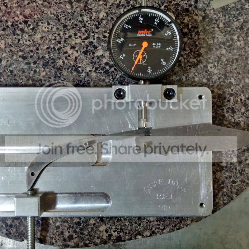

This is where I'm at right now. I think I may have made the spring a little too weak so I will make new liners if it is. I can use these ones for another build I hope. The tip is still too low, I hope I can adjust that without messing other things up. As of right now I just put the blade in the oven so maybe this weekend I will have some grinding to do.
