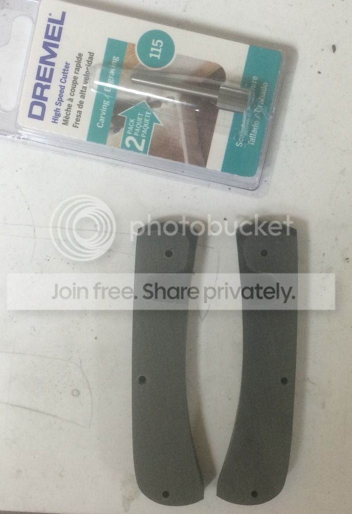

Got the liners milled out this evening and sanded.
Ended up using s HSC bit from dremel, worked out great. I fed by hand into the drill press slowly gave me controll.
I'll probably setup a jig now just for doing this.
I do have some brass on order for liners on my next one but don't know yet how I will relieve them.

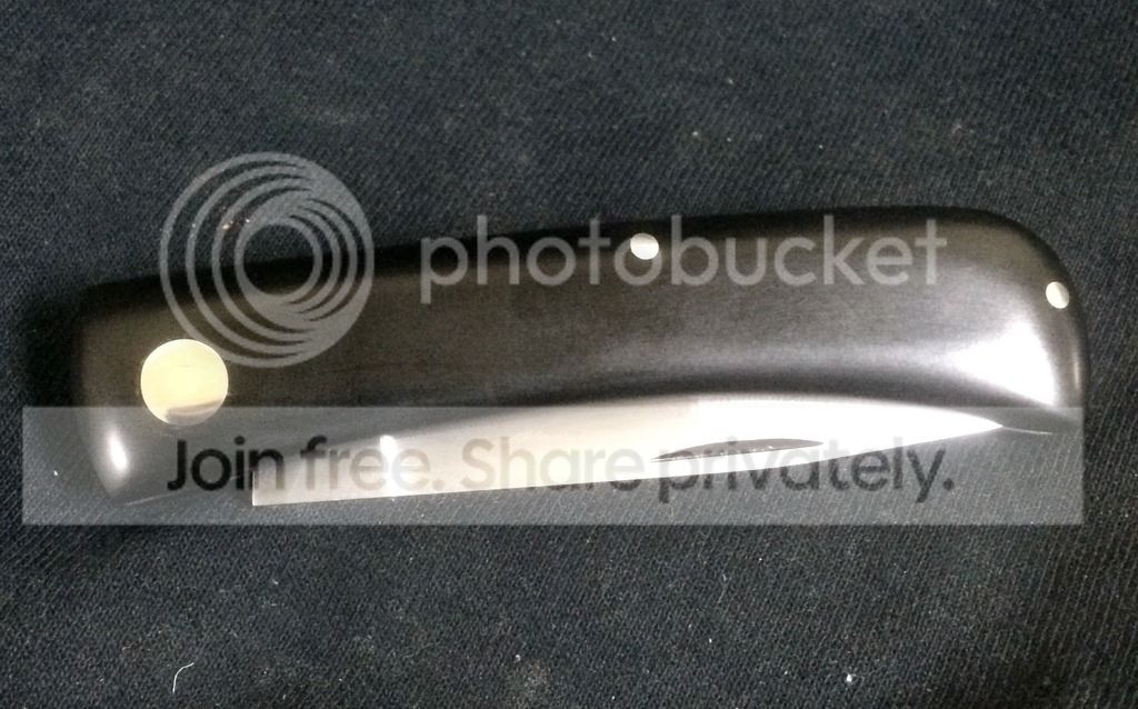

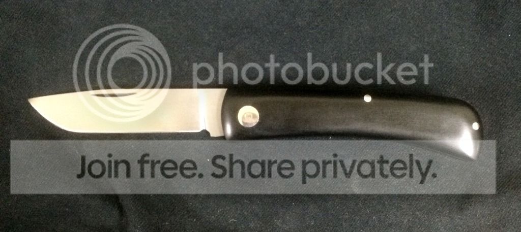

Well I'm calling this done and a lot of lessons learned.
Black paper micarta is a mother to finish.
The peening went good, but got a little halo around my birds eye pivot. I probably should of turned down my washers a bit.
Blade not perfect centered, but I blame that on my grind and not using the granite enough.
On a good note the action is very nice, and pull is good.
I think I'm going to use linen on the next and stay away from the black paper.

That's a nice lookin' sodbuster! Looks like you did a great job on your first, and they'll only get better from here.
The knife looks great esp. for your first. There's a bunch of people out there not worrying or caring about a good
peen job, just use brass or some contrasting metal and call it a "birdseye" To me a good peen job means like
metals and no halo.
