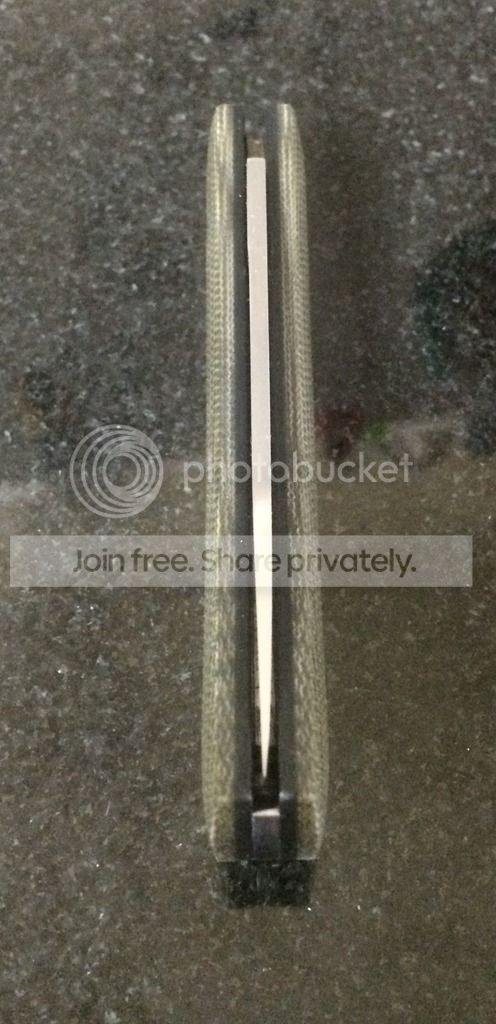

I'll second the others: blades can and do move off center when peening if not careful. Something that may help is getting a straight reamer for your pivot hole, just to make sure it's as round as can be. Flatness is obviously key as well, but again, there is some adjustability here or there.

Even the tiniest bit out from tram on your drill or a slightly wandering drill bit causing you to have a slightly less than perfectly vertical hole can result in your tip laying off center, a 1/16". Your spring being a couple thou thicker than your blade tang can cause it, your pivot hole in the tang being off square can cause it. Your peening of the pivot being too much on one side can cause the liners/bolsters to shift ever so slightly out of square and cause it, and about 50 other things can cause it.

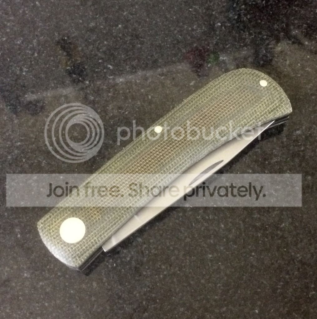

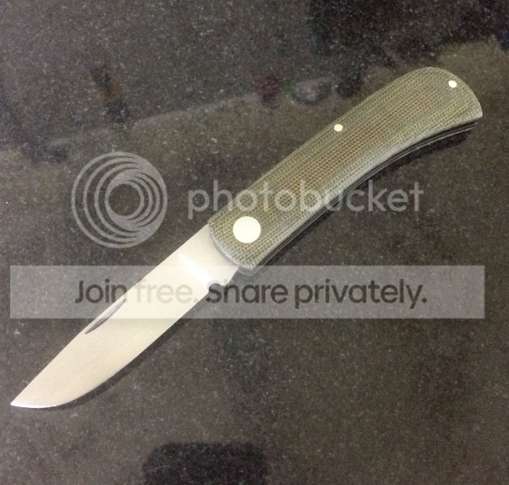

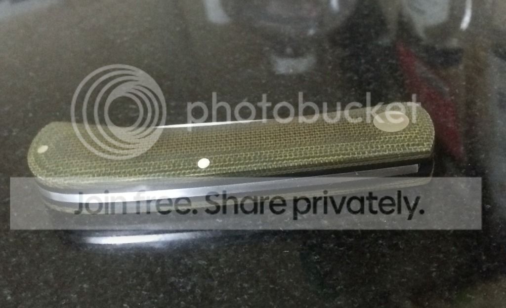

Well I was able to save the blade and spring...
New scales were made green canvas with black g10 liners.
But before I did anything I checked all the machines for square a true. My problems were not there.
I found my blade grind to be off about a 1/16" and fixed that.
My reamer I believe was going to deep thru the holes drilled so I removed about 1/4" from the tip.
I think it was creating the scales to shift when peening.
Also I changed up the reamer going thru the washer, to a little more aggressive angle.
That way I can mushroom the head and blend it seemlessly into the washer.
I also started my peening on the pivot. Before I did it last.
Anyways it came out dead balls center!
Thanks to everyone's advise here I was able to solve some of my problems.

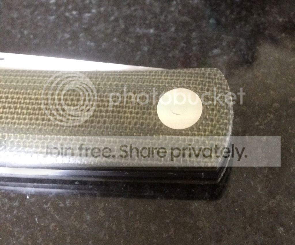

But I will point out that I still did not get a seemless look between my washer and pivot pin.
The reamer worked great but I did not move the metal around perfect so that still needs to be addressed...
I'm not sure why it did not work.
Maybe it's just more time peening and knowing just how much pin to leave up before peening????
When I tried to re- peen on it just to move the metal it just got a little stiffer action so I stoped.
I can still pinch it open pretty easy and going to have to call it good.
Or is there a fix for this??

Your updated knife looks great! glad to see you were able to fix most of your issues. As for the small gap where you peened into your washer, that's probably just a matter of more practice. Looks like you just needed to move a little more material to that side.
