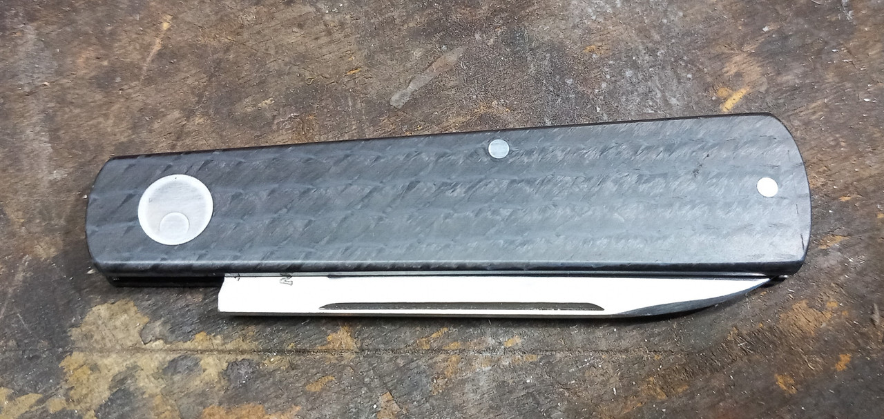

I keep having problems with the pivot pin not disappearing. Grinding after hamering it looks gone but it comes back when I get to the finer grits.

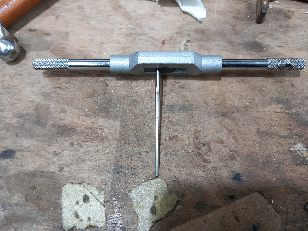

I use a 50:1 conical reamer to remove a very small amount of material and I think that the pin expands at the surface but doesn't fill the cavity a bit deeper.

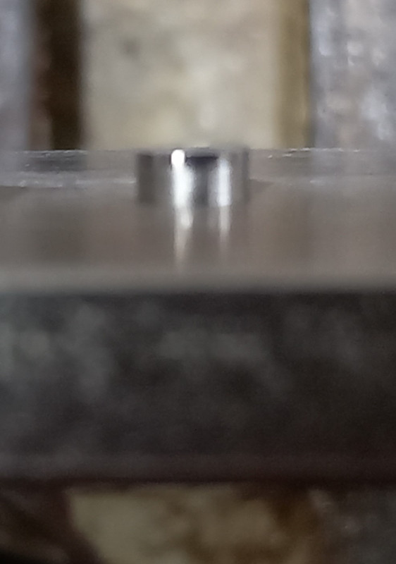

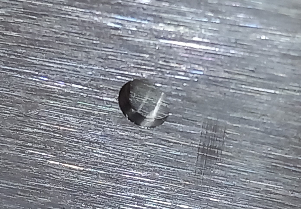

I grind the sides of the pin with 400 grit. I knocked it back up. It is shiny at the top but the cavity goes deeper. So I think there was a hollow under the shiny part.

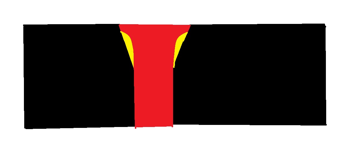

Black = bolster
Red = pin
Yellow = cavity as I suspect
What do I do wrong?
Some suggestions:
Make sure the pin expends about 1.5mm above the surface before peening. This gives metal to expand.
Peen it from the center, not the edge. This expands it sideways, not like a mushroom.
Make sure the pin is annealed so it will expand.
Peen a bit harder.

Hengelo_77 Hengelo_77 I don't see the material identified for the pin. What is the material and how was it annealed? Stacy's right, for that to expand like you want you will need to anneal it. And, remember, it will work harden from the first smack - make it a good one. This isn't doming, as has been mentioned. I'd also consider making myself a pin-setting jig if I was going to make pin-pivots where a small "anvil" and hammer are what set the pin and your hammer hits the head of the "hammer" Instead of the object and the handle scale you just ruined. The flat of our ball pein is great with the bolt/anvils.

1010-1120C (1850-2050F). That's a shade or so brighter than orange, more yellow to my eye. Cool rapidly, as in stick it in water. Slow cooling allows carbide precipitation and hardening. You want to treat the nickel like it's in brass.

Bill Ruple has a video where he says that he doesn't taper holes in metal (i.e., bolsters and birdseye pivots like you have) and that makes it easier to hide pins. To my eye, my tapered reamer looks even less aggressive than yours, but it may not be. I do not try to mushroom over the pin tops. I bang on them straight on with a (mostly) flat hammer. The end result is not a pretty domed head, but a stubby pin.
Ream your hole until there is a slight burr all the way around.
Sand your pin to give a clean surface.
Use acetone to clean the pin and the hole until there is no oil or residue on either of them.
Peen the pin until if fills the void, then keep peening until there is zero blade play.
These helped with vanishing the pin.
