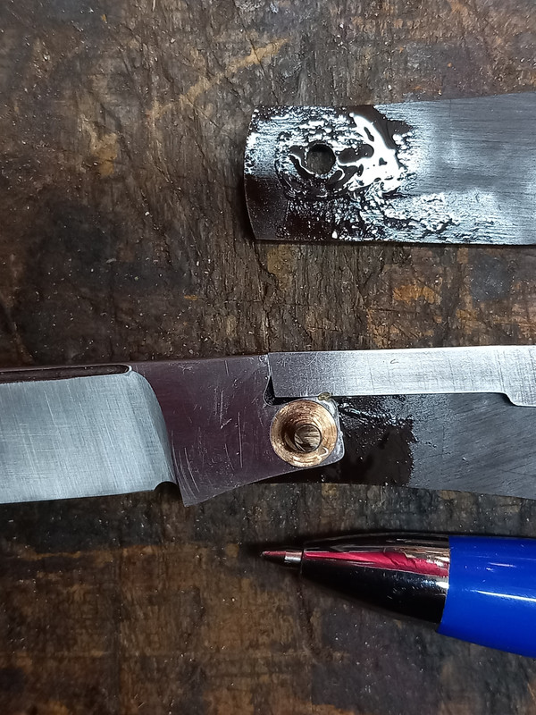

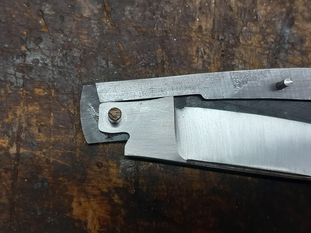

I'm a bit confused. I have three slipjoints back from HT and I'm trying different grit finishes on the tangs and springs.
I'm at 240 for the spring and 400 for the tang. I also used some scotchbrite by hand on the corners of the tang.
I have the feeling that blade opens/closes less smooth them before. Am I doing something wrong?

I am curious , and know you mentioned the RC of your heat treated springs and tangs. Are you able to verify yourself or going by what the HT company says? The reason I mention this is that I am aware of a knife maker who had been heat treating springs and blades going by the available heat treat formulas. When he put in a hardness tester he was surprised to find out his springs ran about 10pts higher (dont recall the exact amount) than what the heat treat data suggested. An eye opener for sure. For a long time I would check every blade and spring after heat treatment until I was confident enough to check a sample from batches.
I wonder if perhaps we all might be zeroing in on the finish or lack of finish and to what degree. Might we be better served to check and recheck the blade tang/spring hardness's and geometry? By geometry I mean that the bearing surfaces are truly square to the sides. The corner radius's are proper. Pre-loading of the spring and blade are important also along with the pivot pins being square with the frame. The tightness or looseness of the pre peened blade and spring in frame can also cause issues giving false smoothness feelings or un-even digging in or galling of the bearing surface.
Not saying every knife I built had that buttery smooth action right from the get go. That being said when I had things dialed in very seldom would a blade and spring need a "break in period" or even anything but a light weight oil to lubricate things.
I have no way of checking the actual hardness of the spring, I go by what my HT-guy put on the invoice.
It does show small dents on the back of the spring from what I assume is hardness testing.
I checked the invoice:
The spring is 1.4034 steel which is close to 420 steel and came back 42-43 HRC
The blade is RWL34 which is close to CPM 154 and came back at 61-62 HRC
Just a thought, did I round the corners to much, having more/longer contact between the tang and spring?
Would that cause extra scratching?

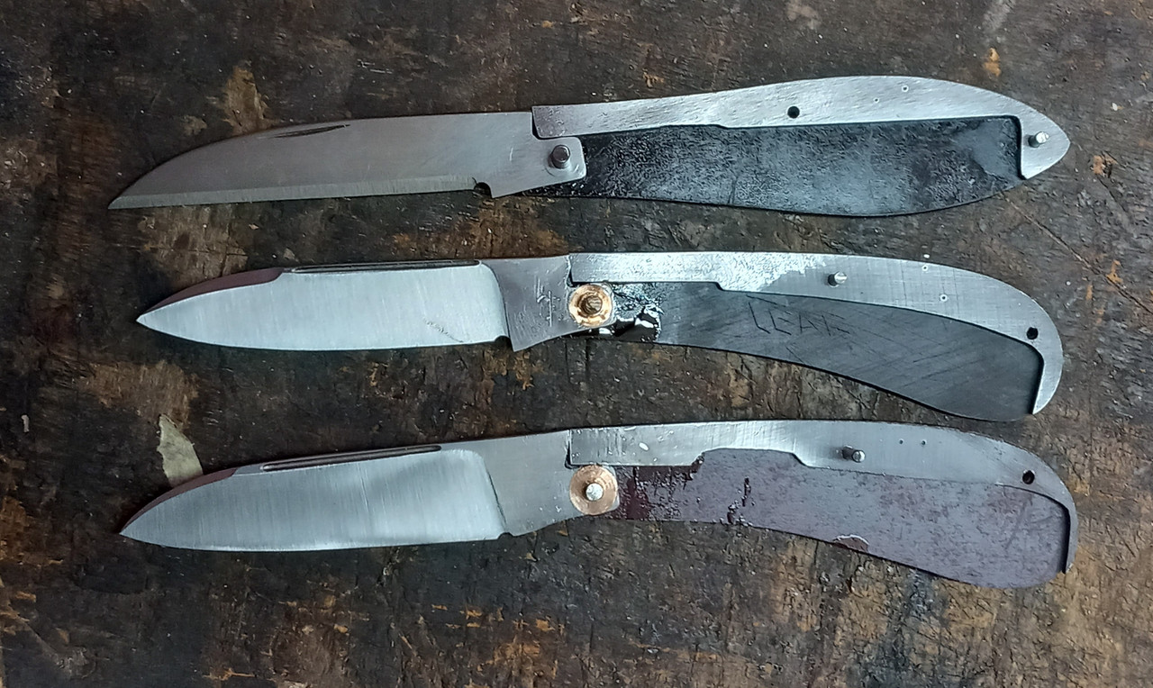

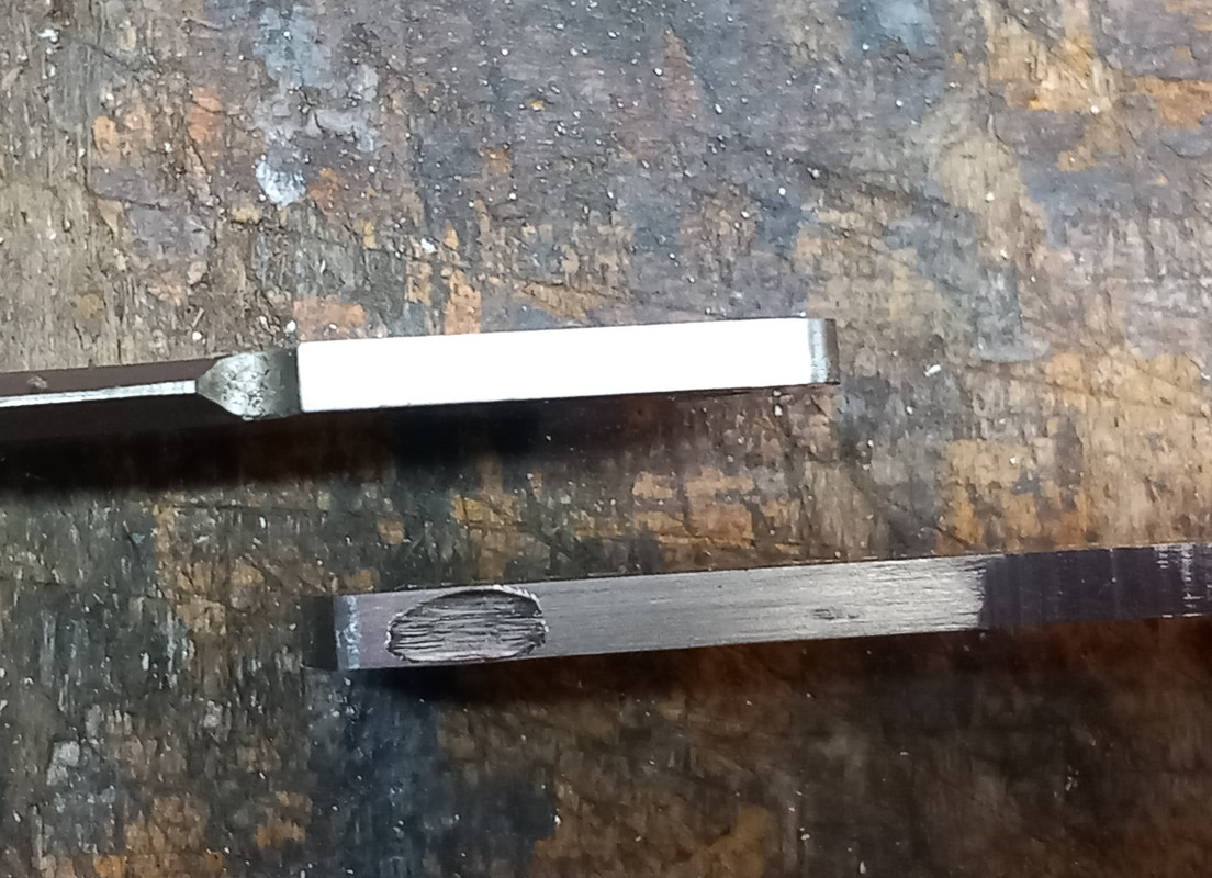

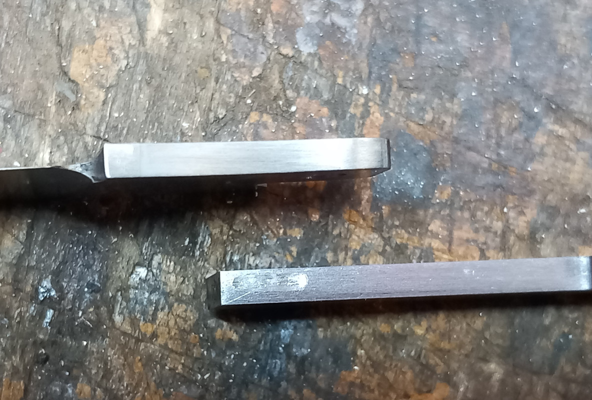

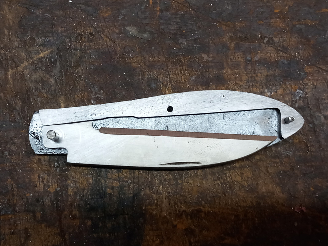

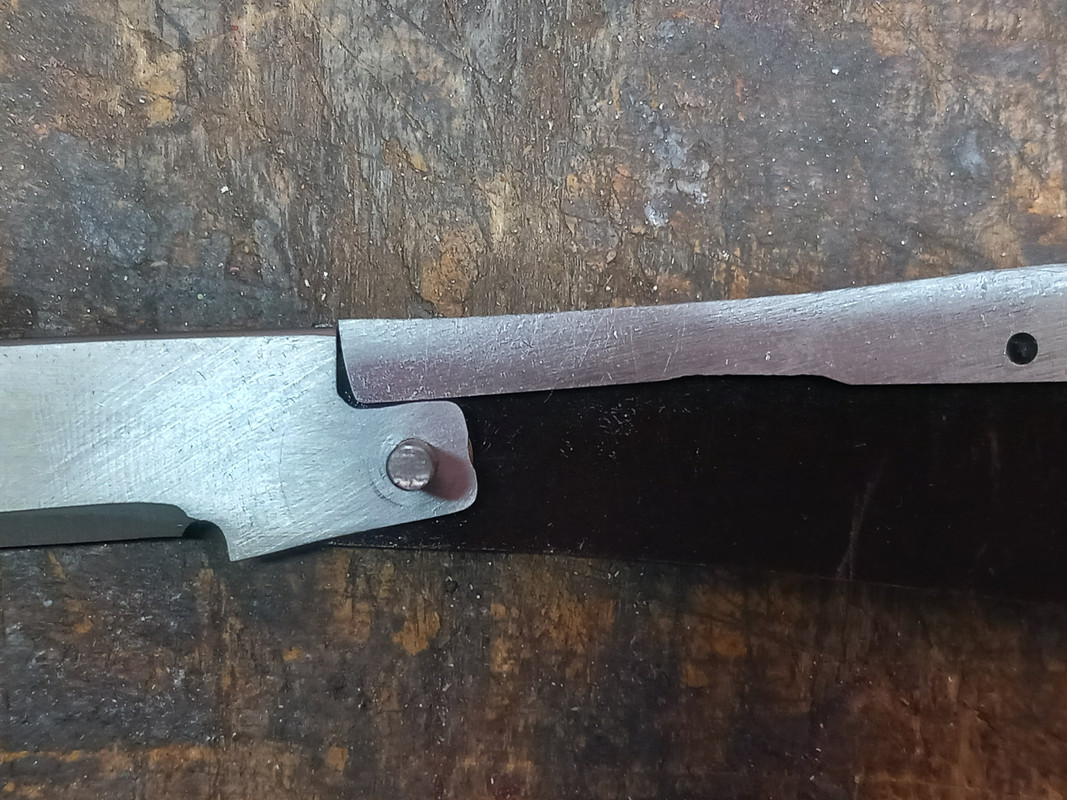

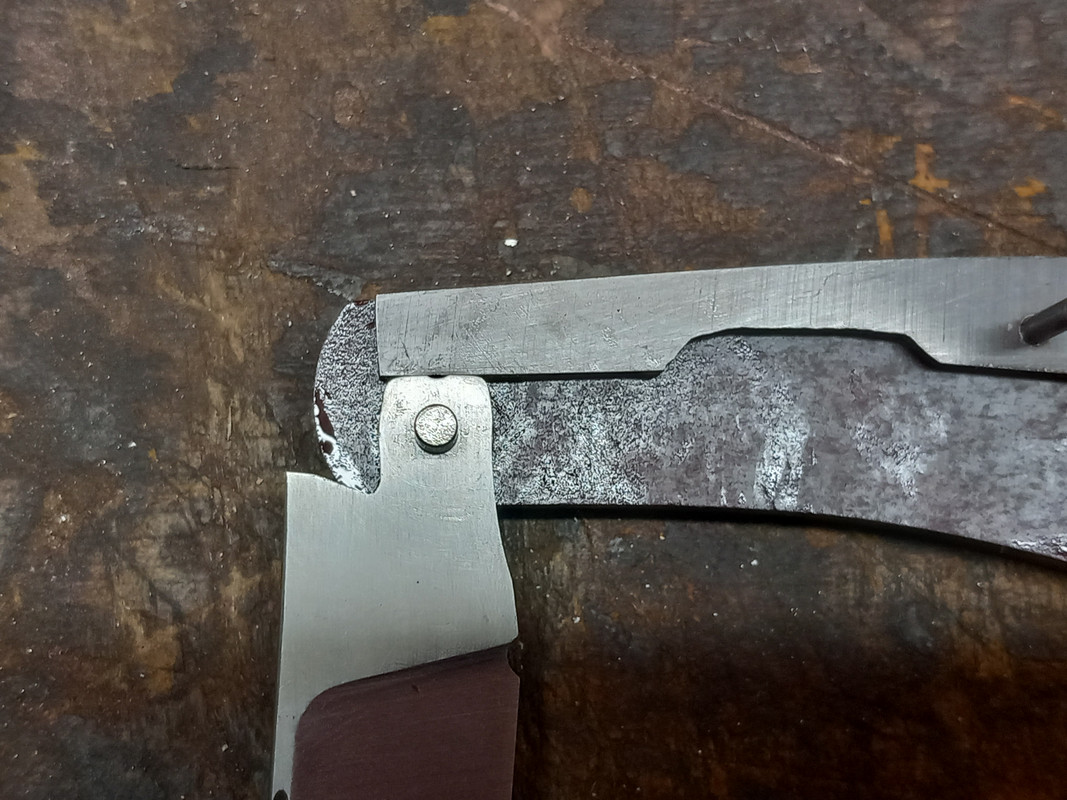

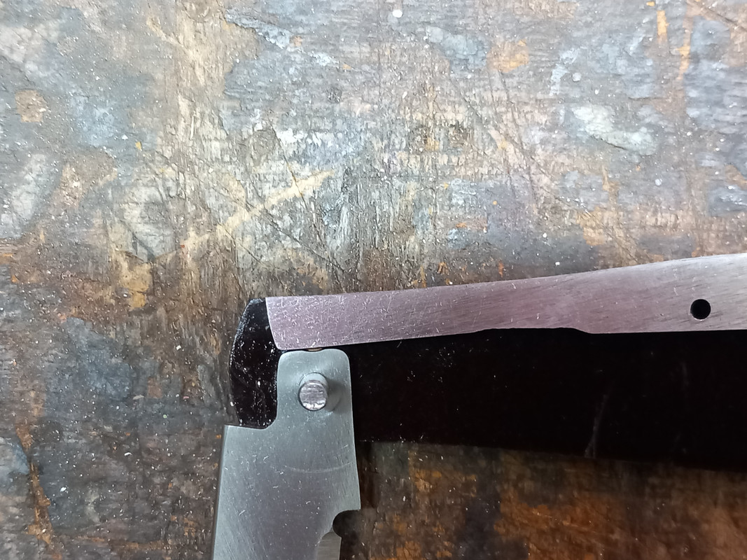

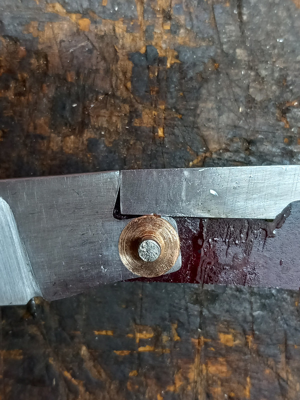

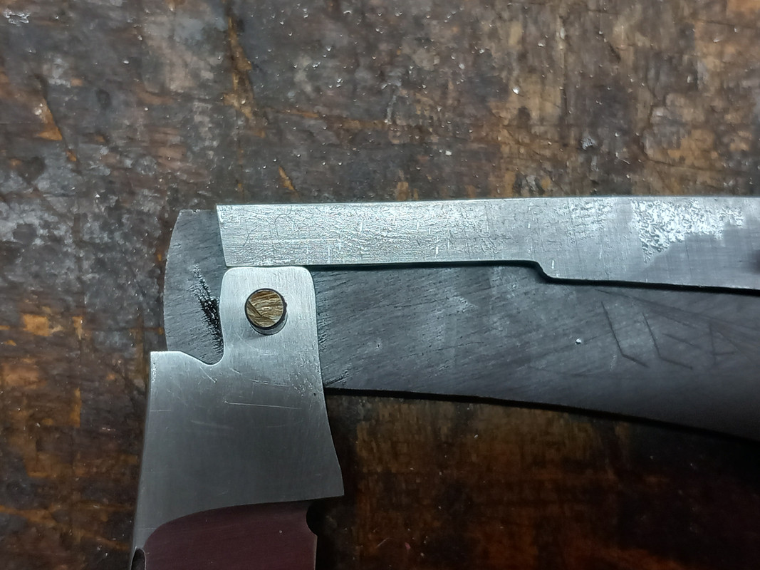

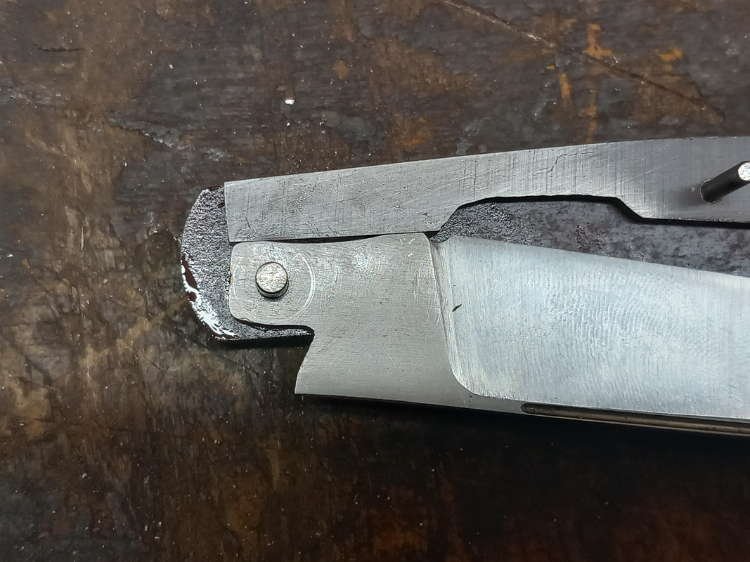

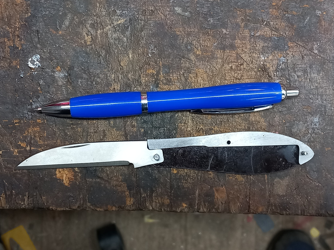

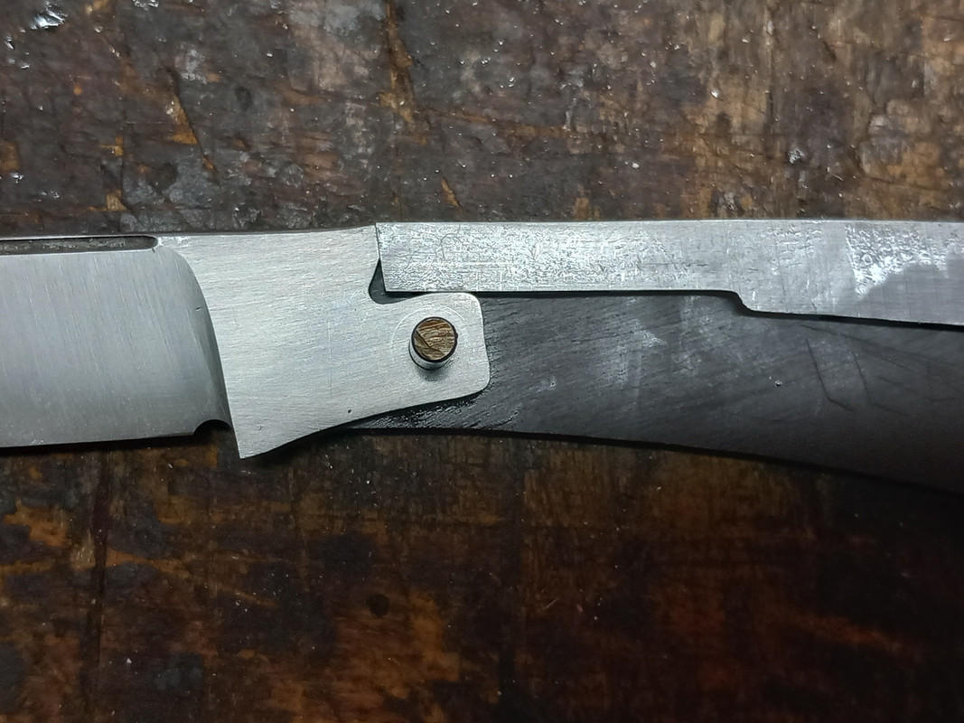

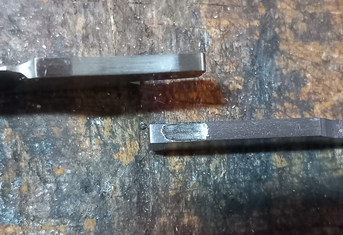

I'm working om three slipjoints and made pics per knife.
All three tangs are very scratched. I tried putting the together and opening/closing them 100 times.
Im my mind these three are written off, but I'd like to learn how to prefent this in the future.

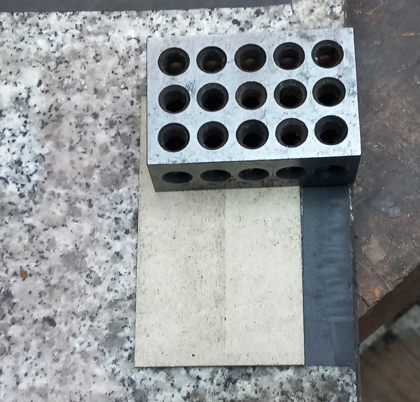

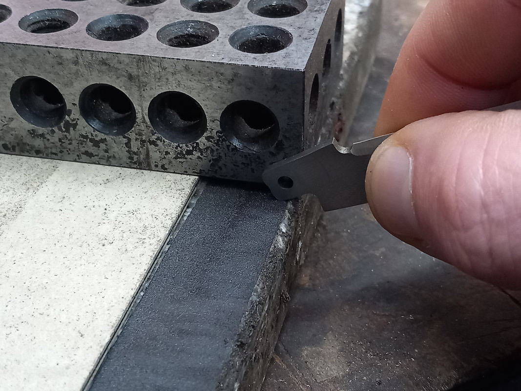

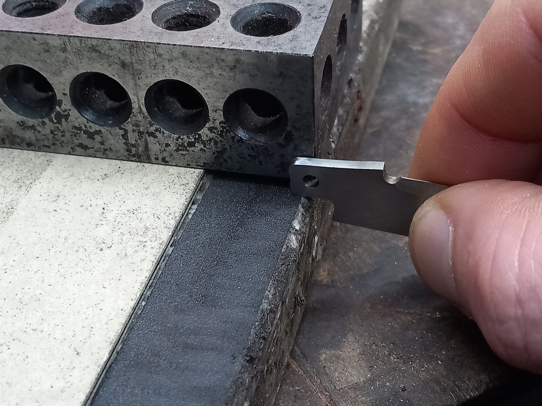

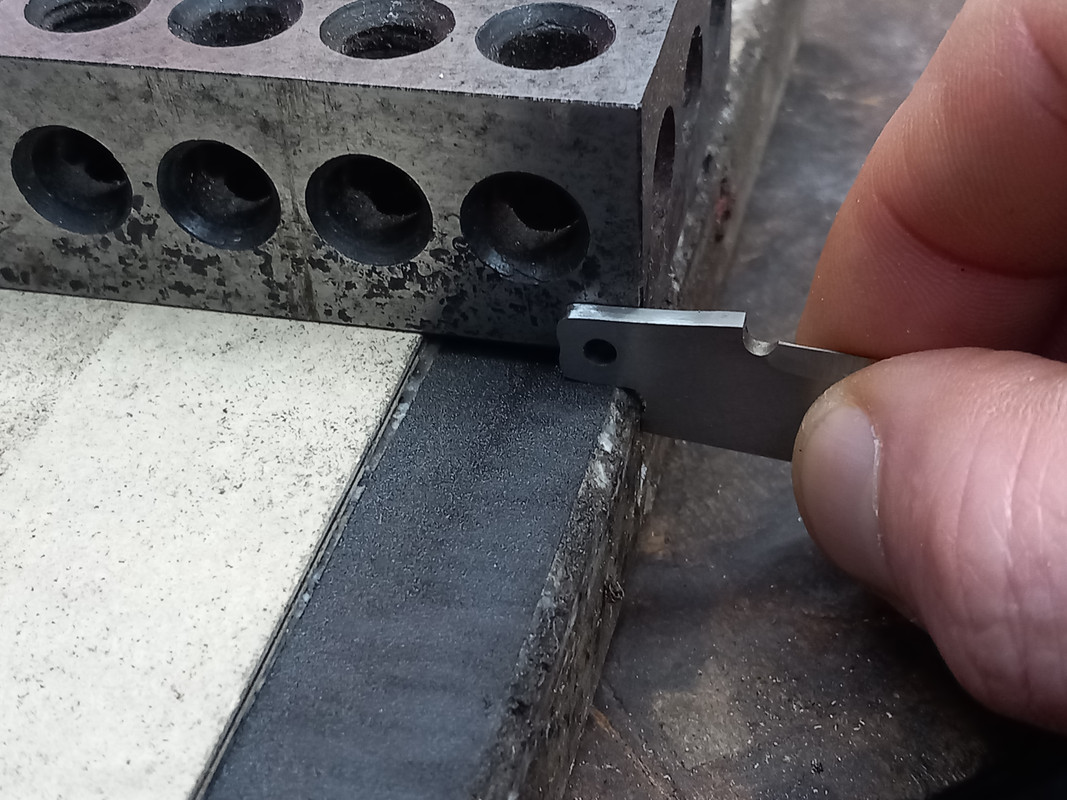

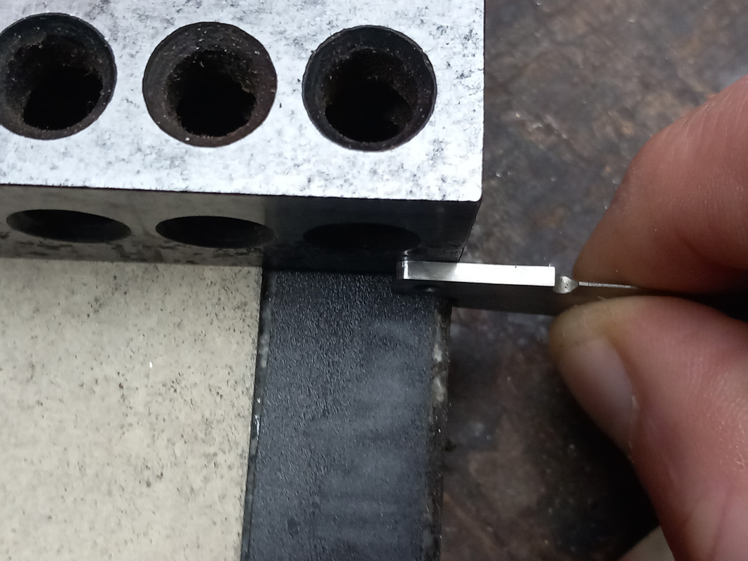

First, this is my set up to sand the tang or spring and keep it square.
I have sandpaper glued on a granite surface and a 123-block on a flat piece of material so it hovers above the sandpaper.

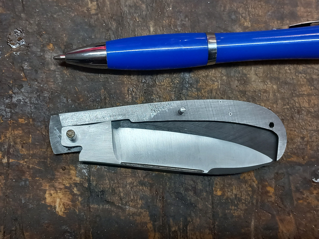

These are the three knives.
The middle one has a 7mm washer, the bottom one has an 8mm one

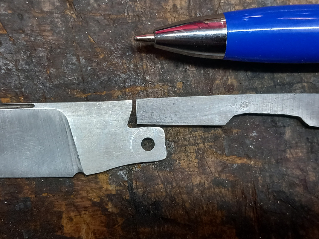

Knife 1
8mm washer
Knife 2
7mm washer
I tried a scotchbrite belt on the spring because that is what I have at the moment. I thing that is why the wear on the spring isn't in the middle.

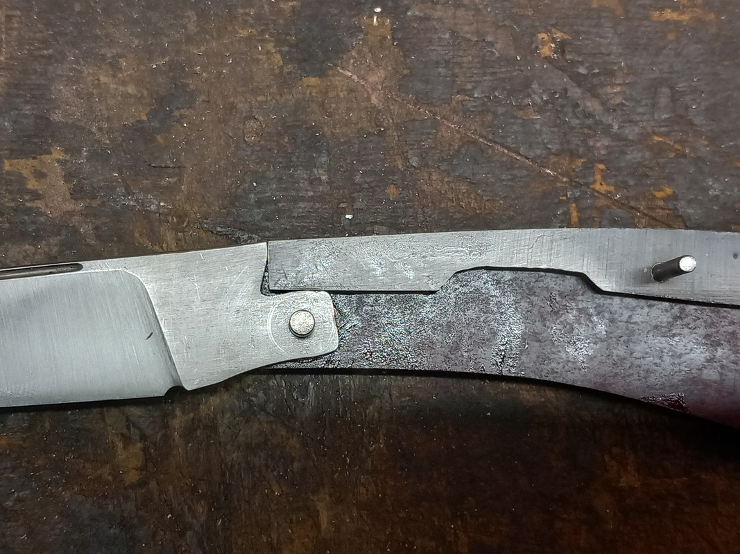

Knife 3
Thank you so much for the great set of pictures! It helps me get a clearer view of your processes and methods.
Let me digest these for a bit. I will edit a few with arrows pointing out a few fitting areas. I will get some pictures uploaded of some of my tangs and springs and hopefully we can figure out what is going on.
It maybe later tonight or tomorrow before I get back, thank you for your patience!
One of the things you did not touch on was how much pre-load of the backspring and what amount of pull you shoot for in a finish knife on that scale of 1 to 10.
It may be just the camera angle, but Knives #1 and #3 look like they have too much torque point pressure on the backspring. Perhaps more and smoother radius on the corner would help. The spring also looks very stiff.
Also, #3 looks like you should lower the angle of the kick/tang frront so the blade drops a little lower in the liners. I have done what you have and after a year or so of re-sharpening the tip was proud of the liners. I had to take it apart and lower the kick angle to drop the blade back inside the liners. Would have been better to do it right the first time.
I also think the amount of galling on #1 and #3 is due to too soft a spring. I don't recall my exact spring hardness, but IIRC, it was 49-50 for the spring and 59-60 for the blade.
Don't take the above as a fact without folks like Ken chiming i because, I don't make all that many folders anymore, so I may be seeing this wrong.
