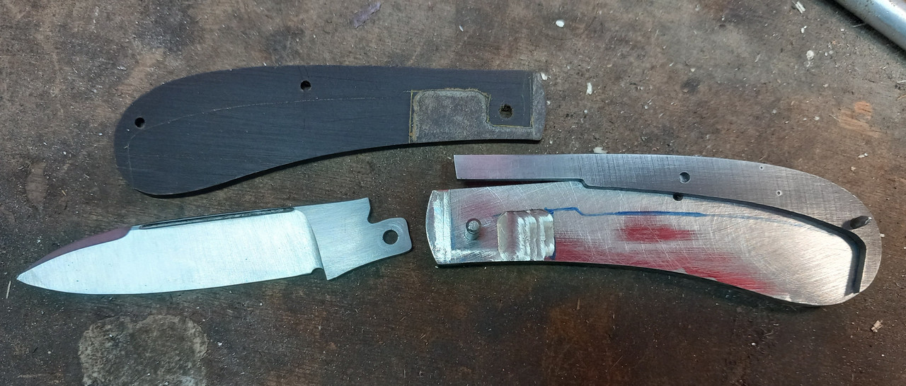

"Ditch the 420 and use RWL34 for the spring as well" pushed me out of my comfort zone and stimulated me to try relieving the liners with the pantograph mill I have. I think I can do without the washers, and use RWL34 for the spring and blade like this.
I still run into a problem with the stainless liner material I use. I ordered "ground to 240grit on one side" and assumed that it would be flat.
It comes from a large roll and tends to not be flat.
I ordered 1mm.
Should ordering 1,5mm and grinding it back to 1mm myself give good flat liner material?
My pantograph milling machine is not heavy enough to mill thick stock back to liners with integral bolster.
(I tried that and it seriously overheated)

I now use RWL34 for both the blade and spring. I have the springs no softer then 47 HRC and I finish the tang of the blade at 400grit and the face of the spring at 240grit with lithium grease on it.
I also make sure that the rise of the spring between open and half is simular to half to closed.
