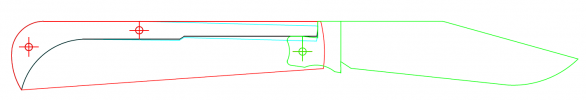

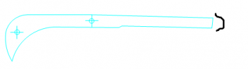

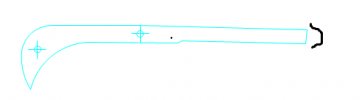

First off I want to explain how I set my spring tension. If we are not clear on this the rest of this tutorial will be unnecessarily confusing. I have 2 versions of the spring in my cad file. one version represents how the spring will look when installed in the knife in its final form. this is how I set my open, close and half stop positions. If you were to cut out that spring and install it in the knife it would put no downward force on the blade tang. There would be no tension, just two pieces of metal against one another. Your blade will not be secure in any position and the knife is not functional. The other spring (blue spring on the cad file) extends into the blade tang. If you can picture this piece being installed in the knife it would be applying a downward pressure on the tang in all 3 positions. When properly heat treated this is what provides your spring tension.
The back half of both versions of the spring are identical and overlap each other. I hope this is clear. If anyone is at all confused on this let me know. the rest of the build is dependant on this being done correct. All of the resources I have recommended have accomplished this in different ways. This is something I came up with and if one of the other ways makes more sense to you then feel free to deviate. Just make sure you understand how it will affect the build later on. I like this way because it gives me a repeatable process. My tension has been set at 1/16" (meaning my spring extends into the tang 1/16") as per Don Robinsons book. I just accomplished it a different way. This method also allows me to accurately lay out all my holes in advance.

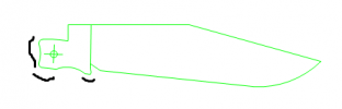

When shaping the pieces it is important to leave material in a few areas. certain dimensions are not finalized until after the heat treat. I will do my best to show these areas and explain why its important to leave some meat on the bone there.

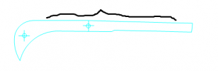

The first area to leave some space is on the top of the spring.
If you grind this flush to the line, when the spring tension is applied you will have a dip right around the center hole. This this will be set perfectly flush after the knife is assembled during the final fit up. It does not need to be pretty at this time.
area number two is the front of the spring. if you grind this to the line you run the risk of not being able to set the blade how you want. As you remove material the blade tip will sit higher and higher in the open position. Better to leave it long and fine tune it later. when you first assemble the knife expect the blade to be canted down in the open position. This is normal. It will be corrected later. You can always shorten the spring but you cant make it any longer. So far I have thrown away 2 knives as a result of this. Be smarter than me.
All other parts of the spring can be ground to final dimension. Be careful not to overshoot any lines.
Onto the blade
It is important to leave some material at the kick and the half stop. in order to set the closed position and half stop properly you will need some material to work with later. It is ok to cut in the radius at both positions but do not grind to the line on either position where the actual contact points are.
It is perfectly fine to leave the surfaces flat and grind the radius in later. (this is what I normally do) Now you can grind all other parts of the blade to the final dimension. At this point I use a small triangular file to cut in the sharpening notch. There is a little more filing to be done on the blade. You need to file in a small gap between the bottom of the spring and the top of the blade in front of the pivot.
This does 2 things. It provides a small space for pocket lint and debris as well as helps with a secure open position. You only want spring tension being applied to the portion of the tang behind the pivot. this forces the blade up and allows the back of the blade to contact the front face of the spring. if the blade is contacting the bottom of the spring in front of the pivot it can create blade play or rocking in the open position. Its best to have 2 defined points of contact to avoid this. this is also the reason for having the radius at the half stop and closed positions. you may have noticed a slight relief cut into the bottom of the face of the spring. This can be ignored for now.
Now surface grind the blade and spring as a pair. They must be the exact same thickness. Then your pretty much ready to heat treat.
