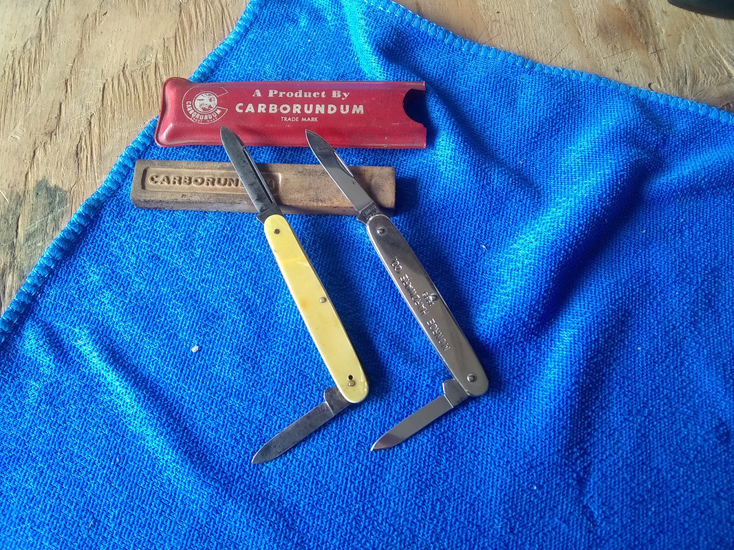

Definitely nothing fancy here, but my amateur sharpening would be wasted on much else. :p I do need a good strop so if anyone has recommendations please PM me. :cool:

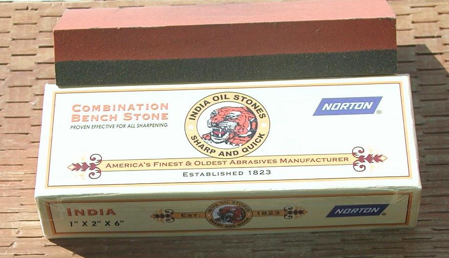

Their next worry is what to use to sharpen their knives. I have been hand sharpening for years and have settled on stones mostly like the ones show in the picture below. Norton India coarse/fine, aluminum oxide stones and Arkansas stones. One other stone that I also use is a Norton Crystolon stone shown in the second picture.

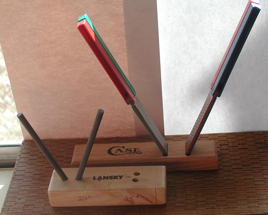

Perhaps one of the easiest ways to get into sharpening is to use a simple rod system. Most of these systems have predrilled holes or slots to hold various rods and sharpeners at a consistent angle. Here are two systems that I have. The Lansky system holds rods at 20º and 25º while the slots of the Case system hold a sharpener at 20º. Both systems are very easy to use. Just follow the directions that come with the systems. A plus for the Case system is that you can use diamond stones from various manufactures. A heads up - you may need to lightly and carefully sand the holes or slots to fit the rods or sharpeners to their holders.

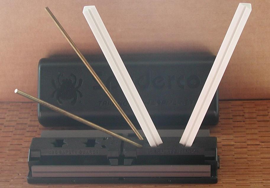

EDIT: Adding this picture of a Spyderco Sharpmake to say it would be a great addition as a "rod syster" but it is perhaps a bit expensive for just starting out. As stated below, the Lansky rod system next to the Sharpmaker will do just fine to get a beginner started.
OK!! This has been kinda clumsily written but I hope this helps some of you guys. I think the easiest way for a new sharpener to get some sort of satisfaction when they first start sharpening is to use a round-rod system such as the Lansky system shown above.

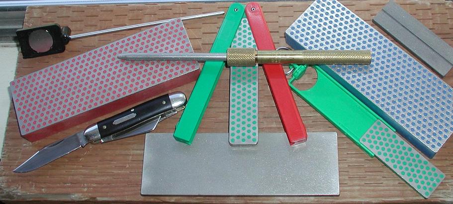

Of course everyone can start out using diamond sharpeners but those are a bit expensive for someone just starting out sharpening knives. Here are a few of the simpler diamond sharpeners to use.
