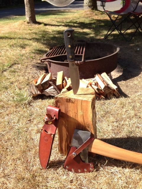

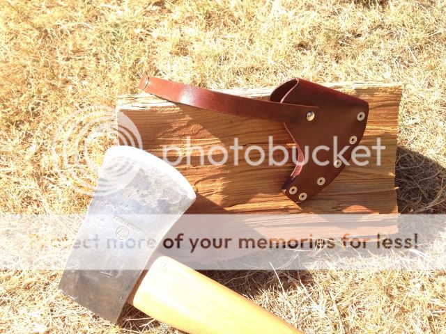

Hi Gary, thanks for all the info you give on this site, you actually inspired me to make a sheath for my dad's old GB 2 1/4lb axe I found rusting away. I cleaned her up, hung a handle on her, and finally made this sheath:
Water based dye turned out pretty good, next I will learn how th stitch, this was a very cool project.
Thanks again!
