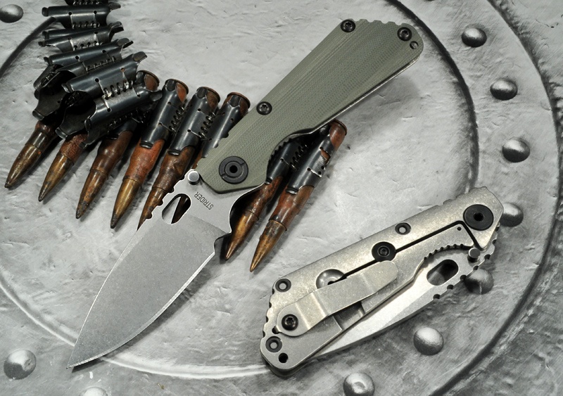

After looking at specs, reading and watching a few reviews on both these knives I can't help but think these two knives are comparably equally robust. Considerable price difference between these two knives. I like the aesthetics of both knives. I've handled both. Any thoughts on this? Bias aside, please. ;)

Due to the way the thumb stud on the Strider rests on the handle, it probably has more strength for lateral stress. I don't know if Rick Hinderer invented that, but you'll see the same thing on the XM-18. My understanding is that transfers lateral stress longitudinally down the handle slabs, taking pressure off of the pivot.
I certainly don't use it as a thumb stud on mine, just a blade stop. I've tried and I'm not strong enough to open it using the studs, there kinda sharp on the edges too. The hole is definitely the better way to open them imo.
Thumb stud? Thumb hole? I'll go with the thumbstuds actually being blade stops here.
I thought the "thumb stud" was just a blade stop?
The thumb stud is a blade stop (though it's not meant to be used to open the blade). The hole is meant for opening the knife. But anytime you see the blade stop attached to the blade like that as opposed to the blade stop being in between the handles like on the Rift, it provides more support for lateral stress on top of what the normal blade stops do. Some knives that have this type of blade stop:

The lugs are the blade stop, NOT thumb studs/lugs. The knife is designed to be opened with the hole.
No doubt the rift is a nice knife, but inferior to the Strider for heavy use, build, blade steel, etc., etc. Two different classes of knife.

The pins are blade stops, and on the SnG only make contact on the Ti side. Strider grinds away just enough G10 so the pin does not make contact there. It by no means affects the sturdiness of the knife. My SnG locks as tight as the day I got it.
Now that mine is broken in, I use the pins to open the blade the rest of the way after starting the process with the hole. The blade deployment speed you can develop after practicing is incredible.
When I show the knife to people and open it they think I have an auto. Once I convince them otherwise, they try to open as fast as me and can't even get close.

That's because from what I've read, the SnG's stop pin was never intended as a thumb stud. It was designed to be opened with the hole. The Hinderer on the other hand was designed so that the thumb stud was the stop pin. Hence, no opening hole on the XM-18.
To say a SNG does not have thumb studs is silly, they do and they work well. In fact, I bet the opening arc from the studs is about the same on a XM vs a SNG.
