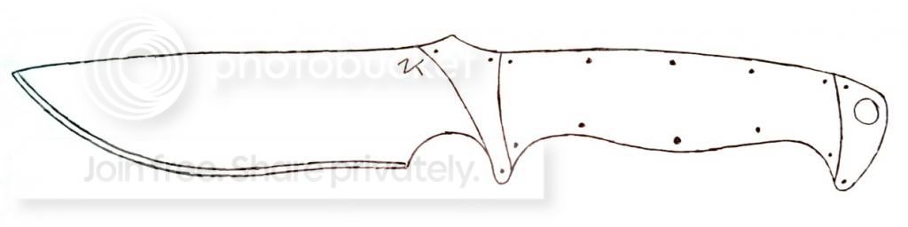

So after hours and hours of work... I have a drawing... whatcha guys think?
May 4, 2010
382
I like it. 4.5" blade length.
I was thinking flat ground with a 30* micro bevel. Nickel bolsters and pins. Black paper micarta. All polished up with a nice fat leather sheath and a silver lanyard bead.
Don't know what steel to use though.
Thoughts?
I like it, though with that style and maker's mark, if I had just seen it on a shelf somewhere, I'd think it was a zero tolerance.
Nice flow, good looking knife. Is there a rear bolster? Or is that an exposed tang? If exposed, that thin bit of handle material hanging down could break off easily with use.

I like it Zach. Maybe some 5/32" x 1.5, finish around 9 1/2", With the nickel maybe some SS, lots of of good choices out there in that regards, i like good ol ATS-34, the 154 sreies is nice as well, not to hard on the wallet and tools and finishes nicely!

It will have bolsters front and rear.

I'd be careful about the pins being too close to the outside edges
Thank you, will look at pin placement whenever I get around to building this.
Looks good! I would want that blade in Elmax.

The shape and design look good, with the exception of the pins being a bit close to the edge.
It isn't a simple build with the shape of the bolsters and such. It is a lot easier to shape and change things with pencil, paper, and an eraser than to do it in metal with tools and abrasives :)

Do you have a middle name?
Is Zach Tate Knives (ZTK) out of the question?
Also cool to overlay them directly.... but a little harder to discern. Not exactly Google friendly
Fortunately, you have a relatively short name that you can take advantage of. You should be able to quite easily fit "TATE" or even Z. TATE anywhere on the blade.
I too have a similar first/last initial mark:
but I also always include "A. Riley" as well as the steel type on all my blades as well.
only reason i thought you might need a custom stamp is it might be a bit hard to get them lined up every time... the T & K can fit into each other for alignment... but the T on the Z would be hard... but you're free to use it... or modify it to your liking... obviously... just an idea...

Blade shape looks very functional Zach, great design... not a fan of the bolsters but thats personal preference.
