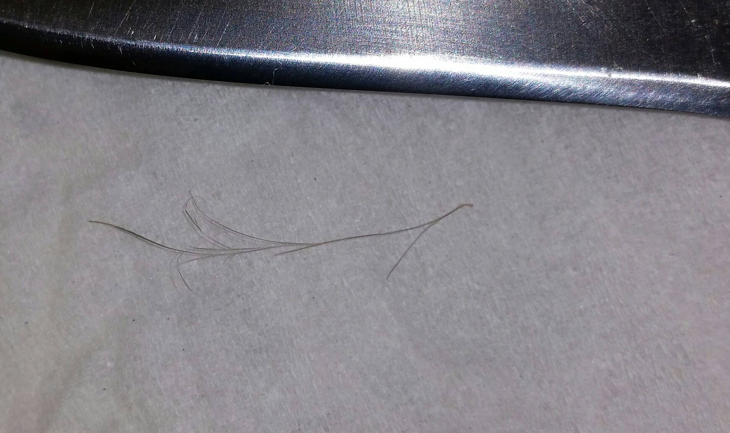

For the record, one can still get a hair whittling edge on the WSKO.
The WE is an great system but its not the holy grail. Like all things in life its the user not the tool.
I very much agree. I've put edges that would tree-top hair on a bunch of blades with nothing more than a few different grits of sandpaper and a mousepad. If you know what you're doing and have your technique down, you don't need anything fancy to get a sharp edge.

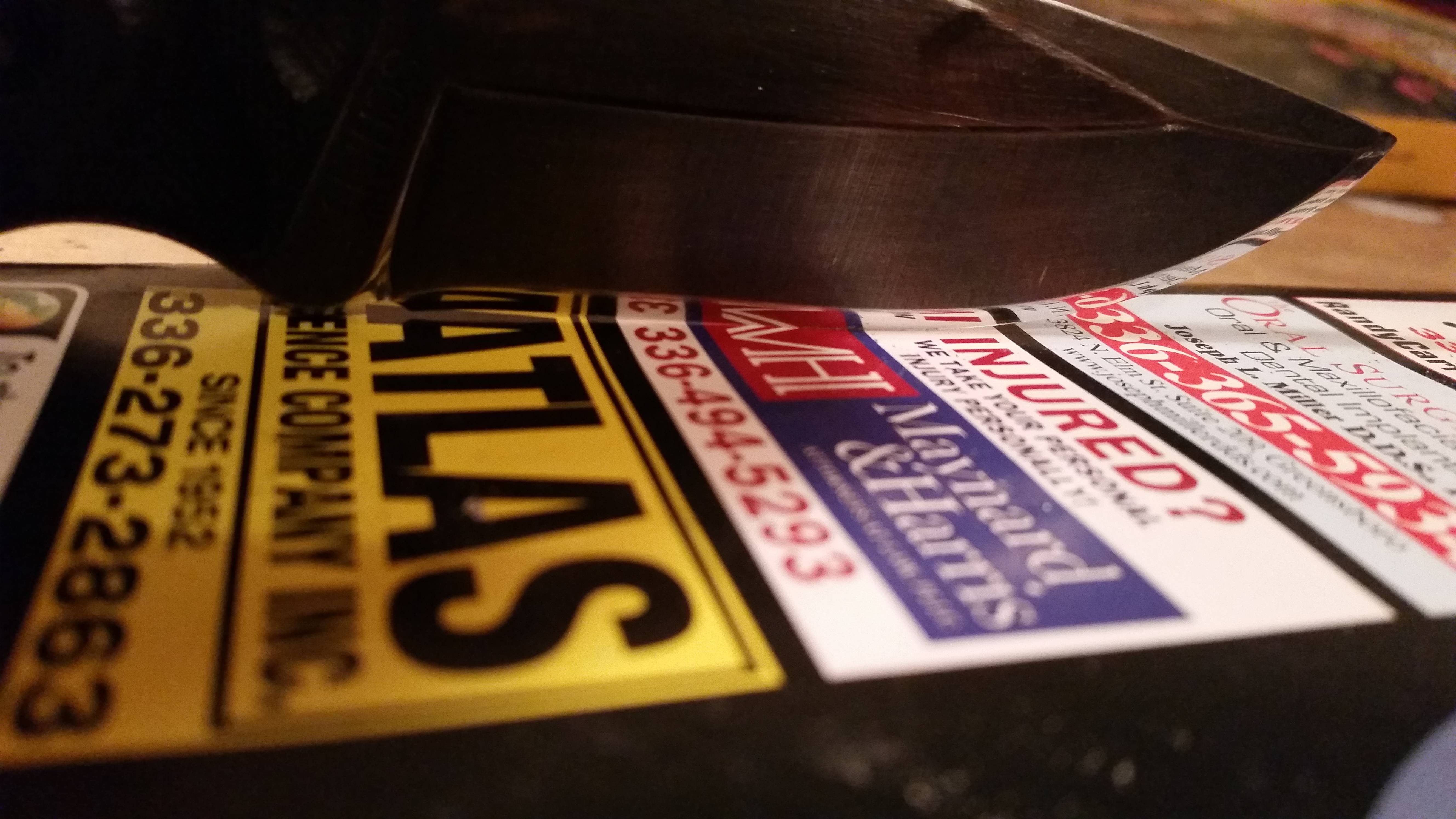

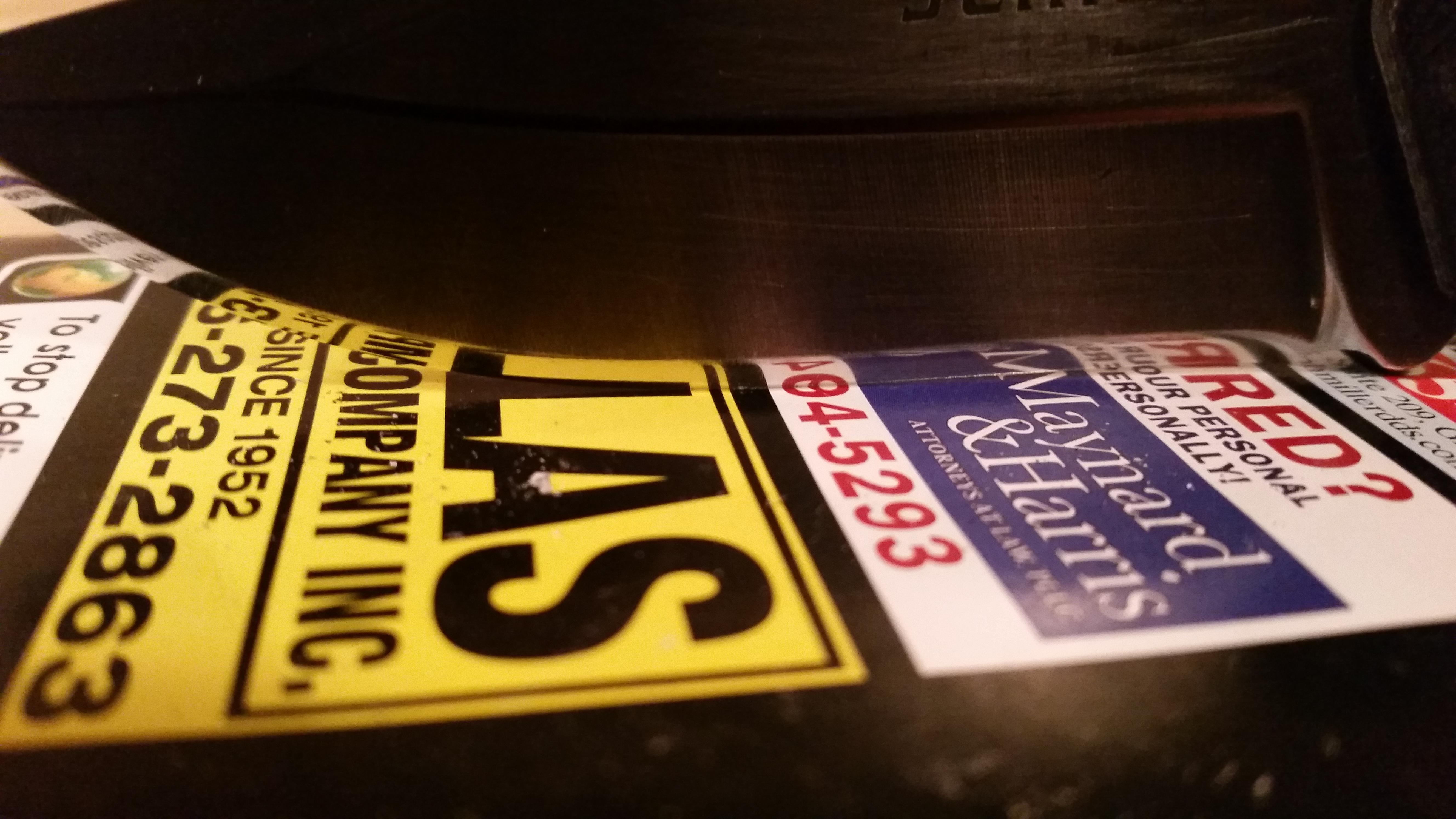

Here's the typical results I get with ko grinding attachment.
I get even better results when I take my time.
Does it round the tip? That's something that drives me nuts.
