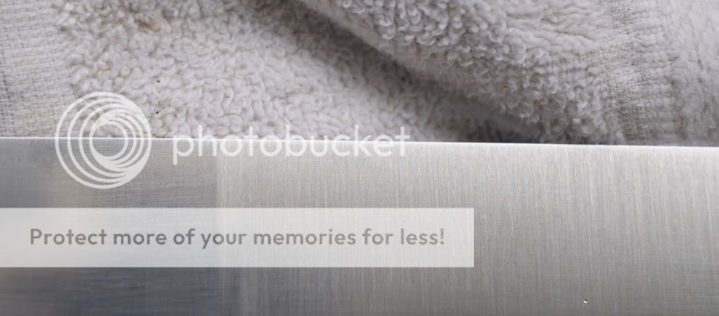

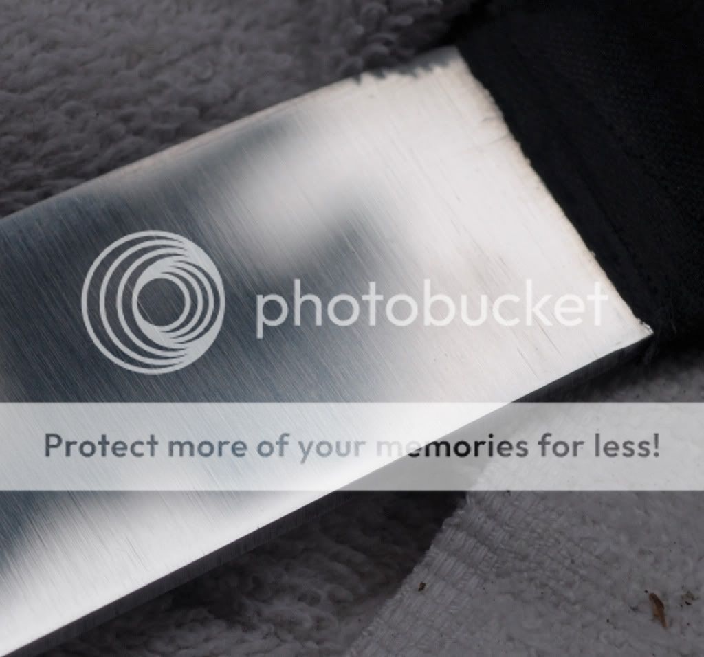

230 - I just went down to the basement and tried two different things for you.
I did 320 cork alone and 320 cork followed by plain cork with green compound.
Here you can see the difference (the marks running lengthwise are just from wiping the blade down)
Here is a little closer for just 320:
This was a quick and dirty attempt to give you an idea.
Here is what i came up with quickly going from 180-600 (not removing all previous grit scratches):
Not saying this is how to do it or anything because I don't think it is really the best way. Just the most recent thing I have been trying out.

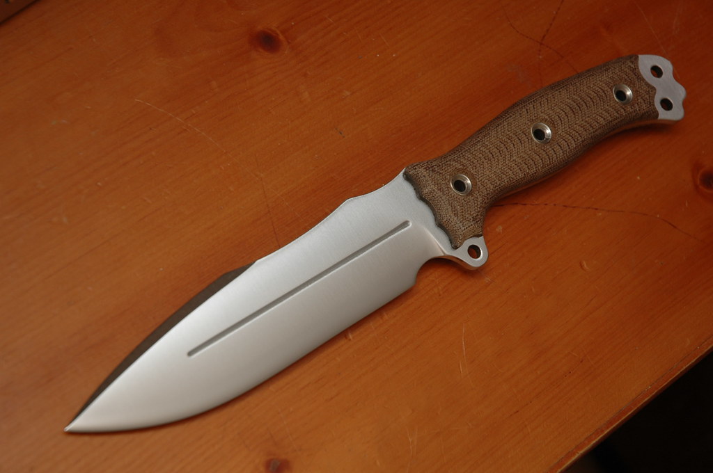

Cool! I have always wanted to send one of my Busse's to Ban. I think his work is amazing. Almost out of this world.
Well it isn't Ban, but from the pics of the satin AK norcal did, I feel like i'm in good hands.
Honestly, lesson learned, buy satin if you want satin. I'm pretty sure Norcal is hooking me up real good because he was pitying me. It's like seeing a kid at an icecream shop soooo excited about his triple stacked cone, only to see it fall on the floor. Everyone would want to buy him a new cone. :D
Oh I am not saying you made the wrong choice. I just like that "frosted" finish Ban does.
Yeah, he seems to do the same as well. Hope he doesn't mind me posting his work, i'm pretty sure he posted them here before.

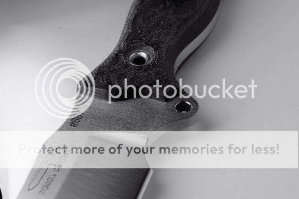

How do the "handles get pulled" without damaging them? Just curious about the process =D
You have to drill one side with a 1/4" drill then carefully tap the tubing out with a pin punch.
don't try and drill all the way thru you will only make the holes oval.
WARNING The knife should be clamped down before you try drilling.
