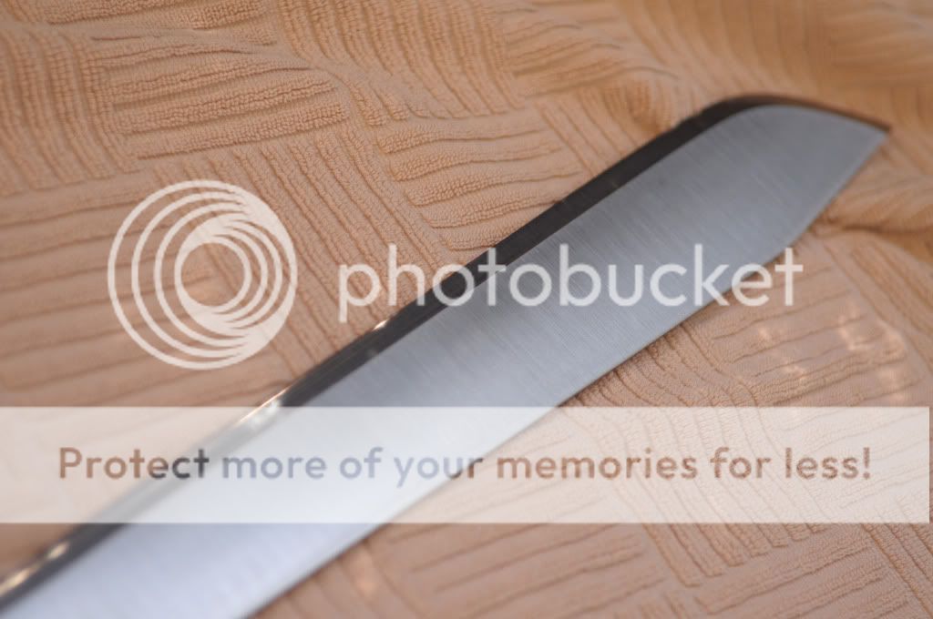

So I started stripping my knife
Heres a quick pic of my WAKI
You should see them in person. They look so much better and actually aren't as abrasive looking. Pictures really dont do them justice. The frosty satin is by far the best finish I have seen.
Many moons ago, I took an old old bolo machete - circa 1918 or so - and decided to give it a better finish. It was rusted and someone TRIED to sand it out - with a disk - at one point.
I started with some aggressive sandpaper. Then I went perpendicular and didn't stop until THOSE scratches were gone. Then the other way with the next grit, and so on.
It came out pretty good. Now that I understand how to put on a convex edge, I'm gonna finally sharpen it up. The handle looks like crap - I'd have to take it apart to get teh guard and handle up to par - but I don't care. The blade looks like something from Horton or Ban. When I get it sharpened, I'll have ot post it.
So what I'm saying is: Restart at 100. Take your time. It will come out.

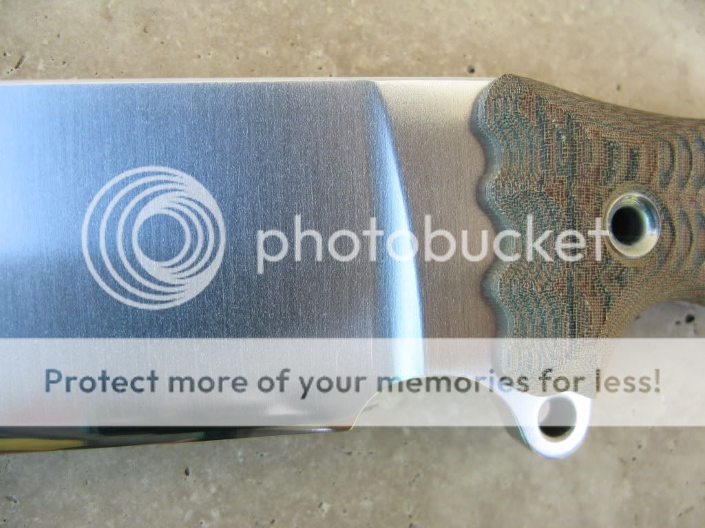

Do you have the HF 1x30? Lots of folks use that to put a working satin on their knives. Check out some of Horn Dog's work. (He has since upgraded to a better grinder) I've done a SAR5, Waki, and NMFBM. Gots pics of the first two. You can do even better than these with a little more work and patience.
http://www.bladeforums.com/forums/showthread.php?t=552042
http://www.bladeforums.com/forums/showthread.php?t=663363
