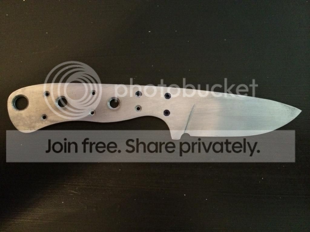

So, I want to build a knife!

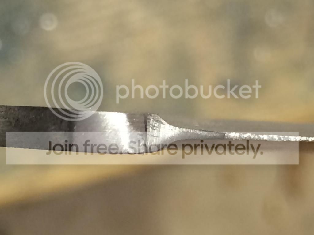

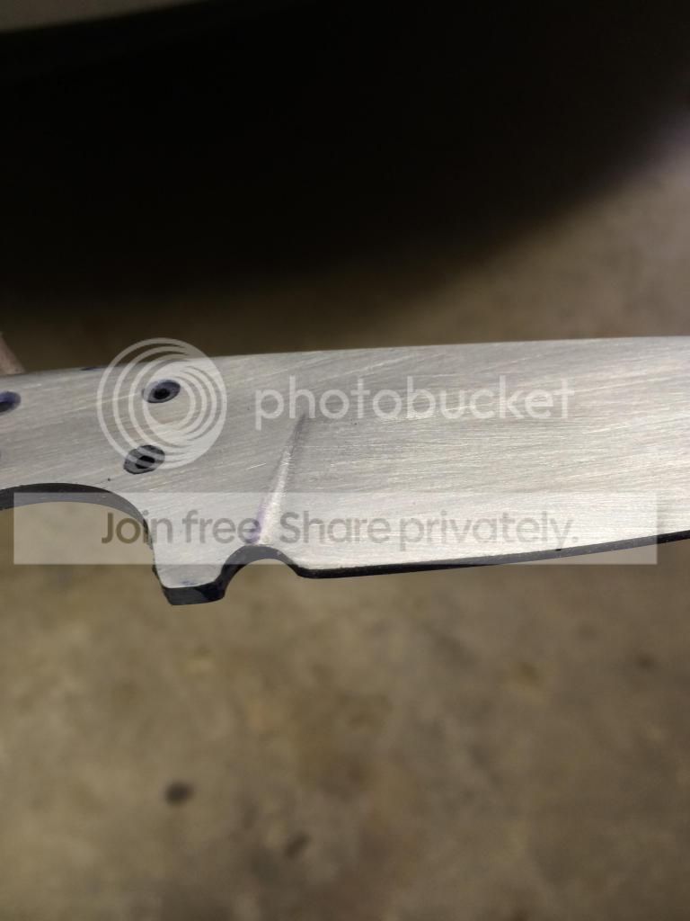

As long as the intersection of the bevel and ricasso isn't a perfect 90, you are fine. The idea is perfect 90's provide a spot for stress risers to stat during the quench. I do round plunges with either a chainsaw file or a very small detail round file.
This is what my plunges look like...

i make the plunge first, but not to final depth. make it almost as deep as it needs to be then make the bevel. when i go near the end i would work on both at the same time making sure to keep the file slips to a minimum.

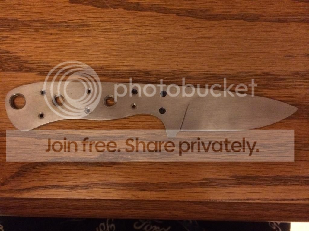

I worked on it some and quickly realized that I'm chasing the plunge line back the ricasso which wasn't something i really wanted to do. Im happy for the most part with it now. Although not exactly centered on the notch, Its not squared off at 90* like it was before. Its much more rounded. After the files, I hand sanded it some with 100 grit, and i think it will be ok. There are a few deeper file marks by the plunge. My hope is with some determined sanding, they will eventually come out. Now to file the other side the same and make it appear even.
Eric, do you do your plunges by hand or with machine? Whats the thickness of the stock? Looks more like 1/4"? What grit did you sand up to? I assume that is a hand finish, and not machine. Hope you don't mind the questions, It Looks great, and thanks for all the help!

The rounded cut of the plunge is actually a good thing. 90° angled plunges can become a stress riser.

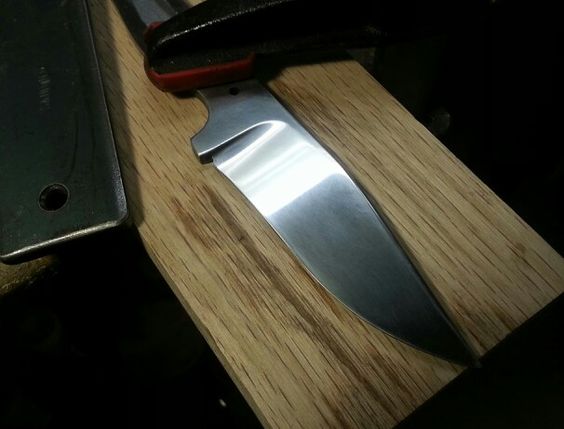

It is 5/32" stock on that one. I like a very shallow angle and a full flat grind for a slicey dicey blade. Less material following the edge through the material. I do mu plunges with the grinder initially, then I clean them up by hand. I like the same shape you have there. Like Stacy pointed out, I find that a nice curve like that reduces stress fractures induced by quenching. Any sharp 90 degree will give the blade a place to start little stress fractures.
I use the edge of my flat platen to initally cut the plunge. It has a tight radius on it that basically produces that plunge. I cut in with the belt squared up. Then once I am near where I want the plunge to be, I run the belt just off the edge of the platen and do a cut to get that radius... A file helps to make sure it is exactly where and what I want. Yours looks great IMHO.
My first several blades I cut my plunge solely by hand. Using the edge of the platen and pushing the belt over the edge is something that takes practice. Its very quick and can fubar a plunge in a hurry if its a little off. I have several diameter round files, thus allowing me to get the radius I want.
Yes, that was a hand finish, but I go to at least 600-800 grit on the belts. From there, its all hand finish with blocks. I go up to 800 prior to HT, cuts down on scale. In that photo it is post HT and being worked to 2000 before etching.
There was a thread a couple of days ago about final sanding. I dug up Nick Wheelers old tutorial on it and posted the link. That is exactly the final sanding method I use. Try to get your deeper scratches all gone prior to HT. It will be easier that way. Also leaves a place for scale to grab on...

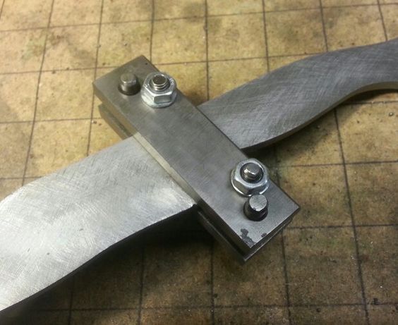

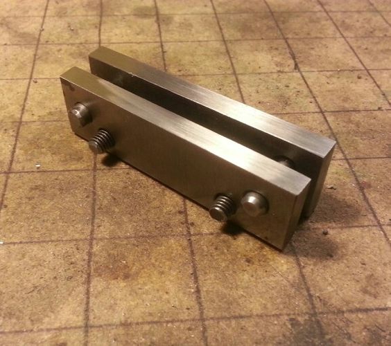

Incidentally, use of a file guide helps a ton. I used to do everything by hand, but decided to finally start using a file guide....
I made mine out of 5160. Easy enough to make. The pins are drilled to exact size, then welded from the bottom side and ground flush. Thd threaded portion is drilled oversize a bit and thread rod welded and smoothed also. Once all fitted up, I ground the edges dead flat together on the disk and smoothed on the flat platen vertically. HT of the 5160 after flush grinding obviously.

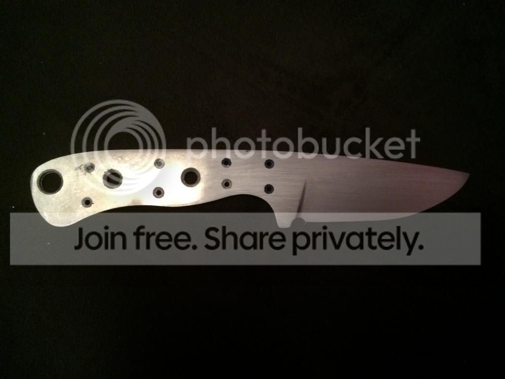

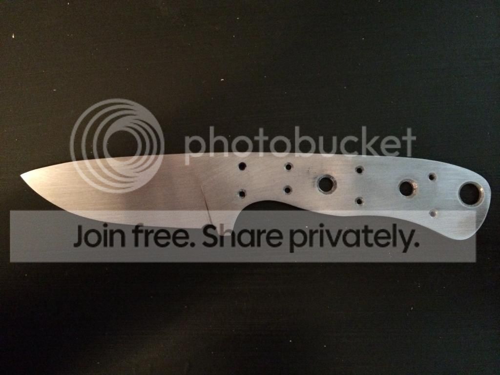

I got a chance to work on the other side this morning. My plunge is not perfectly even from side to side, but I'm not sure i have the skill set to get it any closer.
After many attempts, this is the best picture i could get:
Where i am right now after sanding up to 220 grit.
I guess I'm going to have to contact peters heat treat and see what is the minimum width edge for 1095 before the heat treat process. I started sanding with 100 grit at .020-.025 edge thickness. When i got done, i realized that the edge was now between .013 at the thickest spot, and .010
I see why this hobby becomes addicting. Perfection is right there waving at you, taunting you, and jumping out of your grasp every time you get close.
Looking really good for any knife, especially a first knife...A file guide would help the plunges, but they don't look bad..
I HT a lot of 1095 and about a dime width (.025ish) is all I'm comfortable with. Peters may be fine with thinner as they are practiced with it.

it appears that .015" is the safest minimum edge thickness Peters wants to harden. I took the edge back to .020 because i still have one scratch left to sand out, so it i assume it will be thiner before i send it out to get hardened. Although it looks different from my original drawing, i like it, even without the notch.
