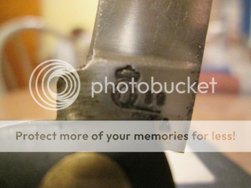

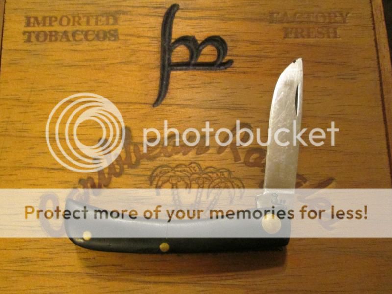

All this Queen talk forced me to (really) go to a local dealer and get a used Country Cousin (good price, cracked scales). The tang stamp says "89" I assume means 1989 manufacture. Anyone know if this is D2?

They didn't start using D2 until 2002, so if that tang stamp means 1989, then no, it's not D2. Judging by the lack of patina, unless you buffed it, I'm guessing that's some variety of stainless? I assume the black stuff on the blade is just grunge.
http://www.queencutlery.com/1989.php
http://www.queencutlery.com/uploads/Model_70__7-12-2014.pdf
Thanks, I was thinking it might be stainless. I think it is rust (which stainless can do) down in the stamp but other than that, no. I wonder what stainless they used.
Thanks for the PDF

From what I could dig up, it is probably "Queen Steel" which was their name for a proprietary blend of 440A. Information stolen from this thread: http://www.allaboutpocketknives.com/knife_forum/viewtopic.php?f=61&t=16492, from Steve Pfeiffer, who has already posted in this thread.
Yeah my guess would be that the 1989 Country Cousin knife would be 440A. I think it was later maybe late 90's to 2000's that they switched their basic stainless to 420HC.
And as far as I know all D2 knives (as JC pointed out started in 2002) have the tang stamp that includes "PH-D2" which stands for Peters Heat Treat (company in PA that does their heat treat).
