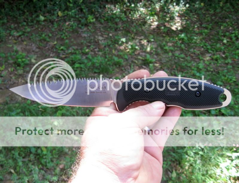

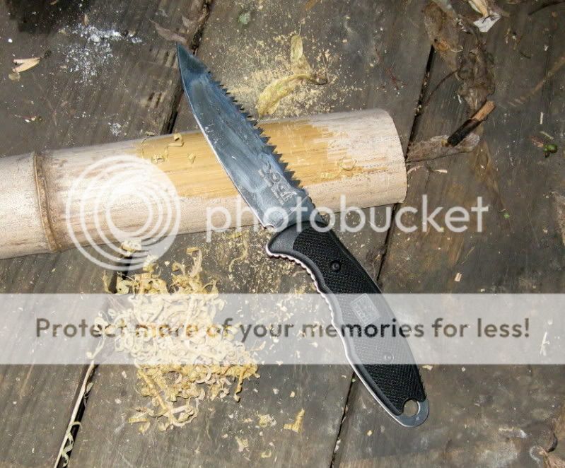

Well, I finally get a chance to check out a full tang SOG. It's not shaped anything like my old SOG Bowie but it seems to be a good solid design.
It's the Team Leader Survivor. It has a satin finished 5" blade and is 10.25" over-all. It is made from AUS8 and is 5/32" thick. The saw spine is viciously sharp.
I found something about it particularly interesting.

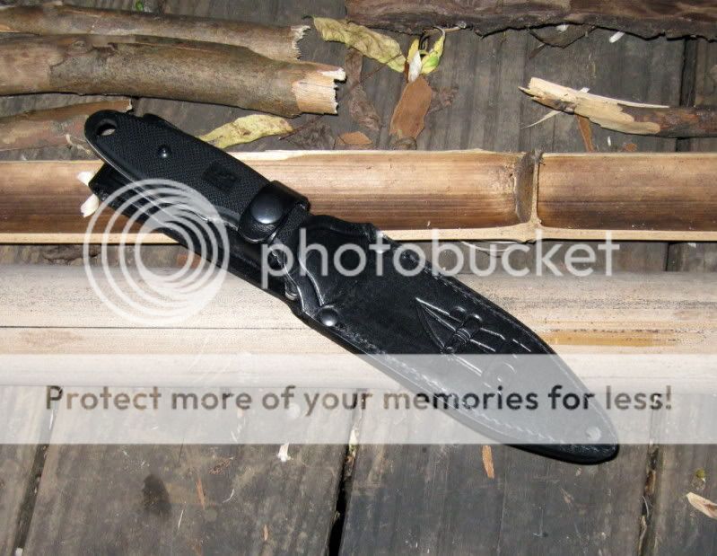

It comes in an ambidextrous leather sheath.

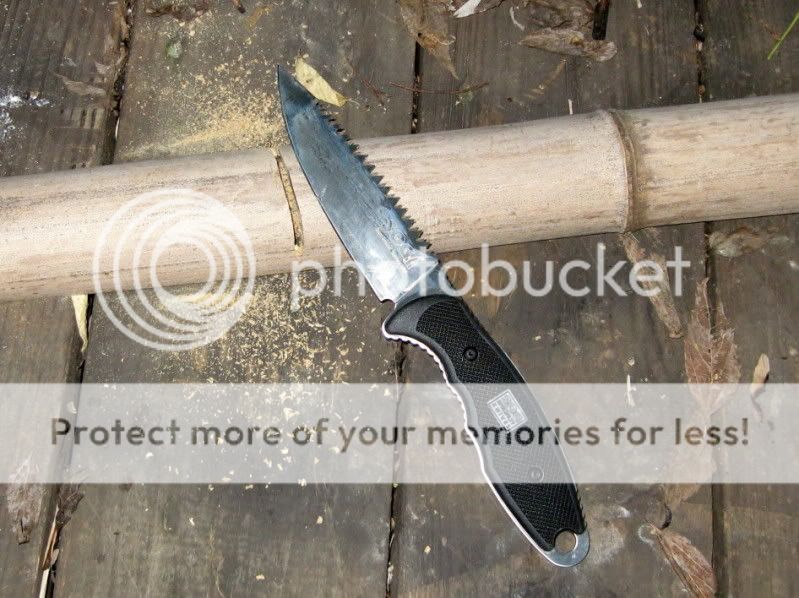

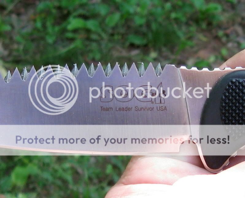

The flat grind works well with the saw spine as that means that the very tips of the saw points are the widest point of the saw so it doesn't create as much friction as a lot of saw spines. It made this cut in some dried bamboo in about 20 seconds.
The edge did really well at making bamboo shavings for tinder, and still shaved but you'll have to just take my word for that for the moment...it was a really blustery day.

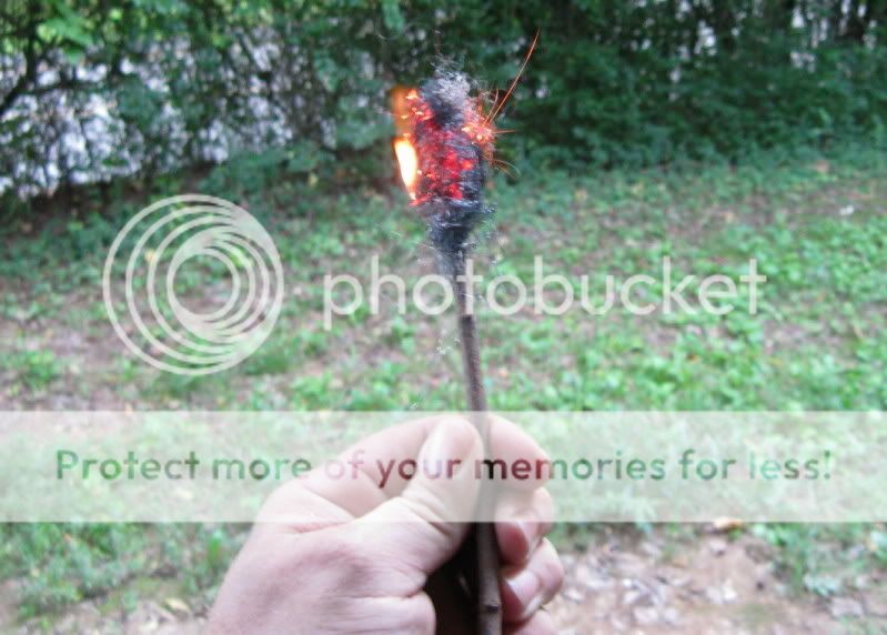

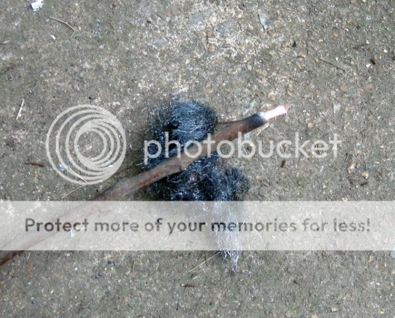

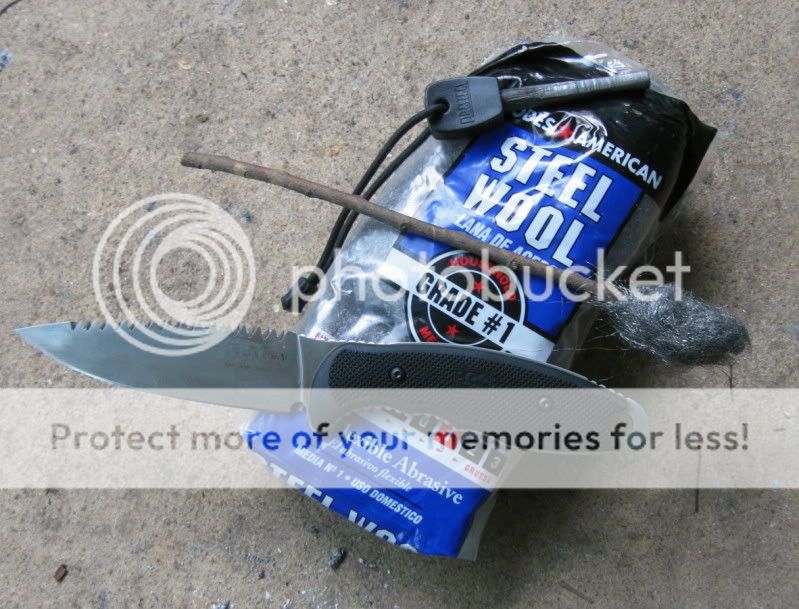

I tried it with the firesteel to see if i could get sparks with the spine between the tip and and the first saw teeth.I ignited some steel wool very quickly as it through very good sparks with no damage to the blade at all.

Nice review, mistwalker. I have the same knife, but in 440C. I haven't had a chance to really put it thought its paces yet, but what little I've used it around the house it seems like a decent piece. I found the sheath to be utter garbage, however, and am fixing on making a kydex sheath for it.
Thanks man, I didn't even know they made it of another steel other than the C20V I think it is. This sheath I wouldn't really call garbage as I've seen much worse and I like how they made it so that it would accept a wide belt like a web belt as far as the leather goes. I'm surprised it isn't in a nylon sheath with the pouch on front like the SEAL knives though. A thin kydex sheath would be nice for some applications.
When the Survivor version was first introduced, it was made out of 440C. Perhaps they have improved the sheath a bit, as your sheath looks a little different than the one that came with my knife. My sheath was really dry, and the knife barely fit into it. I called to inquire if there was an alternative sheath, and was told no. I was told that inserting and removing the knife from the sheath repeatedly over time would improve the fitment of the sheath. :rolleyes: The first time I took the knife out of the sheath, I really had to yank hard, and ended up nearly slicing the keeper off. :mad: The saw teeth did, however, remove some excess leather from the sheath during the process, but not enough to improve the fit.
If your sheath works well, I at least feel a little better knowing that SOG changed the original design.
What's it like when you're using the saw?
Those bumps on the top and bottom, just behind the blade (I forget what it's called) look like they'd chew your hands up pretty badly...and the handle material pattern looks like it might add to the misery.
I like their saw pattern, it's just about identical to the one in a SAK.
Good so see somebody putting thought into a knife blade designed around a saw and not: "Okay...blade's done...how do we stick a saw on it?"
