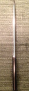

Asking SOLD, via PayPal G&S (I will provide my PayPal email address via private message), which includes expedited shipping, tracking and insurance. First "I'll take it" followed by prompt communication gets priority.
This large knife combines a seax style blade, having in fact a very slight hawkbillesque recurve, with a large barong style handle for a versatile and very secure grip.
The balance point of the knife is about 1 inch past the handle, and the long handle accommodates grip close to the cutting edge for speed and agility, gripping farther back, secured by the pinky hook, for increased chopping power, or anywhere in between for a balance between the two.
It comes in a white .08" Kydex Sheath with paracord set up to accommodate any type of belt carry. This can be modified by the user to attach to a pack, vehcile, or anything else.
I made the blank using 3/16" 1084 from New Jersey Steel Baron, and because my forge is only large enough to handle small blades, I hired celebrated local blacksmith Andy Pomorski, who to date has heat treated all my carbon steel blades larger than 20" overall, and with great results. I had him heat treat and temper this piece for 57-58 HRC.
19 3/4" overall
13" blade
26.5 oz, or 33.4 in the sheath
Coarse Peel Ply G10 handle, carbon fibre tube attachments, accommodates lanyard if desired (though handle design surely doesn't need one!)
This is a very strong, capable and confidence inspiring tool for any woods excursion.
Thanks for looking!
Grip positions
Underside
Spine
Fantastic handle ergos
Knife with sheath
I almost forgot to mention, despite the size of this knife, I also designed the handle and balance so it can actually carve quite comfortably, for example for feather sticking, carving tent pegs, etc, as this picture demonstrates:
Note how much handle sticks out, to provide a counter balance so the blade feels much lighter than it is during such tasks, and also the handle scale design allows the thumb to wrap around the front of the scale, and rest on the ricasso, allowing very secure and comfortable grip to allow extended hard use.
I truly designed and built this knife to be able to do almost everything that needs to be done in the woods. I am extremely excited about it, and, God willing, you can be sure I'll make more versions of this as time goes on.
