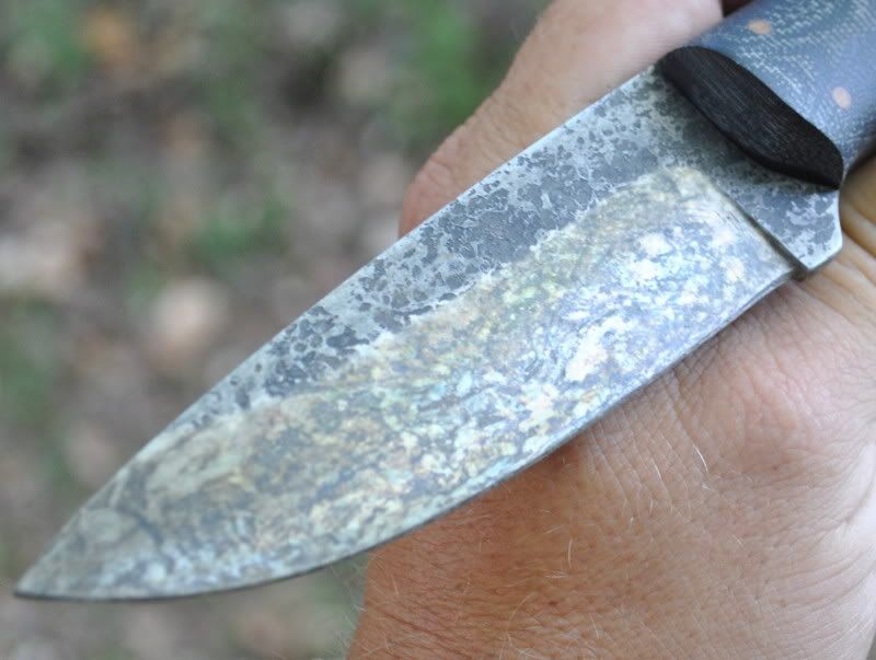

Some Pics Of The New Hunter
Yea I'd say mustard, but I tell you what if you want a good patina on O1 IMO nothing works better than a peach. Just cut a bushel of peaches up and you will have a nice even patina.
One apple works. A watermelon will do it real good too. But mustard is striking as well. How long did you leave it in the fridge Mist? Overnight?

I was going for something that complimented the spalting so I wanted a mottled patina so it was a couple of applications each of garlic juice from freshly sliced garlic and freshly sliced onions that sat on it for a couple of hours each for an even dulling of the surface then three applications of mustard for the mottling and those stayed on for a couple of hours each time. The colors are subtle and don't really show up that well in pics, but doesn't really matter because they won't stay this way anyway. Over time it will just be a mottled pattern of dark and light spots.

Mist, great job! I'm going to give that a try with my hunter. The colors are indeed subtle; this is what my NWA looked like before I decided to speed things along by forcing:

Very Nice Mist,
Enjoy that new blade, it looks like the "spa" worked out real nice, I Love It.
Lovin all those blades and colors up^^^^^ there

Thanks I thought the spa treatment worked out rather well myself. I haven't been doing a lot of forced patinas lately, but I just needed to tone down the reflectivity so I could concentrate more on the subject content in some photos for an article I am working on. That way I don't have so many concerns about lighting and angles and the photography is less complicated.

I liked the old patina too, but the O1 blade would keep rusting in areas that weren't well underway. I decided to force it to give it more uniform protection.

Cool, that's the whole point of the discussions, learning and sharing. Yeah it's easy to do. Normal food prep, just cutting up potatoes, onions, garlic, peppers, and various fruits will work well over time and the more you do the less time it takes. I just sometimes like to do forced patinas, sometimes I do something like zebra stripes other times it mottled patterns. I think it looks sweet now that I got the edge cleaned back up.
