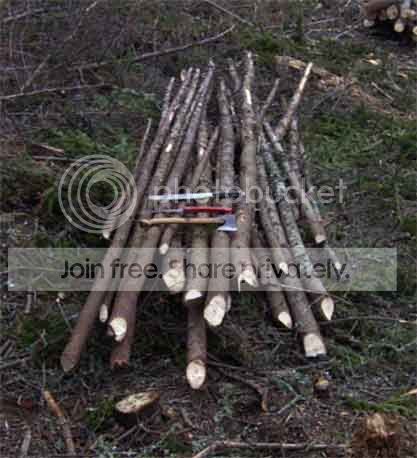

I have a lot of wood working to do, clear a few lots, cut wood for the winter etc., and generally it isn't overly exciting so I usually take some knives and break up the tedium by doing other things. I was mainly interested if the edge on the knife could take harder limbing as I had adjusted it to a fairly thin 8/12 profile :
I did a lot of sloppy work like that and did finally manage to turn the edge just to the point where I was almost positive it was bent. I later confirmed it when I sharpened it as you can see where it is abraded, but it took an extended sesstion of sloppy limbing on really hard work to turn the edge and even then it was very slight. That is the best performance I have seen to date, and this is a large blade and it hits really hard.

If I read you right you put on as thin an edge as you could and went to work ?
It must be good metal to put up with what you put it through .

The edge bevels are really dramatic, the edge is 0.070" thick and 0.25" wide, yeah that isn't a typo, it is eight degrees per side. It was actually this angle origionally for the entire bevel but I found the edge would turn on harder knots in the winter when I was cutting frozen wood and thus the edge retention was low so I increased it to 12 by adding a secondary bevel which sets in at about 0.040" or so. You can't see a distinction in the bevels by eye, I just freehand sharpen it on flat stones and it all blends together.
The origional profile was about 35 degrees included and I kept grinding it down trying to see when it would start to get damaged. It was very difficult to reduce it to eight per side, I was working in the slack above the platen on a belt sander and this angle is so low that you end up grinding the spine as well so there is a big strip of metal removed from the knife there as well. It is much easier to grind on the platen, but back when I modifed it I found it easier to work on the slack section of the belt.
