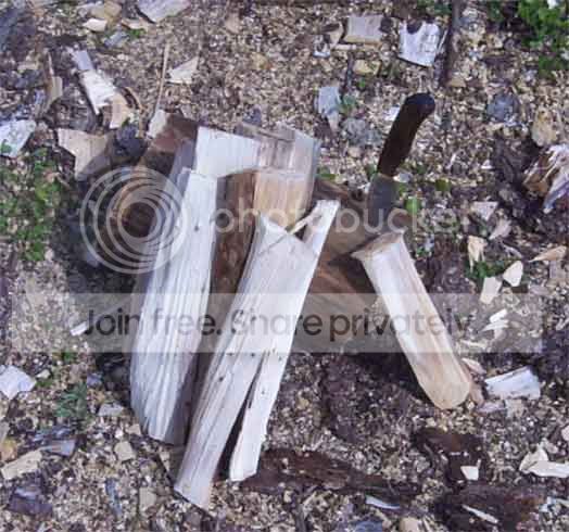

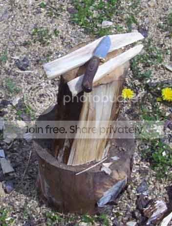

The Blackjack Small I have is similar, a short blade, very thick for its length, but it tapers to a very acute edge so it cuts wood exceptionally well. The thick choil (0.215") also gives it lots of prying ability so you can for example drive the knife into woods and then pry off a slab :
Then with that wedge you are set :

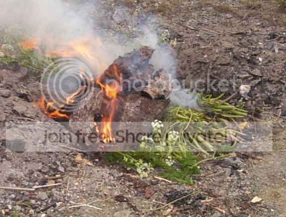

Fire away :
I was showing my nephew some basics of fire building, how to use leafy vegatation to make a smude / shelter from mist and how to rebuild the fire once fuel was gathered. I was burning mainly thick bark as I was cleaning up some wood which had been cut but not seasoned properly (it had been abandoned) and thus it had rot and I had to debark it to get it to dry out efficiently.

Cliff that fire reminds me of the little bomb shaped pots they used to light road hazards with . Do you happen to remember them ? Smudgy flames sooting out of the round cannisters . I would like to do some smudge work myself . The skeeters are the worse I have ever seen them . My back is alive with their poison and I didn,t go out in the woods today .
We are getting some around here now but they never get very bad, however in Labrador the black flies are much more intensive. It is very nice to have a small fire going in the woods however in the summer you have to be exceptionally careful in dry weather and it is insanely dangerous in any wind.
