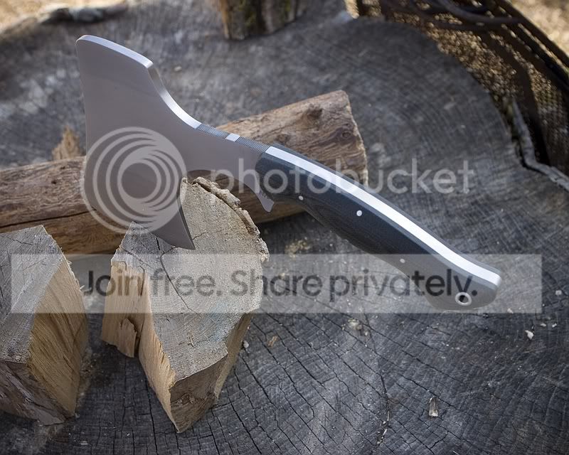

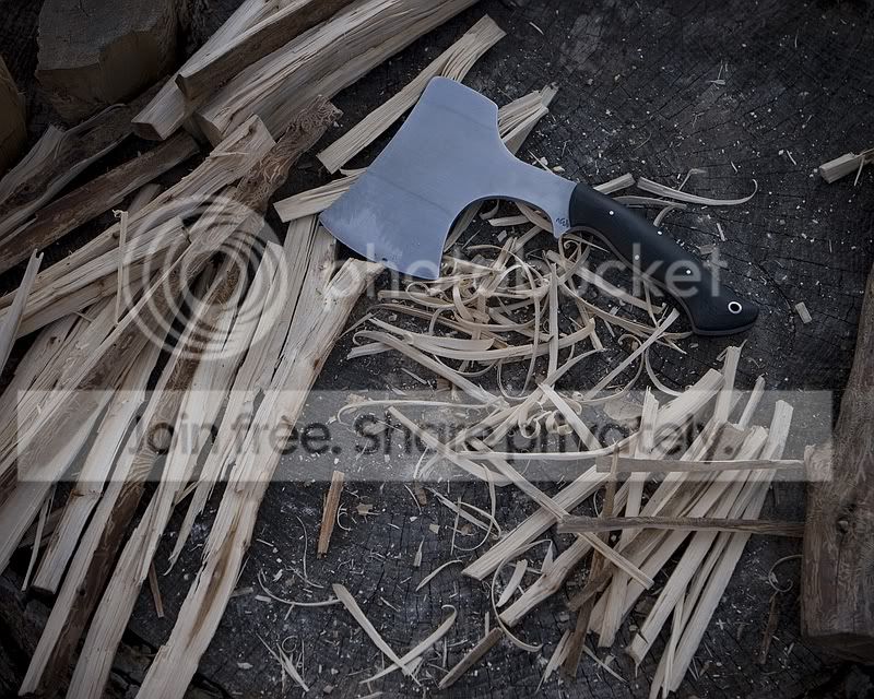

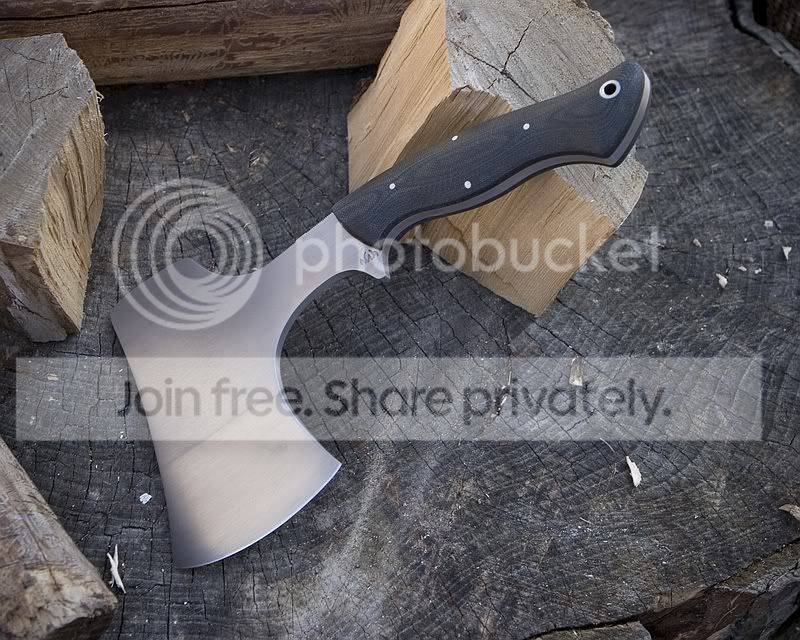

I think most people are aware of my obsession with axes. So, when Nick started talking about this thing, I had to give it a whirl.
First, a teaser pic.
I am not much on "specs." So, hopefully Nick can chime in and give the info on thickness, overall length and all that stuff.
I have to admit, I am a "bigger that axe the better" type. But, there is something cool about having something this small just disappear into your pack.

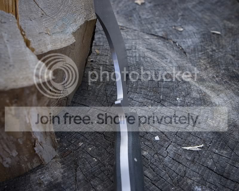

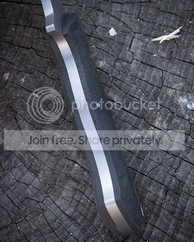

First, some pictures of the details, then we will get down to some business.

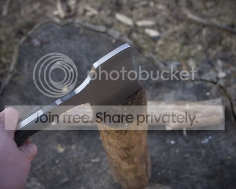

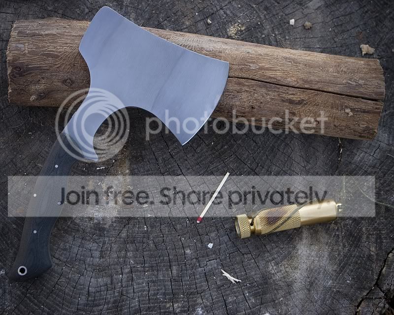

Let's see what this can do. If there is one thing I want an axe to do, is start a fire, under ALL conditions. That can mean getting to the center of wet wood, so that you have dry wood to work with.
So, that is the plan. One log, one axe, and one match. No cotton balls, no fatwood, and no cheating.

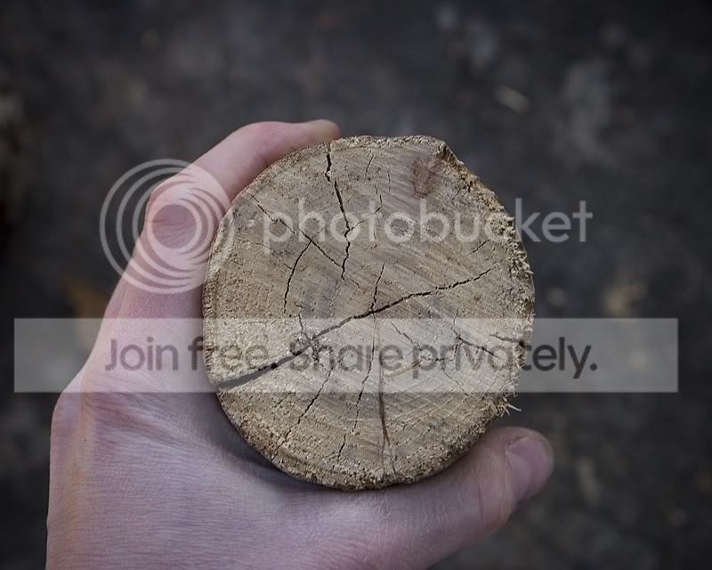

In general, a round this large is plenty big enough. The outer perimeter may show a wetness ring, but the center should be dry. If you want to ensure dryness under the worst possible circumstances, the a diameter about the size of both hands put together is a good mark to shoot for. This log is a touch smaller, but not too far off.

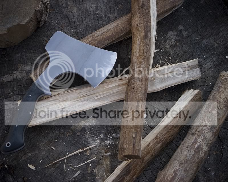

Larger pieces went surprisingly easy. Of course, I am using a wooden log baton through all this. But, the fire came from the one log.

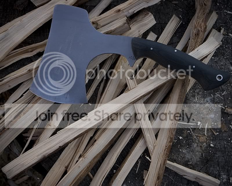

Just kept going at until I had my "kindling."
Keep going smaller until I had all my second stage tinder.
But, this isn't going to do it with only a single match.

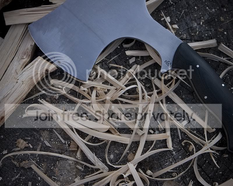

So, I had to keep going smaller. I used the axe to make a whole pile of thin shavings.
To Be Continued Again.....

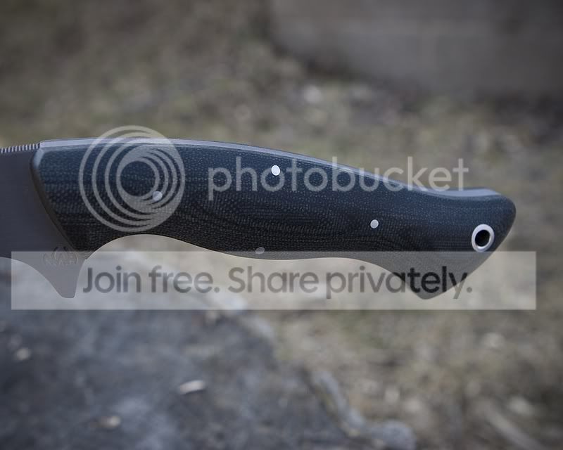

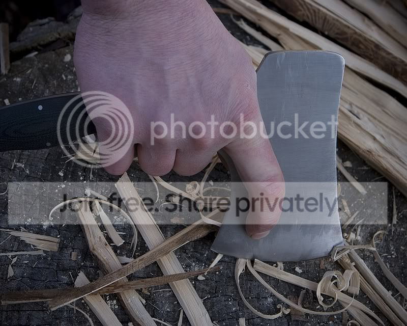

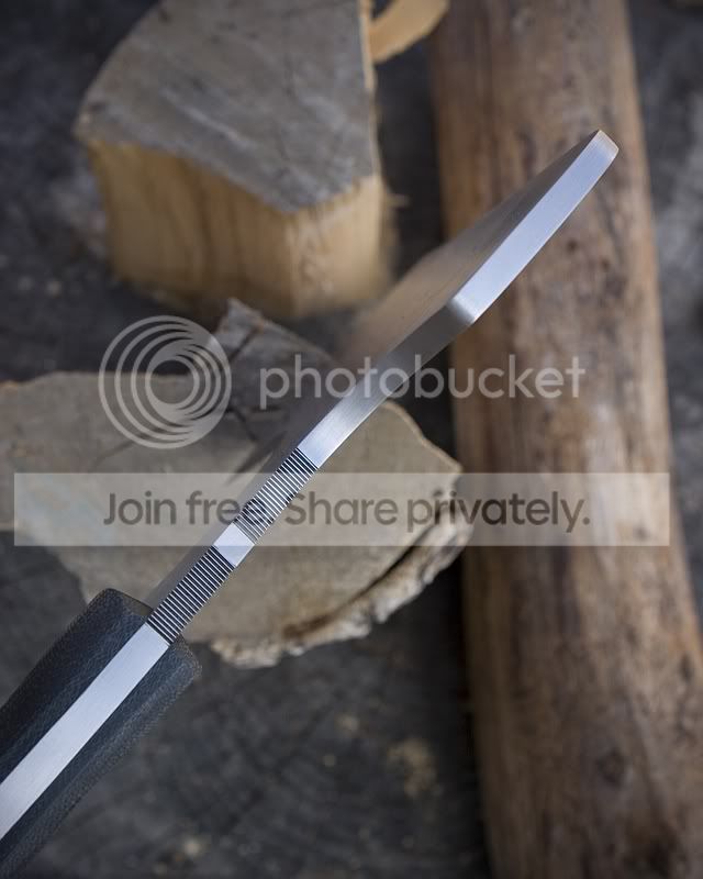

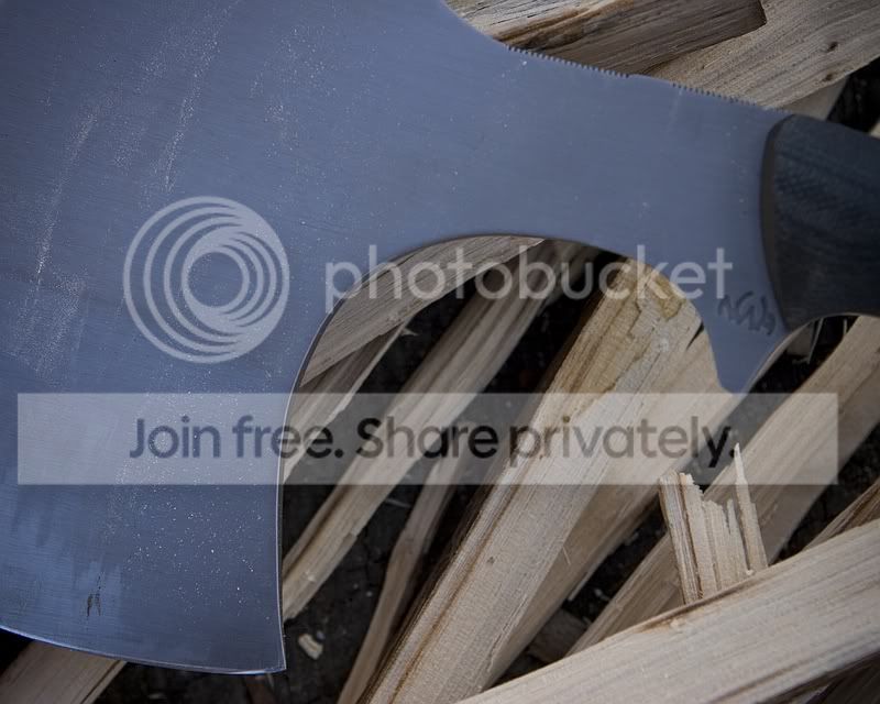

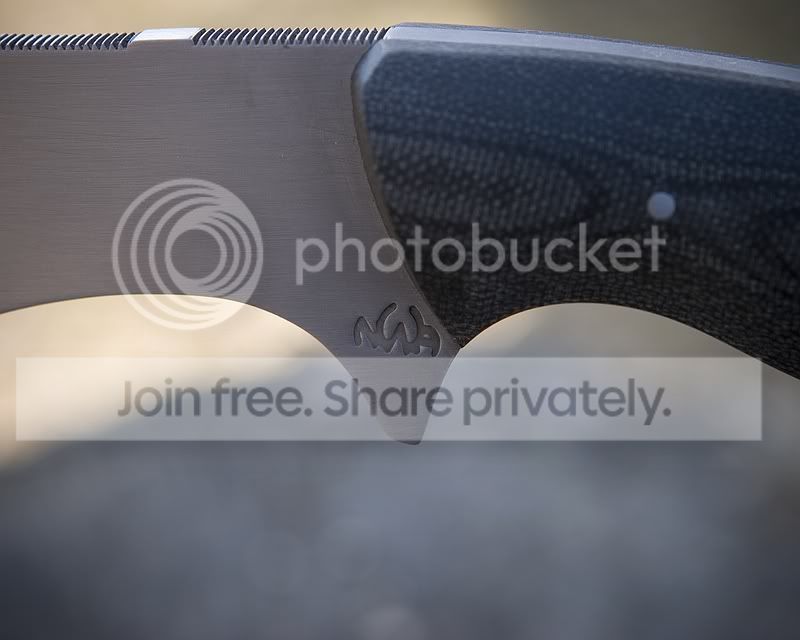

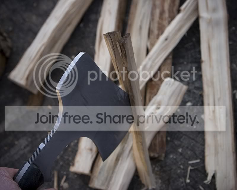

Of note, is the design in this area.
I know Nick spent considerable time here making sure that multiple grips were comfortable. Such as this one.
It is one feature that allowed me to easily make the smaller curls. It could also be useful for food prep, skinning game, or any other detailed chore, should you need to.

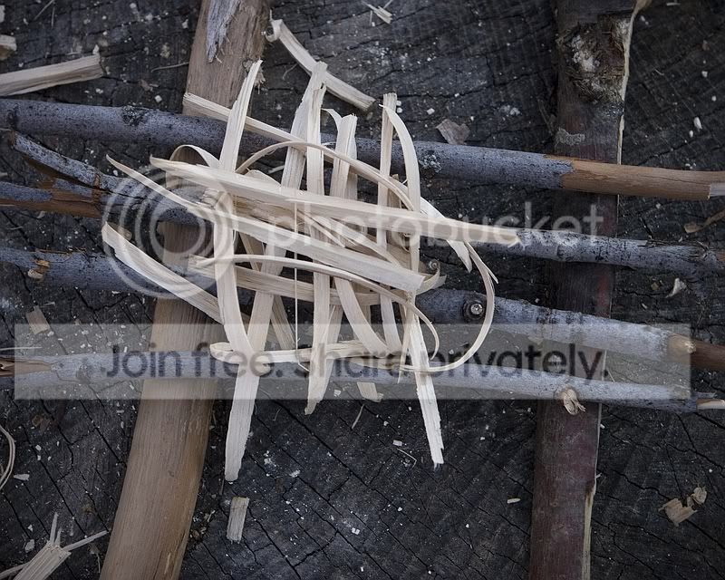

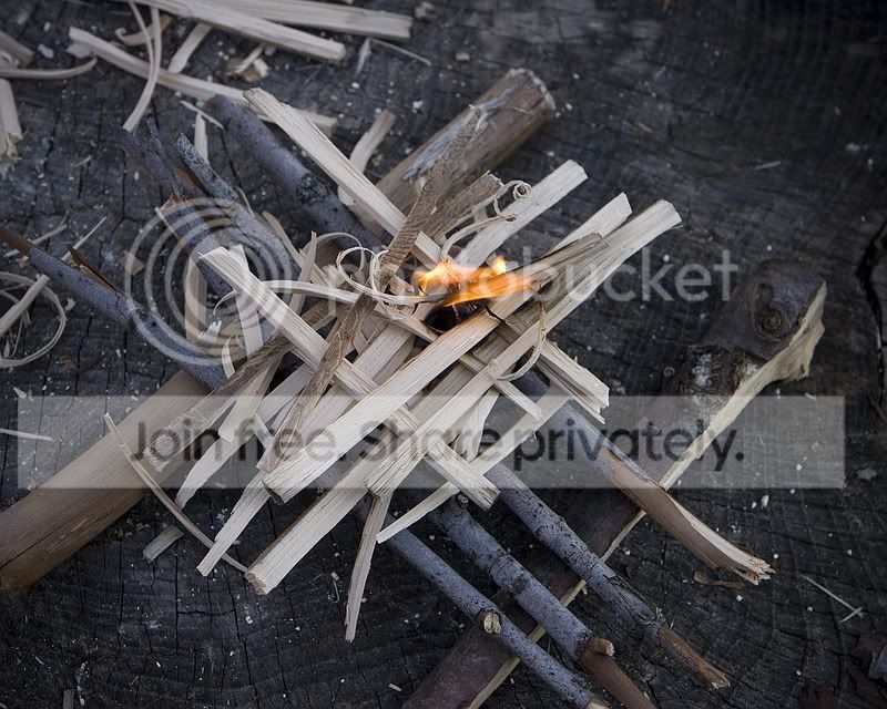

So, there is all together. Everything I should need for the fire. From thin shavings, up through kindling, from my one "dry" log.

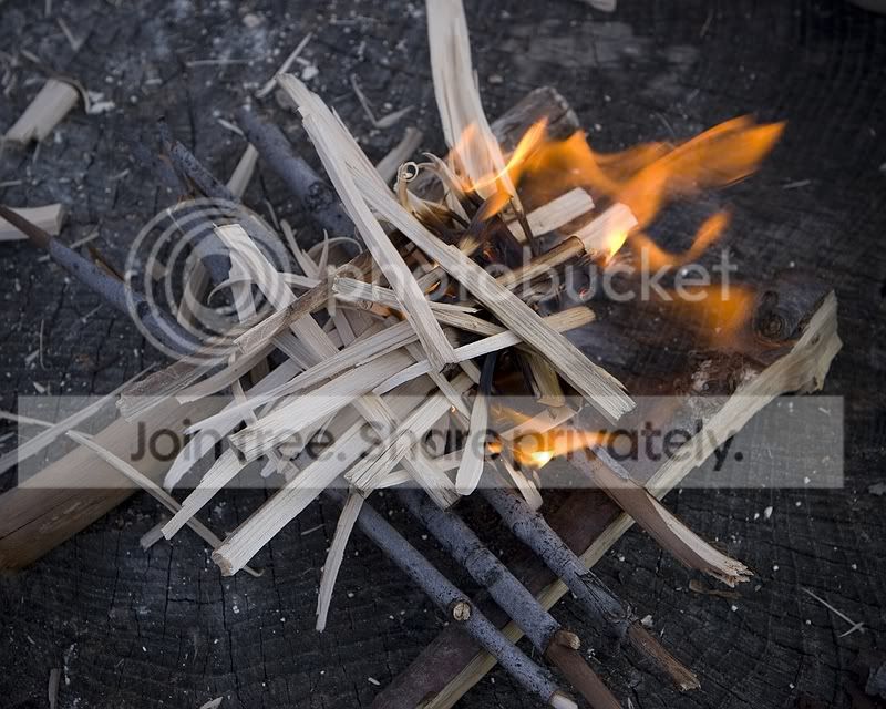

Building the tinder box.
We look ready to go.
Sure enough, it takes off.
Seconds later it looks stable.

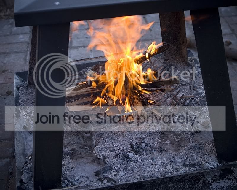

So, I decide to "pick it up" and move it to my firepit where it is roaring good in just a couple more seconds and larger wood is added.

man.. that thing is cool...:eek: i love it... as with all of Nick's work it looks super comfortable, with smooth clean lines...:thumbup:

I think it is 1/4" thick 01 steel...:)

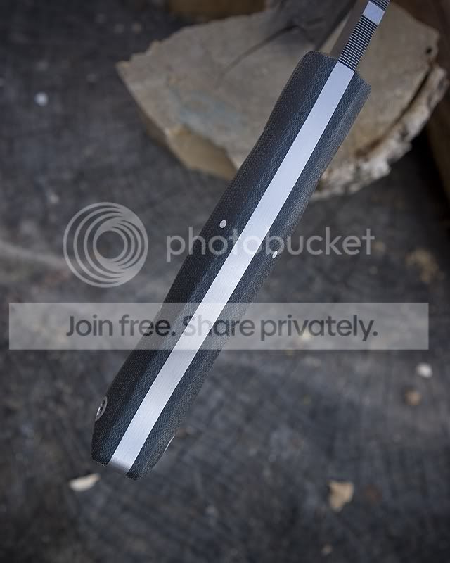

Where you placed your hand for the second grip photo, I thought it would be blistering from the gimping underneath? Why is the gimping there? Could you show some alternative grips using the gimping?
How is the balance, they handle stock looks to be full, and the head is ground, is why i ask. Appears to be a full flat grind too, not a convex edge, is this so?

I Tracker, the serrations on the spine are for grip in one other position on the hatchet. They don't come in contact with your hand as it may seem. Also yes, it is flat ground, the edge is slightly convex. When I was making this thing, it started with a full convex profile, but I thought it looked like crap. It may have performed better as such though. If it was made from 3/8" stock a convex shape would indeed look cool. But since it is from 1/4" stock it really didn't look right. I hope that makes sense.
In the "alternate" grip I show, my palm is covering up the gimping. However, I was not chopping or doing anything with impact. I was just cutting. So, there wasn't really any relative motion between my hand and the gimping. I honestly did not even think about it, until you brought it up.
The stuff I did was not extensive, but that much prep is a bit of work. To truly answer that question, I probably need more "long term" work with it.
It is for another grip which I did not use, or take pictures of. I can do that real quick tomorrow. But, I am losing light FAST right now and can't get it done.
The balance is pretty good. Yet again though, it is only 13" so minute changes are not as obvious to detect. I will have to "play" some more over the weekend. I have some ideas for slightly different head shape, so I think it may evolve just a bit, but it is hard to say. Performance will be the decider on that one, and I am sure it will be more up to Nick when he gets some woods time with a couple variations.
