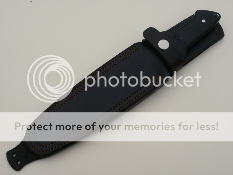

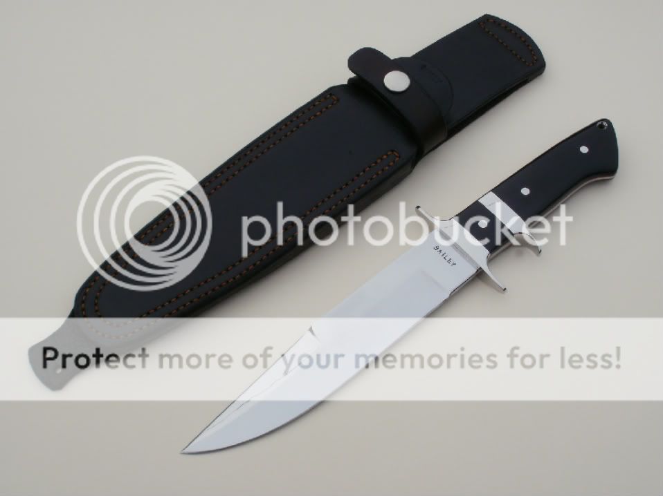

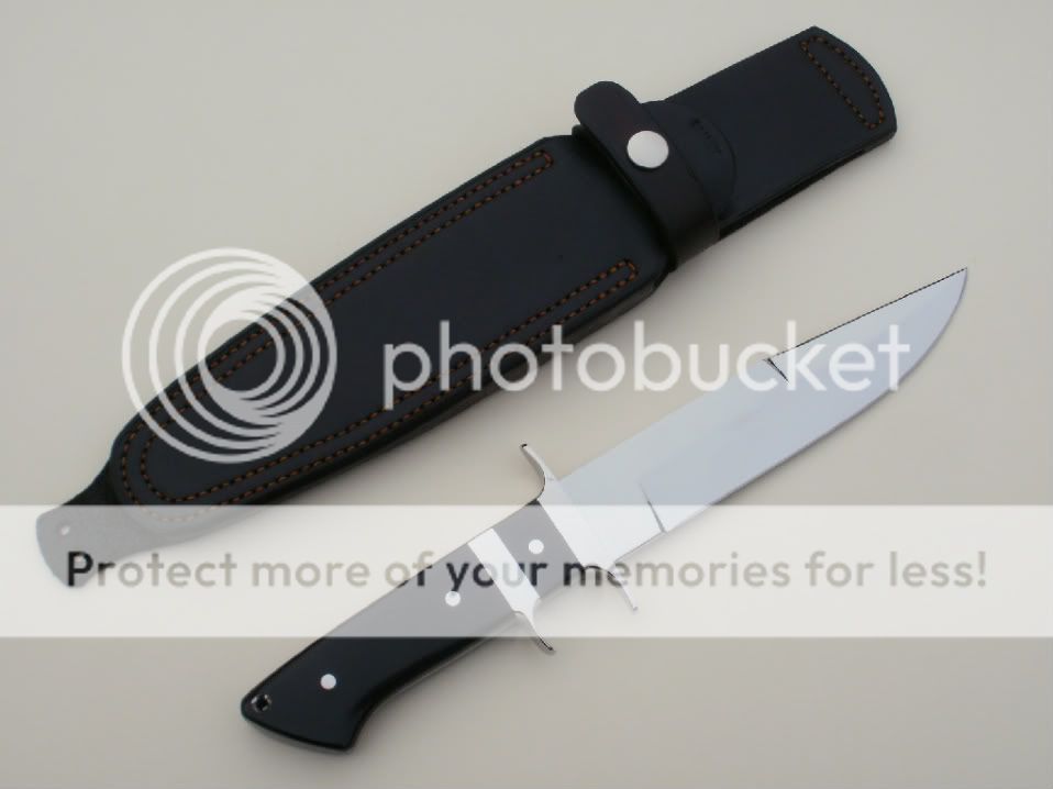

Just finished this one off today.

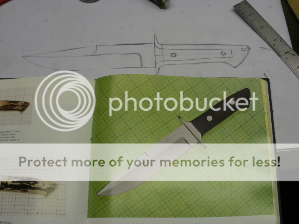

It was originally based on this one from Al Williams' book, and then I decided to make my life difficult and add a sub-hilt.:rolleyes:
It's a 304 stainless frame handle, on a 1095 blade with 303 stainless fittings.
Handle is phenolic resin with red fibre liners. Blade is 7", overall length 12".

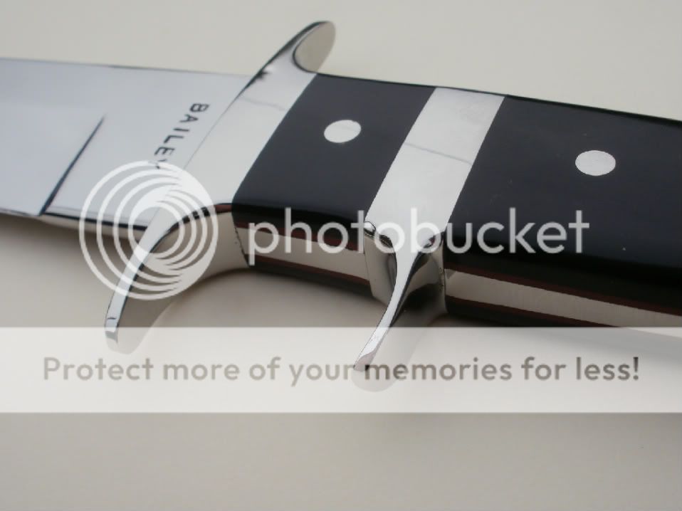

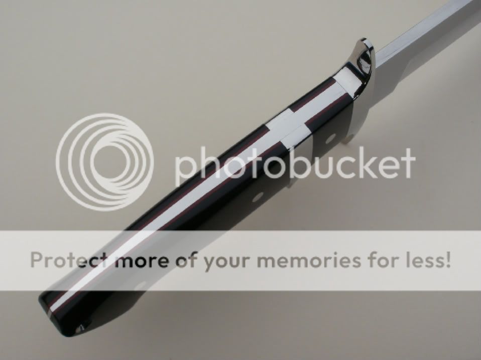

The weird looking marks underneath the guard and sub-hilt are smeared compound from the polish I gave it before taking the photos. I didn't notice it until I'd taken them.:rolleyes:
As usual, your opinions will be very much appreciated.
Thank you for looking.:)
Ian

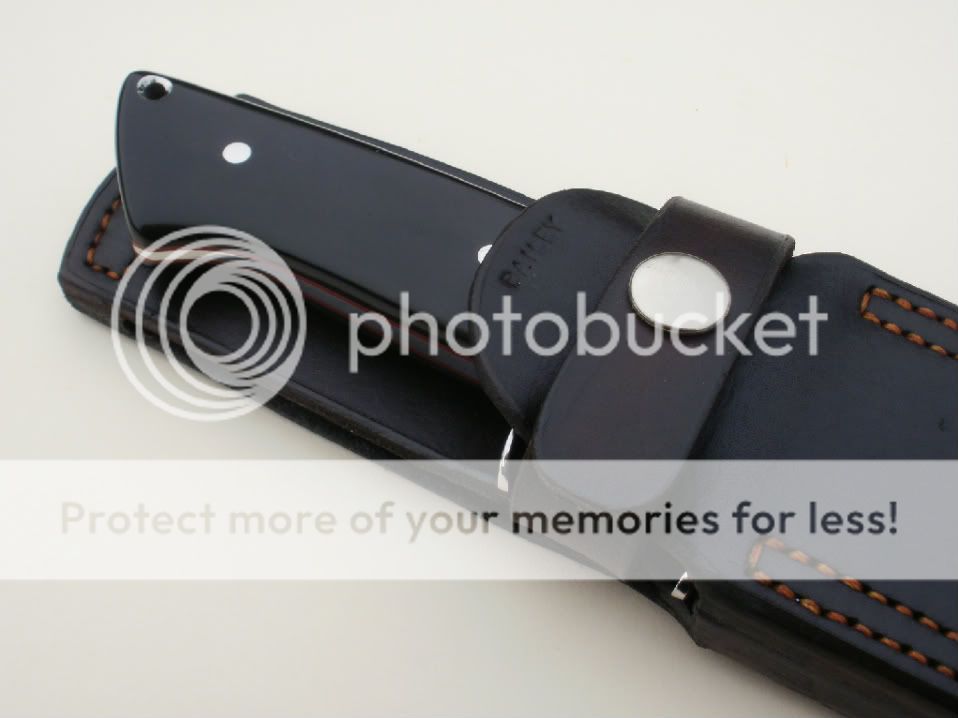

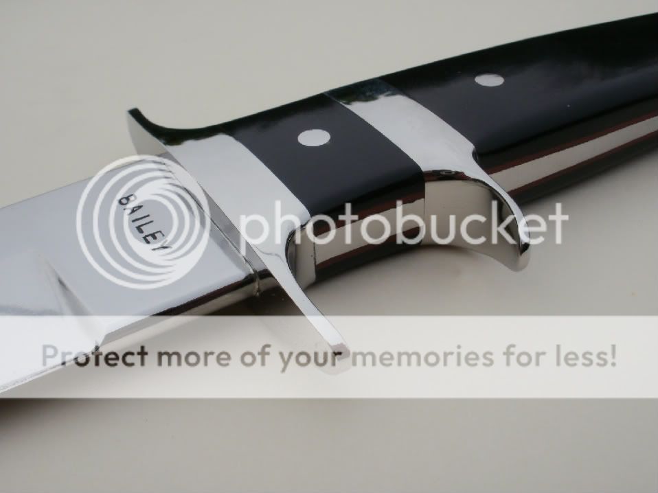

Mike, I never really thought about the super chute knife look. The handle didn't turn out quite how I wanted it to, as it was the second one I fitted due to some burning around the front pin. Not quite the coke bottle shape I was looking for as I thinned out a fair bit of guard and sub hilt trying to get rid of the original burnt scale material..:rolleyes:...better than the first attempt though.;)

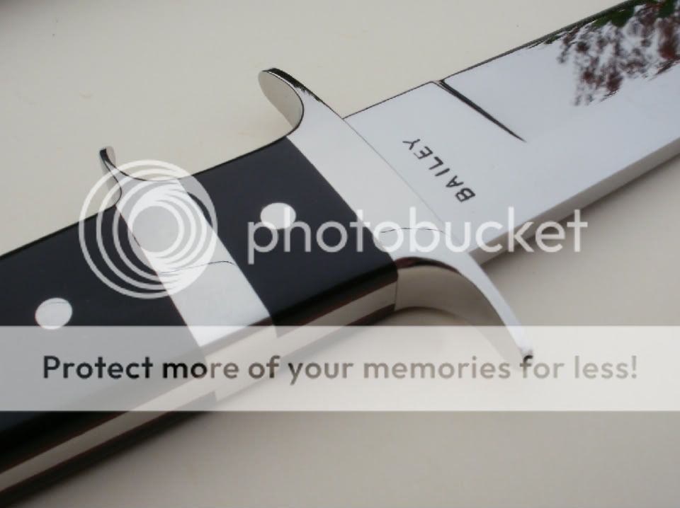

I think it looks great, though the pictures make the edges seem off a bit. Almost like they are fuzzy or reflecting something. Threw me for a bit of a loop till I assume that they are well polished and reflecting.
Ian, they are supposed to be a bit thin. Newer makers tend to make every thing too fat. Too square. That is one of the best kept secrets. Take away everything that isn't necessary to make it a knife! ;)
When we pick up a piece of steel and a block of handle material, there is already a knife there. We just have to remove every thing that is in the way!:cool:
Thanks again to everyone who's taken time to comment.:thumbup:
Josh, I'll be the first to admit that my photos are useless! I'm very good at the 'washed out' look (as I've gone for here:rolleyes:) or the 'weird yellow looking blade' look.:barf:
At some point in the near future, I intend to send this one off to Kam Singh for some proper pictures.
Mike, in the 5 years I've been making knives, I've found that my handles are getting thinner and thinner. My early handles were nearly twice as thick as they are now. I think the fear of taking too much material away was a factor, and I've also noticed that a thin handle just feels nicer.
I think that's what appeals to me about the Loveless style..the fact that they are stripped back to the bare minimum and still so good looking and functional.
I originally planned on having a bit more thickness in the centre of this one, but hey!..if you say it's ok, that's fine by me.:D:cool:
