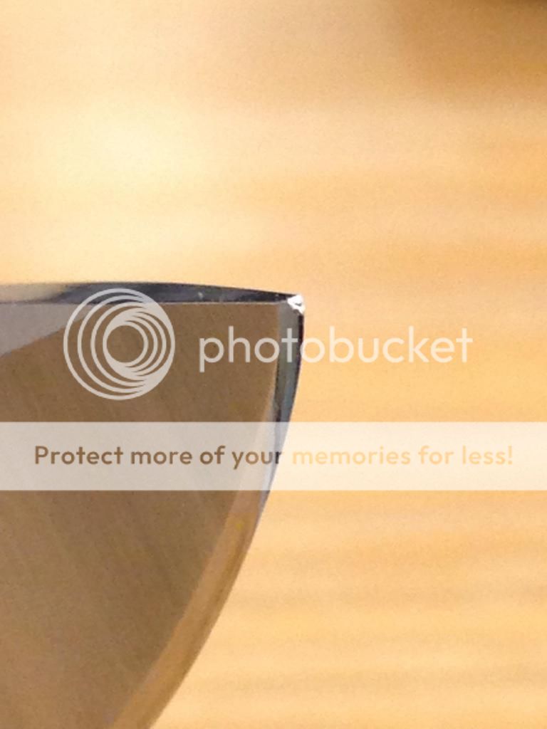

So I had a mishap! Dropped my bad monkey! As I watched it spiral slowly to the ground in horror I realized it was going to hit on the pommel end. It was closed and hit the ground right on the butt end, recoiles the blade open flips 180 degrees and hits square on the tip. ON CERAMIC TILE! I figured for sure there would be a chip. I am happy to report that the steel handled it with aplomb! Just a small little spot right on the tip blunted. Here is a pic. The blunted section is about .5mm by .5mm. I will report back when the resharpening has occurred. Otherwise I am happy that a steel that is hardened to 60 just basically rolled/blunted instead of chipping.
Lol, it is crazy how when you drop a knife it seems like a slow motion event where all you can do is watch, helpless. Keep us posted on the sharpening results.

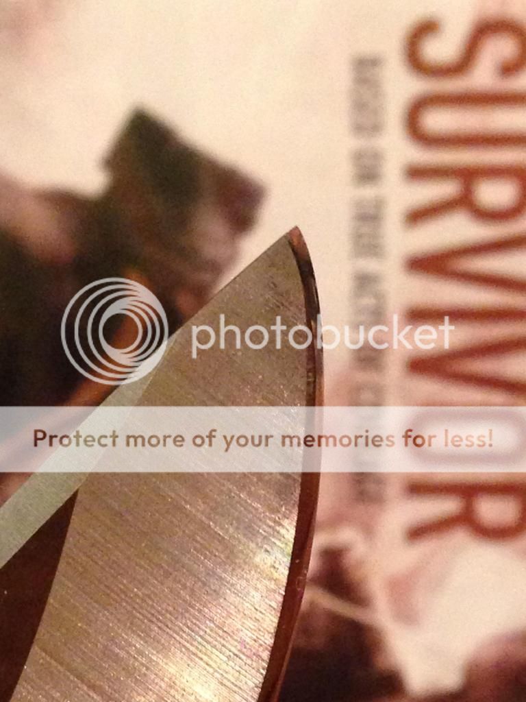

Ok... I sharpen my knives on a 1x30 belt sander with dedicated sharpening belts. Every knife I have gets a mirror polished convexed edge. This method is actually more difficult to learn than hand sharpening because you can wreck a blade in a matter of seconds. I sharpen all my buddies', coworkers', family's and even some forum member's knives with this method. I have sharpened everything from 440a to CPM 3V and everything in between. I usually set my edges with the belt sander and then hand sharpen and strop all of my blades thereafter.
My unscientific assessment of the 14C28N is that it sharpens like 1095 steel. Easy to sharpen and takes a rediculous edge and polishes very well. The edge can be described as sticky. After my knife's encounter with the ceramic tile and no chipping combined, with the ease of sharpening, I am happy! This steel is a great user steel! Gets scary sharp easily, seems relatively tough at 60hrc, resists chipping and should have excellent corrosion resistance. The average hand sharpener should be able to easily maintain a good working edge with a strop loaded with black compound. A set of spyderco medium and fine pocket stones combined with a strop or a spydie ultrafine stone would be sufficient for most sharpening beyond regular maintenance. Here is a pic of my repair. This took about 45 seconds. 15 seconds on each belt and then a pass on the buffing wheel.

That blade fixed up nice Riz!
