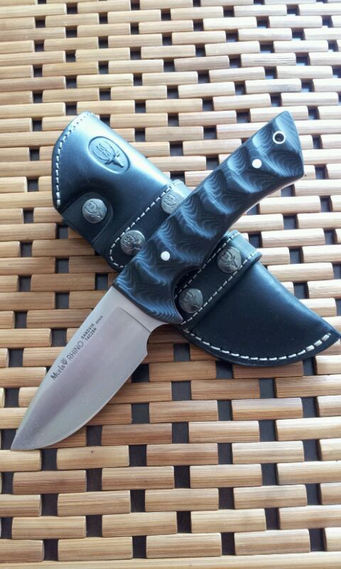

The sheath was very well made, tho with a design flaw that I had seen already in the Muela Rhino sheath. I believe the Rhino's sheath was patterned after this one as this Rhino, although being an old model from Muela, was redone in this new micarta-clad, sandvik steel blade quite recently, while the Axarquia has been around for a couple of years. The Axarquia sheath looked like this one:
and now it looks like this. I did the same to the Rhino. That snap right behind the guard was very annoying as it made contact with the blade steel upon drawing and insertion. No longer an issue. It also has a ferro rod (also included like with the Celtibero) loop, which the rhino sheath lacks

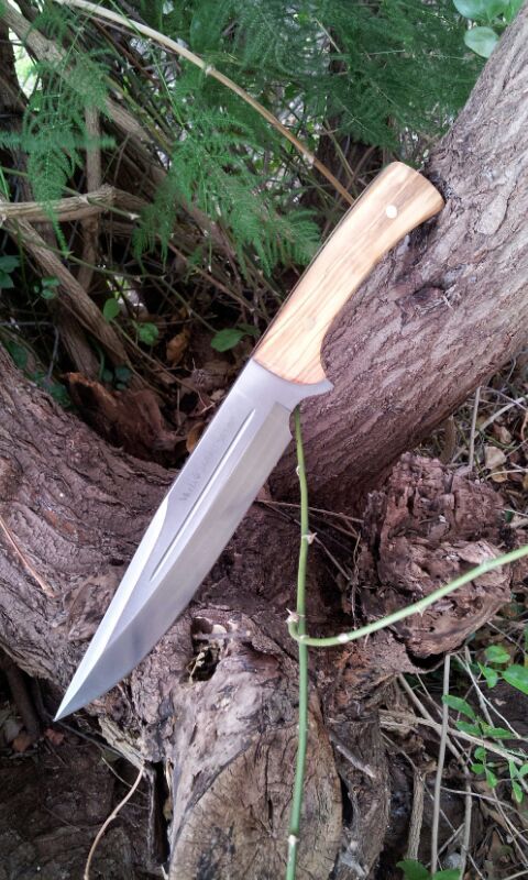

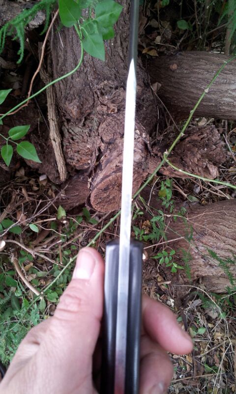

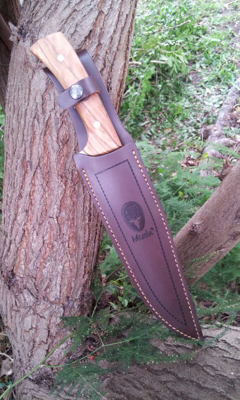

This is a Muela Jabali 21 (as in 21 cm, 8 3/8" blade) with olive scales. Big and simple, full tang and fuller on both sides

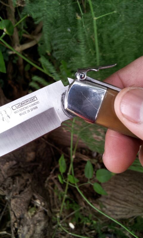

And to wrap up this session, a Cudeman folder in what is called an " albaceteña", a traditional style from the region of Albacete in Spain. The handle has slabs of bull horn. 3.25" blade snaps into a hole in the bar that runs down the spine and acts as the spring with a solid snap. The little lever known as palanquilla on top of the bolsters lifts the bar from the "tooth" of the blade's tang to disengage the lock.

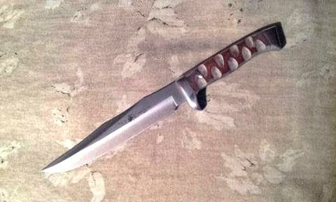

so...no thoughts on the new arrivals? I got 3 more, 1 Muela, 1 Nieto and 1 Alce, which was a subdivision of Muela, kinda like a "B" class. I knew what to expect when I got it cheap, so I proceeded to destroy the handle within 5 minutes of opening the package. It has a nice MAC-V style blade, 1/8" thick, 7" blade and quite sharp, with green scales and brass rivets at the handle. I had no illusions about the tang, as I know this would be a framed bit

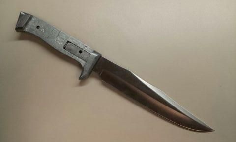

10 minutes later, some grinder and plier action revealed the true story
No prob. I have a homemade paper micarta slab that will be fitted to it, along with pins and g-flex epoxy, which should be a stronger setup than factory. After stripping it seems to be a cast aluminum frame

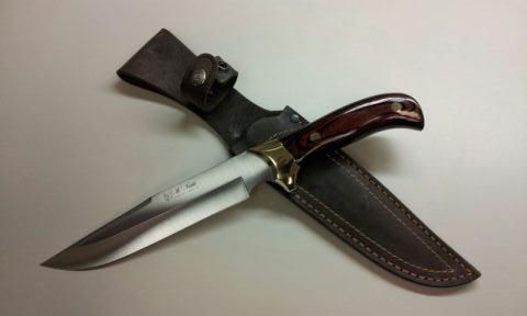

But then I also nabbed this beauty...an older version of Nieto's Cetreria big hunter. You can tell by the sheath, that regardless of age is perfectly solid, and the stamp which reads "440" instead of "AN-58". Nieto made their knives out of 440C before switching to AN-58, which some say is a modified 425, but who knows, so if the seller was honest it dates this knife in the 80's. Big and solid, this one is a 3/16" thick full tang with an 8" blade and laminated wood handle with brass bolsters and pins

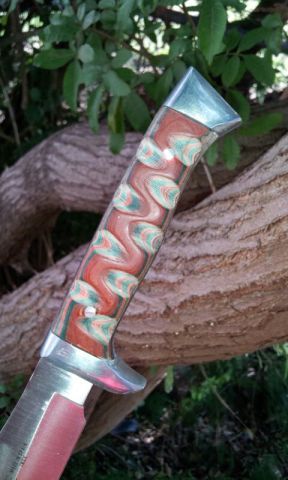

Finished re-handling the Alce. I had made a paper micarta slab some time ago layering orange and green construction paper and added a twist: I mixed glow in the dark powder with the epoxy. After cutting and shaping the slabs, I couldn't find pins the size of the holes so I sacrificed 2 small aluminum carabiners that happenned to fit them. Glued them in the morning with west marine's g-flex epoxy and at night I wrappped it up with the belt sander and stone grinder. The sheath seems to be made of pressed cardboard, and since the strap was broken I riveted one I had made for another knife but cut off.
It DOES glow in the dark, although a bit faint but more visible after the eyes adjust to the darkness. I haven't found out how to take shots of handles like this, as this is the fourth handle I've done with glow in the dark powder, so take my word for it :D
Comments and criticism are welcome.

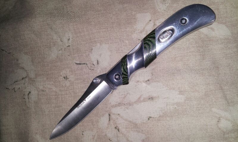

I had forgotten about this one. Another good find on the bay. Came to me with a bith of tarnish in some areas but a piece of 1200 grit sandpaper and some blue magic left it as new. Nice solid lock, came with a pouch as it doen't have a pocket clip. I'm thinking of tapping one to it.

Very cool! I'd love to see some bigger, more close up pics of the handle. I've really been enjoying your collection and seeing it grow

yeah, those were crappy shots. I will do more close ups tomorrow. As for wether Muela makes seconds or not, I'm not sure, will have to ask on the spanish forums. It's just that the Arocho is kinda odd with the way the etching was done - Muela Arocho on one side, Made in Spain Inox on the other. And then the shield on the left side of the handle. Who knows? maybe it was a special order or a slip at the finish line, otherwise solid with no apparent flaws.

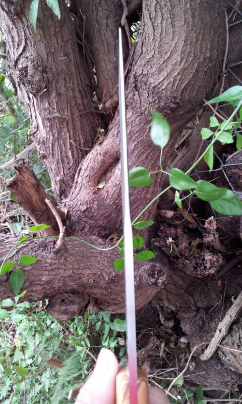

Today I beat up on the Jabali and the big Nieto. They have very similar dimensions and are full tang with shaving sharp edges. I decided to not hold back and see if the hollow grind could handle heavy duty stuff. I selected a very dry branch of about 3" diameter and chopped up sections that were battonned afterwards. I did 3 sections with each knife and was rewarded with good performance, no punishment to the hand and no dings or bends on the edge, the Nieto slightly edging the Muela due to it being thicker and heavier. Next in line for tuff stuff are the CDS.
