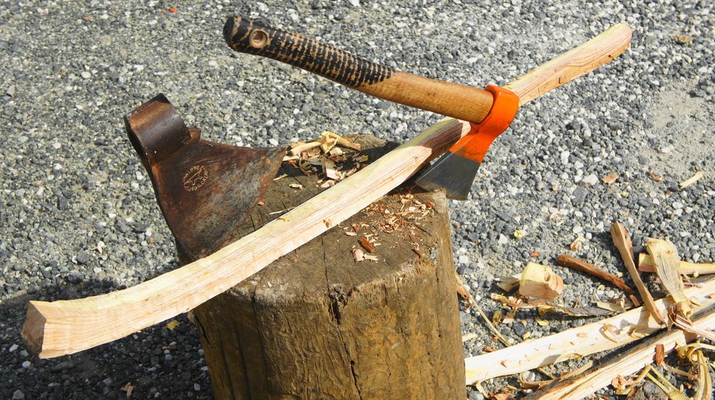

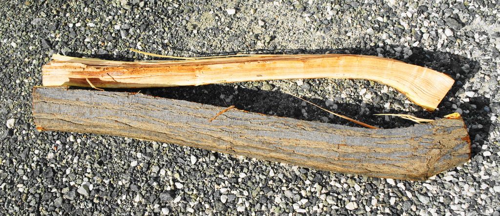

Made a handle for the larger one.
This-
To this- (400g "Lista" hatchet for thinning down)

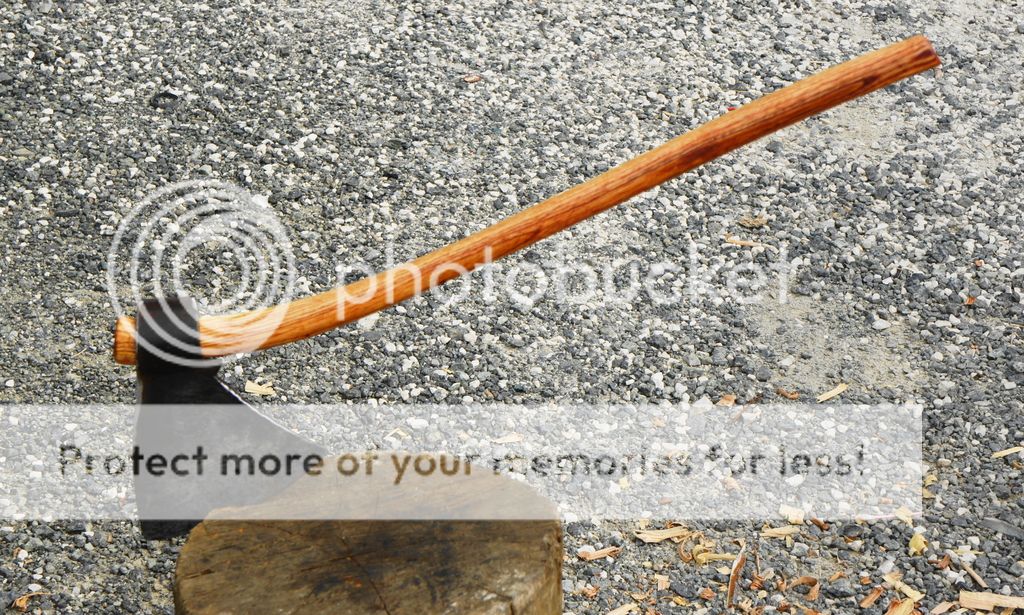

To this- (After using a draw knife & sand paper)
It's pretty skinny as it's a slip through handle but feels good, left it long enough to adjust if necessary. This is a guess as to what the handle should be like, I think the kink in the haft/angle of the eye in the head keeps it tight with every blow.

Nice work!
I see you're keeping with the Spanish style of the slip through axe handle/head. Very nice!

Your end product is 'Shaker-style' exquisite! Your intuition about ergonomics, balance and blade contact when swinging, and using to full advantage the natural curves of a specifically selected piece of wood has yielded something I am envious of. Beautifully done!

300six said it pretty well, that axe you set up really is a pleasing looking tool.
Perfect lines on that handle. Looks like the main length is pointing straight towards the center of gravity, or very close to it, and the angle of the hang is spot on. Not to say that that's what it is, but the head resembles Russian axes that I've seen labeled as butcher's axes.
On this one yes, sometimes like the large French head I'll make a "normal" handle for a slip through head, just a bit trickier to do. And thanks.

Wow, what nice praise I'm flattered! Thank you.

Thank you.
Thanks, it does have a bit of weight below the handle when held horizontal, but I get where you're coming from.

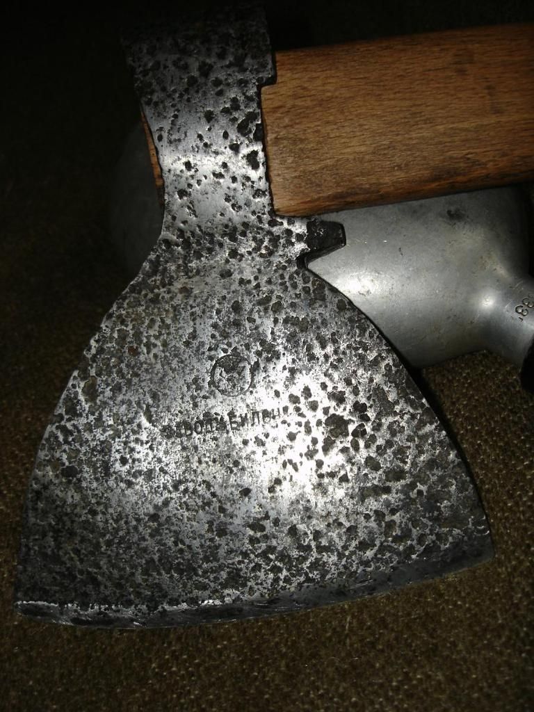

Here's an example of a Russian butcher's axe.
They share pretty wide bits, but the Russian axes have normal eyes with wedged handles. Funnily I turned up this image using "Russian butcher's axe" as a search-
Note how this has the small protrusion under the handle as well, can anyone tell me what it's for?
I know it's no good for overstrike on either axe as the edge comes back further than it.
Also the there is a gap between it & the handle, it'clearly not meant to fit against the bottom of the handle.
Only thing I can think of is something to hang it on a nail or peg by, anyone know?

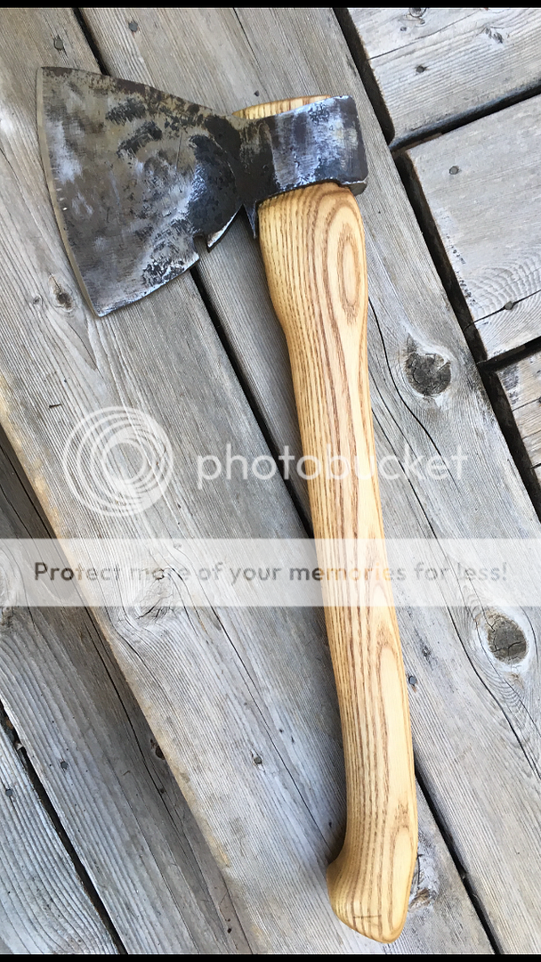

That looks like a Russian carpenter’s/general purpose ТОПОР axe to me:

More an upswept edge comes to mind for a dedicated butcher’s axe
Something along the lines of this Finnish maker for example (Billnäs):

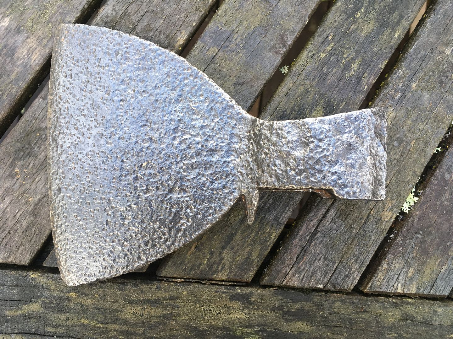

A couple of examples of what I think of you posted there:
What is the spur for? My guess is that the spur was longer down the front of the handle and there was also a second an elongation down the handle at the poll as well in the past.
Here a guy Turbo who describes it as “protection for the bottom of the axe”
http://rusknife.com/topic/9186-топоры-разные/page-27
