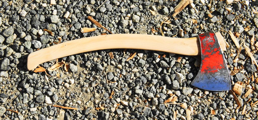

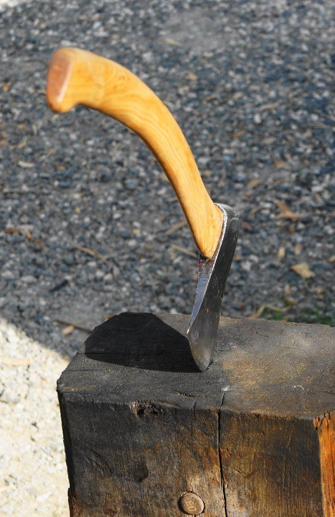

Love the hang you did! Impressive work!
Thank you Zieg. :)

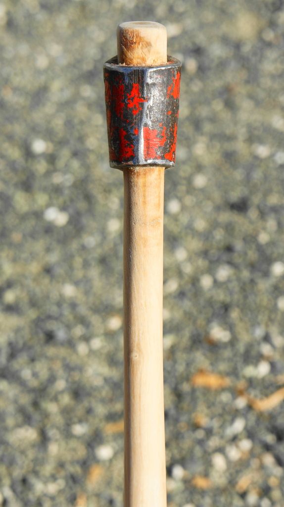

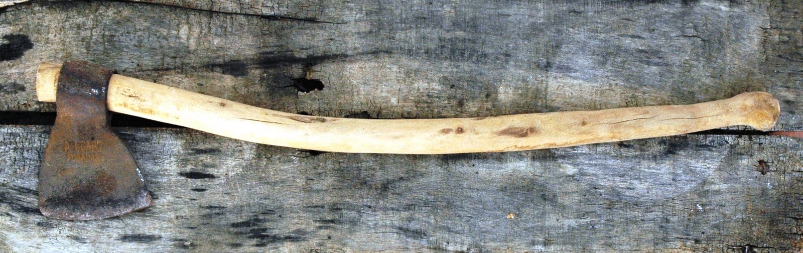

I've made a handle for the smaller one from wild olive, it didn't need curves in it but, well why not......... ;)
It's a thin handle as the eye is very narrow, it's three times as deep as it's wide! ;)
Needs oiling now.

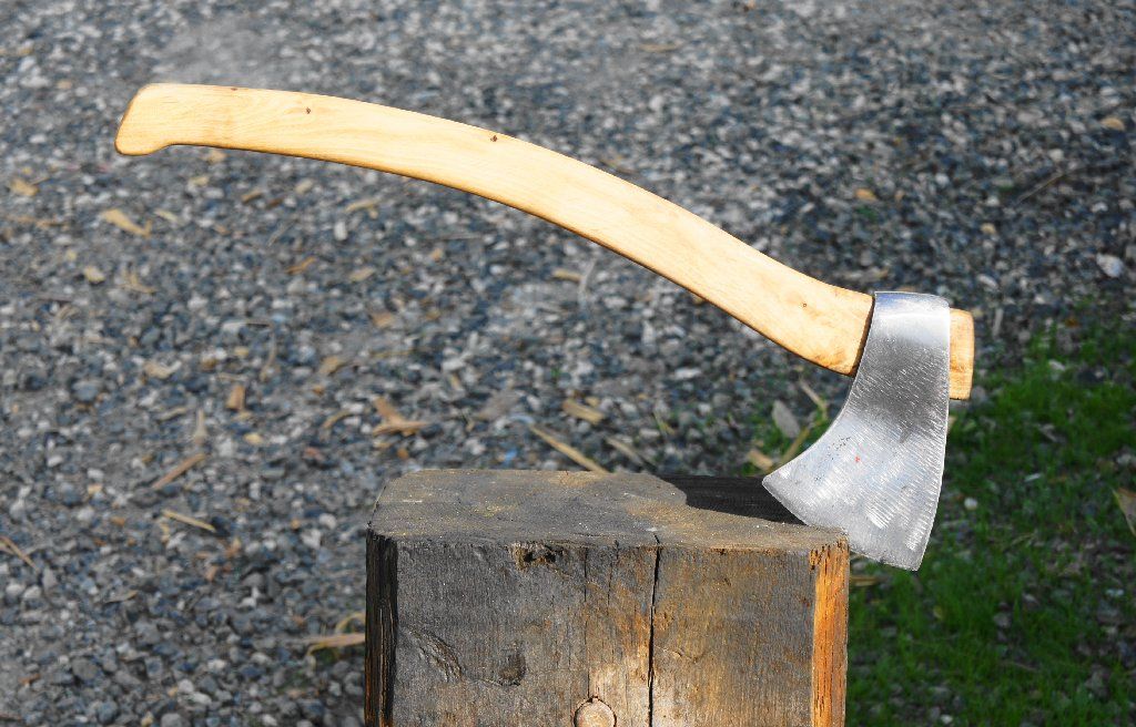

On to the newer hatchet, I was going to leave the head alone but I couldn't :), so after a bit of disc work-
Didn't spend too much time on it as it'll get used, below showing the handle that must slide through the narrow head.
It actually feels alright despite being very narrow. The grain does turn up & follow through the head despite how it looks in the pic, it's just the way it's cut/sanded.
