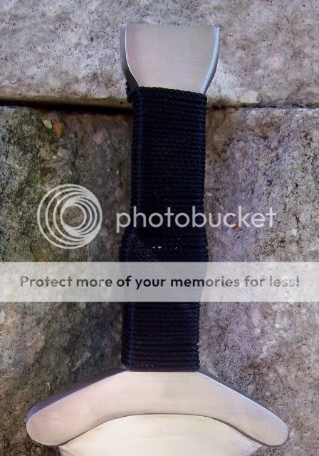

Added Black Cord wrap to the sword. No longer available without the cord wrap.

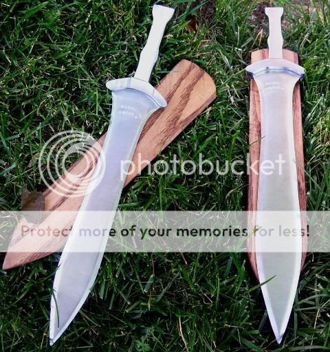

Also referred to as the Spartan Xiphos Sword. Hope you like it. Put a lot of time into this one. My hands are tired! Attached some better pictures. Sure does make a difference when you have daylight.

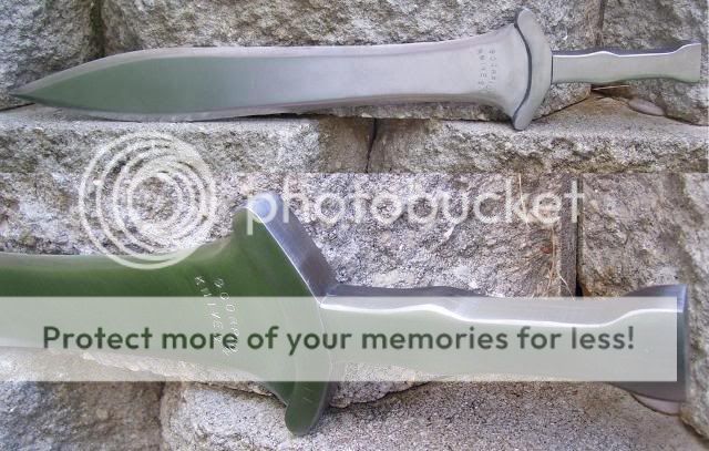

Saw Blade Steel and 5160 Steel (for the Scales) were cut out and Normalized @ 1500 degrees until non magnetic, three times, to remove stresses and align crystals. Heat Hardened until blade became nonmagnetic, then quenched in 125 degree quality oil. Tempered the blade to a straw hardness @ 425 degrees for 1 hour, letting it air cool and repeating once more. Blade was file tested and is shown to be very hard.
Measurements:
Total Length = 19 ½ “
Blade Length = 14 ¾ “
Blade Width = 2 1/8 “ (widest section), 1 11/16” (Narrowest Section)
Blade Thickness = 3/16 “
Handle Length = 4 ¾ “
Handle Width = 7/8 “
Handle: 5160 steel scales, pined.
Weight = 2 lbs

cool looking. I think I might like it better with a bit more rounding on the handle "scales" and perhaps a leather wrap. Thinking of whacking something with an all steel handle made my wrist tingle.
I bet it moves the balance back toward the hand though. Makes the blade feel lighter.
Thanks for your comments. I was trying to go for the historical look. You can see this on the "Deadliest Warrier" show, they've been playing on spike TV. It doesn't have a leather wrap. I'll be putting a vid out on this, hopfully tonight, which will give you more information on it. Interesting show. I am certainly up for adding a leather wrap to anyone interested in buying, though. Chris

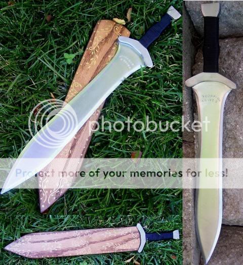

Thanks buddy. Some day I may just try that. In the meantime, I kicked it up a notch. Added black cord wrap to the sword and etching to the scabbard. Added the pictures above.
