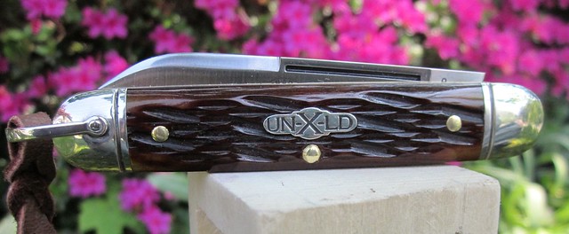

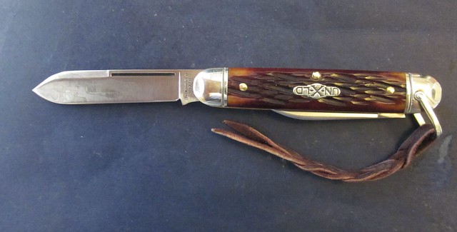

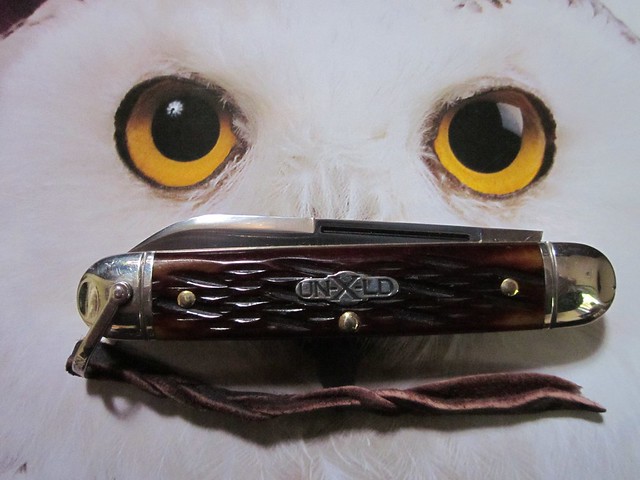

The reason I started this thread is because I'm planning on picking up a White Owl for my birthday and I'm not sure if I want the clip or the spear blade. Very good points as well guys you've kind of got me leaning towards the spear blade.
I would like to point out one thing on the white owl, the clip version, the blade doesn't stick out of the handle. On the spear version the blade sticks out significantly more.
... But it's perfect all the same. ;)
~ P.
