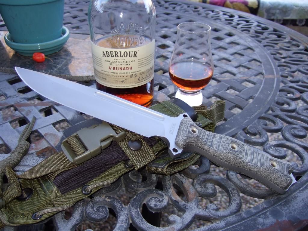

Yep, the Combat Master Long fits the TGLB darned near perfect without any adjustment. However, it is pretty easy to warm the Kydex for an exact fit if you like.
FYI, Spec-Ops is no longer using a Chicago screw to hold the Kydex liner in place. Instead, there is a rivet in the Kydex liner, and the liner has Velcro on the back. No hole through the Nylon either as a side-effect.
Here's mine:

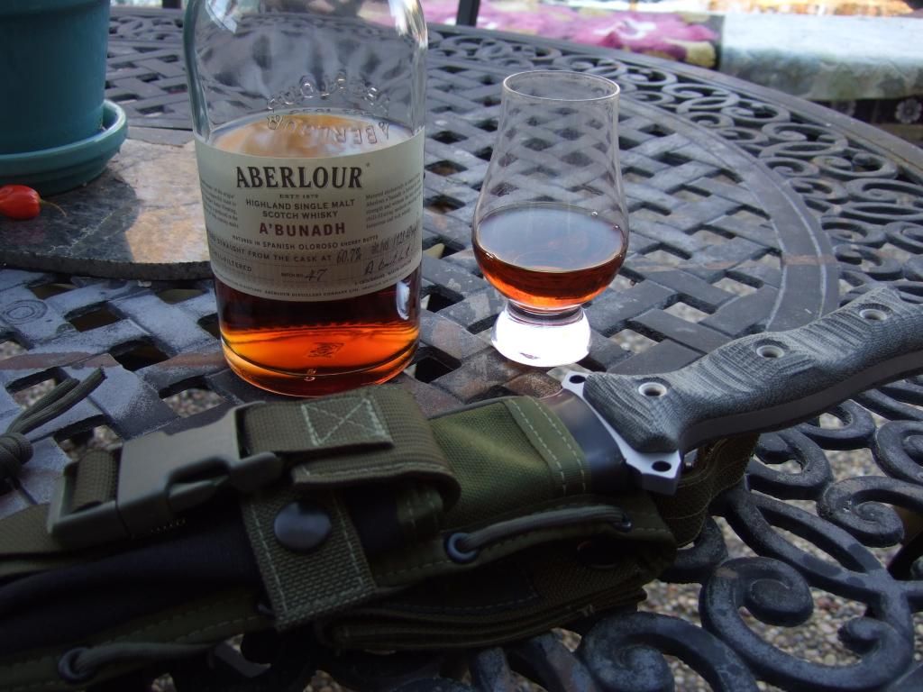

Texican, You have a beautiful knife. And as I see, the insert sticks out from the fabric sheath, so it is a bit longer than mine. Because mine fits exactly to the fabric, I think it is a bit shortened.
