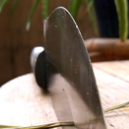

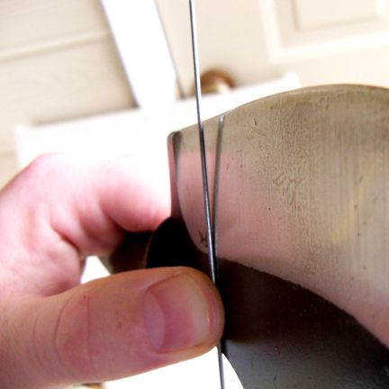

Grind:[/B].................... Convex Saber (with Ghost Scale)
Dylside, I need some help here. Your knife seems to be hollow ground, yet you call it convex. It has no swedge or false grind, yet you call it a sabre grind.
Can you help me?
thanks,
A. G.
Can you help me?
thanks,
A. G.
A. G.,
It is convex. You're eyes are just playing tricks on you.
As for the "saber" part, That is to describe the height of the grind. We refer to it as a full-height grind when the grind comes all the way up to the spine. When it doesn't come all the way up, we refer to it as a "Saber Grind" in reference to the sabers of the old days that were ground only partially up the blade, not the full height to spine.

The term "Convex Saber Grind" actually didn't exist (to my knowledge) before Andy Roy and I started using it. We do a grind that is a "saber grind" except that instead of using flat ground bevels, we convex the bevels. All we did was combine the terms and came up with "Convex Saber". Truthfully, the term is much more Andy Roy's than it is mine. If I was giving real credit to anyone for inventing the term, I would give it to him.
As far as the need for a swedge or bevel toward the spine, to my knowledge, having a sharpened (or unsharpened) swedge or top-side bevel is in no way necessary to a "Saber Grind". It's simply an interpretation of the terminology, which as we all know is subjective to different regions and schools of thought concerning the tools. If you ask one person what a "Clip Point" is, they will steer you toward the popular shape of a Bowie blade. Others will describe what most people would call a swedge. It just depends on who you ask and what kind of knife terminology they're used to using.
