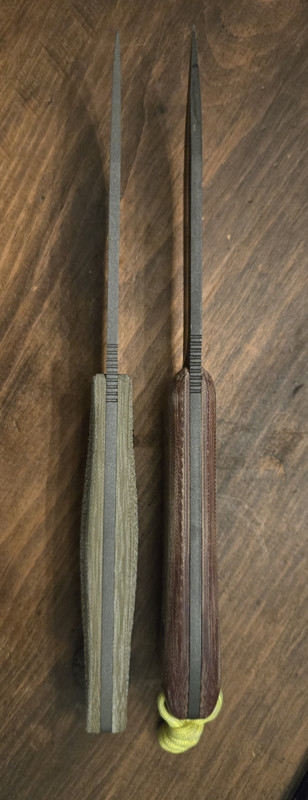

I love the 104 blade shape and the "regular" 5160 version has been my camp knife for a while now. My version of camping is car/tent camping, usually at somewhat rustic State Park type campgrounds. So, not crazy bushcrafting, basically breaking down kindling, minor camp tasks and food prep. The slicey hollow grind was great for that. The full flat grind is a little thicker behind the edge, but should work fine.
The handle is absolutely miles better on this BOTM. The mid swell is more comfortable in the hand than the somewhat blocky original, and the milling makes it much grippier than regular micarta, which was a little smooth for my liking.

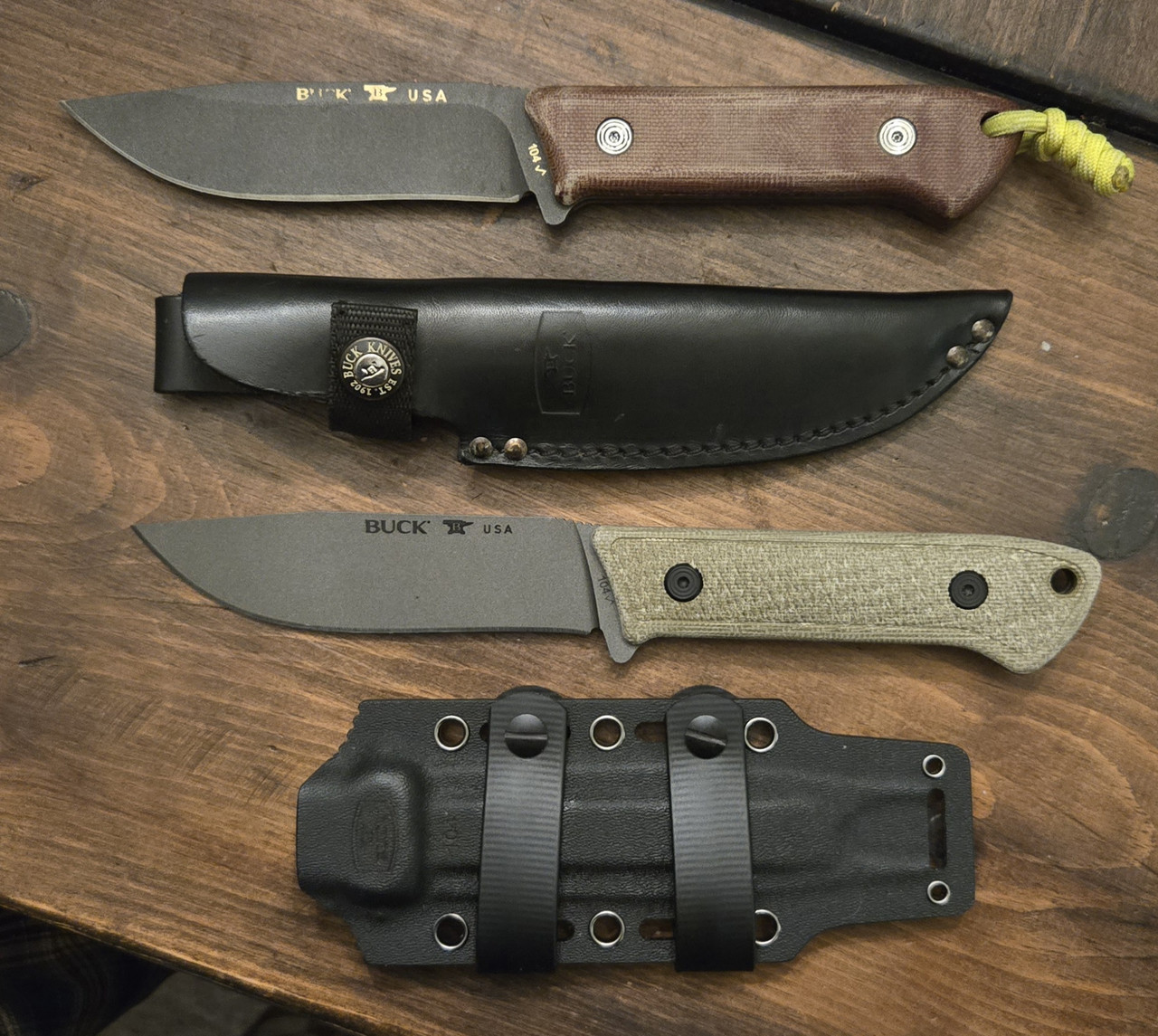

Arrived last week! The paracord is actually dark green, which looks good in person. I also ordered an extra 104 leather sheath at the same time.
I just ordered a regular sheath for mine too.
The kydex would be good for keeping it in my truck, where it will be a lot, but to me, the regular one is much better to actually carry it.
