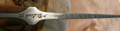

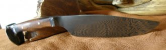

All right I feel pretty good about this one. It took three tries to get here. I stopped 3/4 of the way through the second one as I had made the same mistake on it, as I on did the first one. I hope some other makers join in. This is my entry. I learned some new things, so it was well worth the time I spent playing in the fire.
OAL is 9" blade is 5" handle is iron wood.

Hay Mike what's the worst thing that could happen. you teach yourself a thing or two and wind up with an x miss gift for a friend. hay feel free to try the san mai thing that goes for all makers. that would like to try it it is a lot of fun. hay Don who will be the first maker to slide a big wedge of w2 in a spike. that could be cool. so hear is a little of what I learned by doing 3 of them. if you thin and widen the end of the spike be for you split it things work way better. you can put in a bigger wedge and there is a lot less spike to remove. and less chance of spike steel stuck in your pattern. hope this helps.
