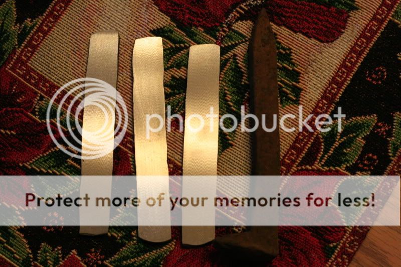

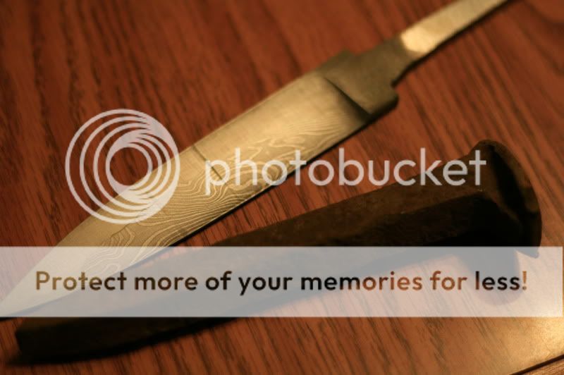

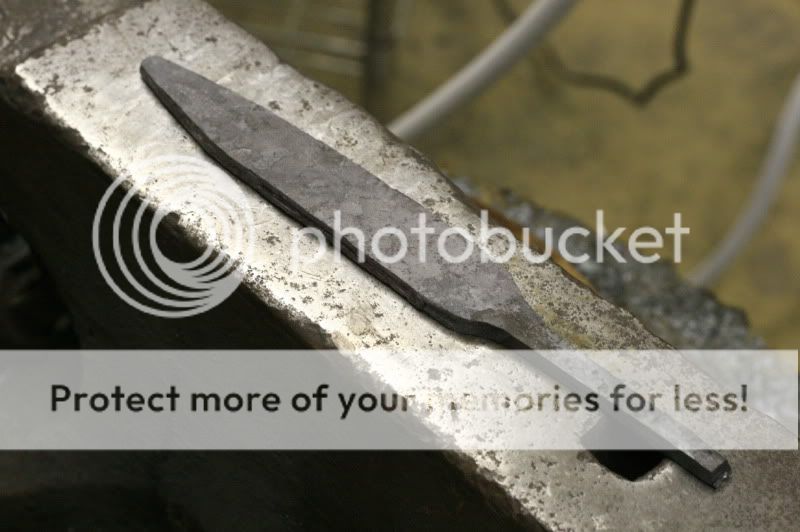

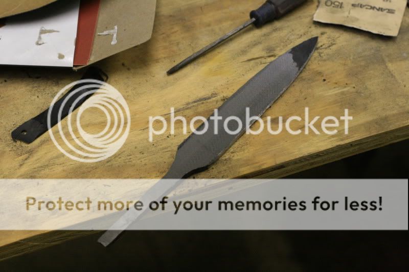

I decided to use this project as a chance to grow :) So here is my first solo damascus, first san mai, first railroad spike knife WIP. Hope to have the knife finished before New Years but might not make the deadline.
I started by hot cutting the head off the spike (will be used intact as the buttplate) then I drew out the spike into a flat bar and cut it in half and cut a piece of damascus from a twist billet I had made a week before but hadn't made a knife out of. Then I san mai'd it all up and made a blade blank out of it.
More to come tomorrow. :)

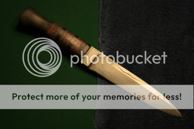

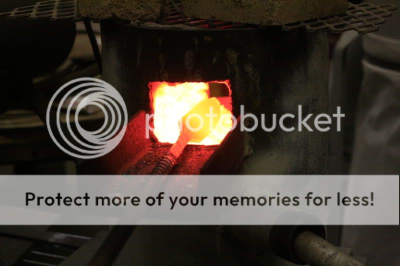

Thanks for the kind words, I did mess up on my san mai welds. :( I think the flaw came from the forge temp having 300 degree swings. My propane hose kept icing up and making things difficult. I will still finish it up since it is my first damascus knife.

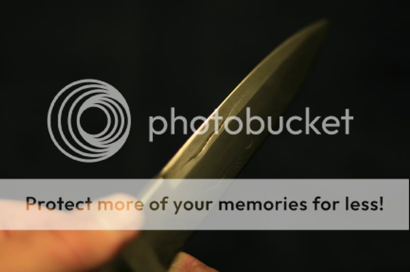

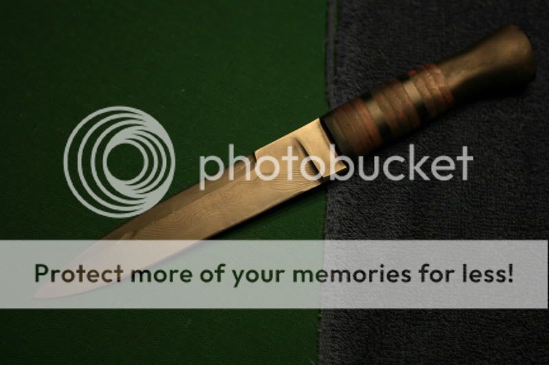

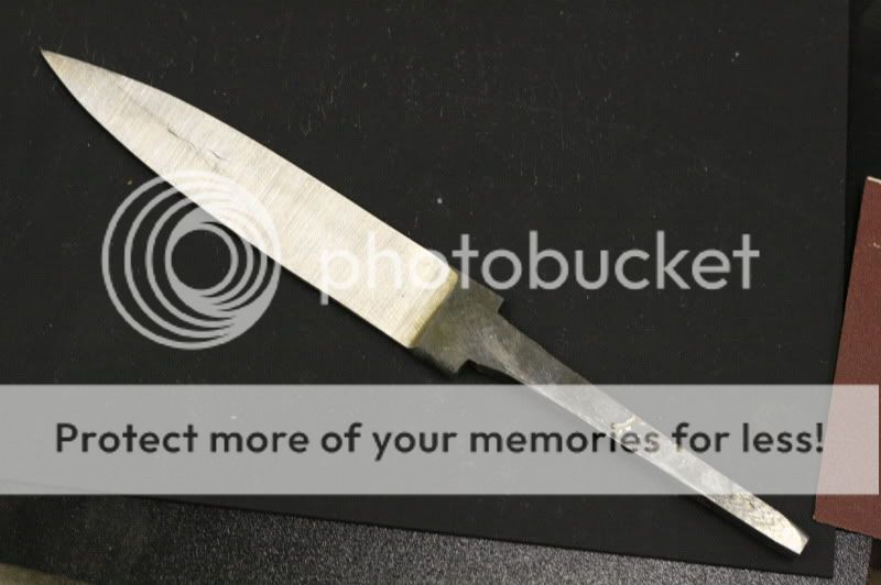

I am going to have to start over, this one didn't come out very well. Part of the RR spike de-laminated and fell off while I was grinding. I did finish it with a very quick dirty handle and finish, just enough for it to be a usable knife.
Here is the sad conclusion to attempt 1, you can see the de-lams pretty clear on it. Handle was thrown together just to finish the knife rather then throw away 3 days of work.
Jon to bad for the delams I like it thou good looking knife. You may want to get one of Dave Lisch's forges I have one of his 2 burners it does not froze the bottle or hose and I am getting 65-70 hours on a 100# propane bottle which is 3 times the amount of time I was getting with my single burner blown forge which would freeze my bottle in 3 hours.
