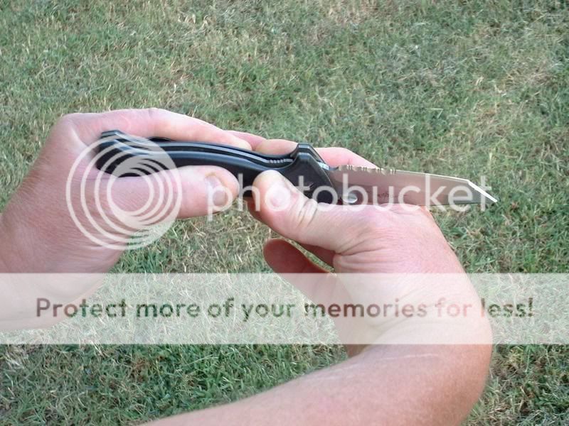

A good way to test a knife is by applying force to the spine as demonstrated here by STR
If a liner lock or framelock jumps, or slides to the unlocking position it is not a good sight. Now testing any lock like this keeping your fingers clear you can see if a lock is moving, jumping or how it is behaving. You cant see this with a spine wack. A spine tap Sal Glesser has used to see if the knife's lock is nested correctly, in other words, behaving like the lock was designed to.
