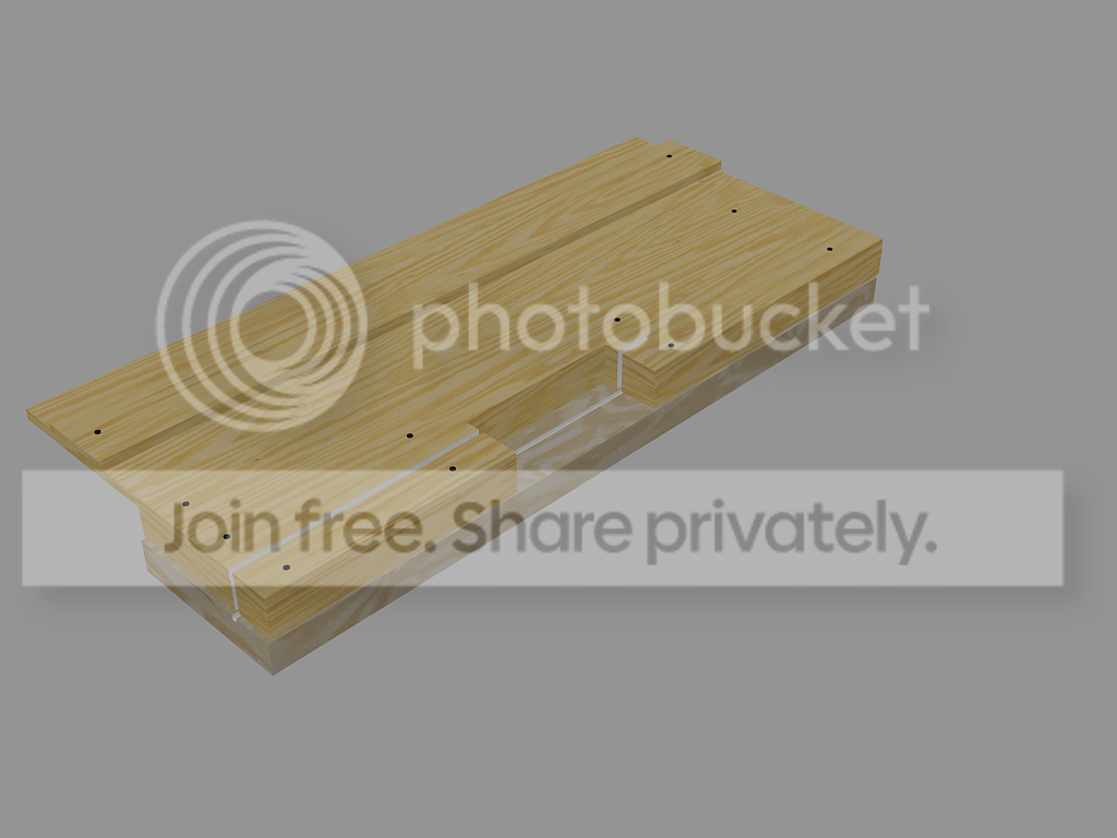

For anyone reading that doesn't have access to a table saw and only a circular saw you can build a small table "jig" out of some cheep material to hold the small block and a rip fence. Either glue the block in place or use some painters tape to hold it squarely in the of the notch, that way as you push the saw through the notch holds it from moving in the forward direction.
Just make sure your saw base is square to the blade with an actual square, don't just go by the setting on the saw. Also set your depth to just below the flat so you will cut all the way through the scale block. Set the rip fence and cut a test piece of material first before attempting to cut the scale block and check for size and squareness. I have done this hundreds of times for cutting small intricate pieces of wood with a circular saw.
