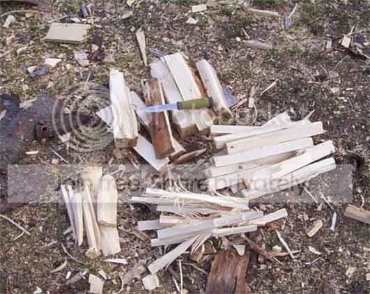

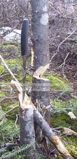

With a small blade, with no premade wedges, no precut lumber, and no use of anything else to make wedges or gather the wood for batoning. The only thing artifical was the use of actual cut rounds for splitting because I wanted them to be of a certain type and I have hundreds of them to sort through.
Starting off the problem is getting the initial wedges, using a very slim Mora, there is little prying ability so you can't just directly pry off a chunk of wood, and the blade can be far too short to baton off a piece directly either. So how do you split directly a large piece of wood.

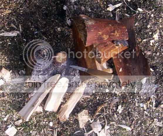

Using a bunch of cracked off dead branches, a half a dozen small wedges were made, these were used to split a straight grained, very open and easy to split round. Most of the wedges were destroyed in the process, a rock was used as a baton :

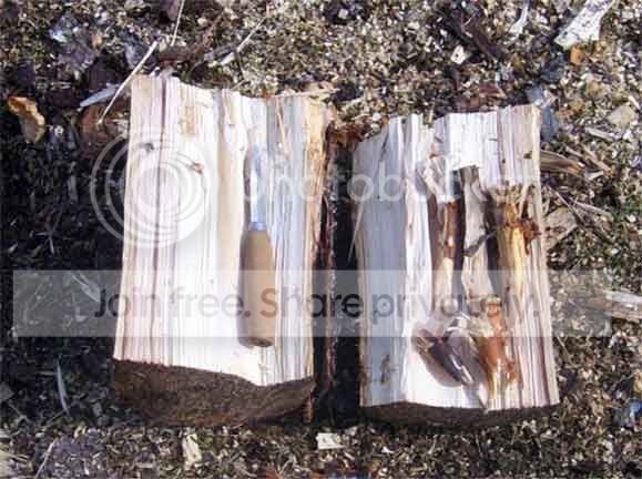

With the round split in half, a better wedge could be batoned directly with the Mora, which was then used to split off larger sections :
The primary edge is right alongside of the Mora. These larger sections made better wedges still, which enabled the splitting to be finished :
The wear on the wedge is visible. After each split it should be reshaped to remove any damaged wood to keep it going. With all the wood available for wedges it was now possible to split more difficult woods, including a piece with severe knots :

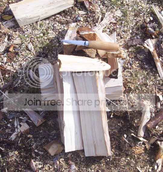

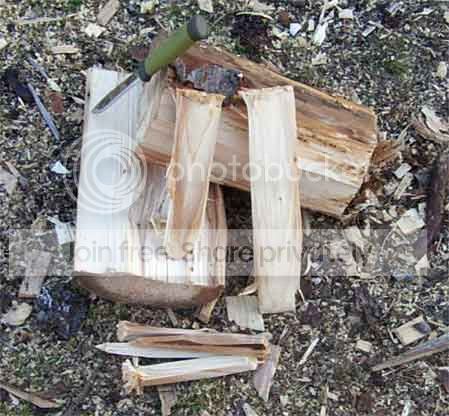

The process is much faster with a large knife because it can usually just baton off a small shim initially and skip a step in the process :
The small wedge enabled two larger splits to be removed which were cut into wedges, one of which broke during the splitting of the round in half and is the pieces at the bottom.
A much wider blade such as on the Mora 2000 also allows the blade to be twisted, so it can be batoned point first after a horizontal cut is started, and then twisted about the handle which can often split loose wood and is a lot less of a strain on the blade than lateral prying.
With all these soft wood wedges it is now possible to split a piece of clear hard wood, and once this is done, and you have a pile of hardwood wedges another tool upgrade.
Of course if you have a knife which is long and robust enough to just baton directly you don't need to do any of this, but the above can be done even with small paring knife, or with the lowest grade of fantasy knife on the market.

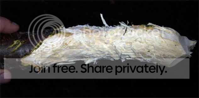

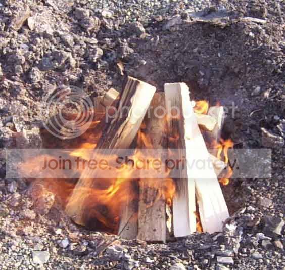

with the smaller pieces were carved to make shaving sticks. This enables a fire to be started essentially from a solid log with no tinder :

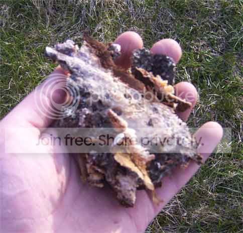

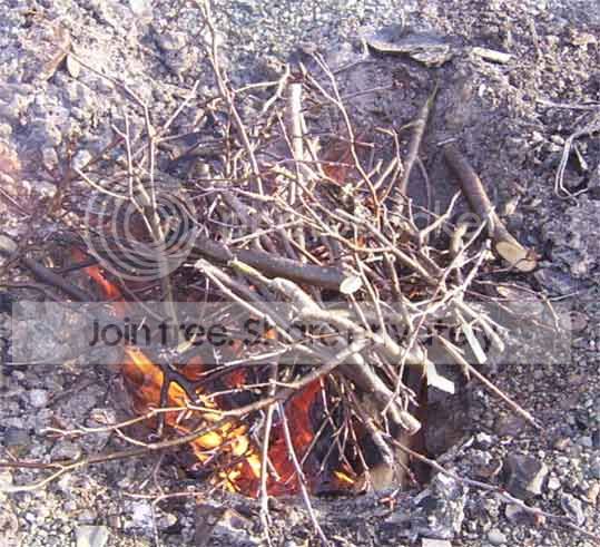

I also used a bunch of pitchy bark to keep the flame going in the beginning as the wood was not well seasoned :

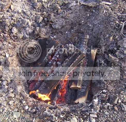

Once all the wood burns down to a nice coal bed :
there is usually enough heat to burn fresh wood, this is a pile of Alders :

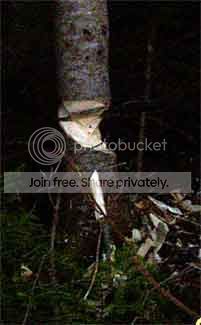

With a small blade kind of, here is the process with just the blade and no precut rounds to start with :
The piece of hardwood was directly cut with the knife, which a longer Mora which has enough chopping ability to cut the baton shown directly. Both of the sticks in the picture were cut :
The larger one required multiple notches to open the front as it was to wide to cut in one pass, so it needed side relief notches, but it was still only a few minutes to clear the front and do a single cut on the back. Once felled they can be cut to rounds in the same manner and then be split directly :

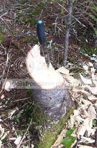

These are small, but if for some reason you want to cut much larger wood, it just takes more time :
That is about half way through a six inch tree, takes awhile to baton that and it is a bit more wood than is needed, and the point at which you really start to be wanting an axe, but in about half an hour it is down :
