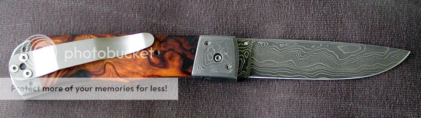

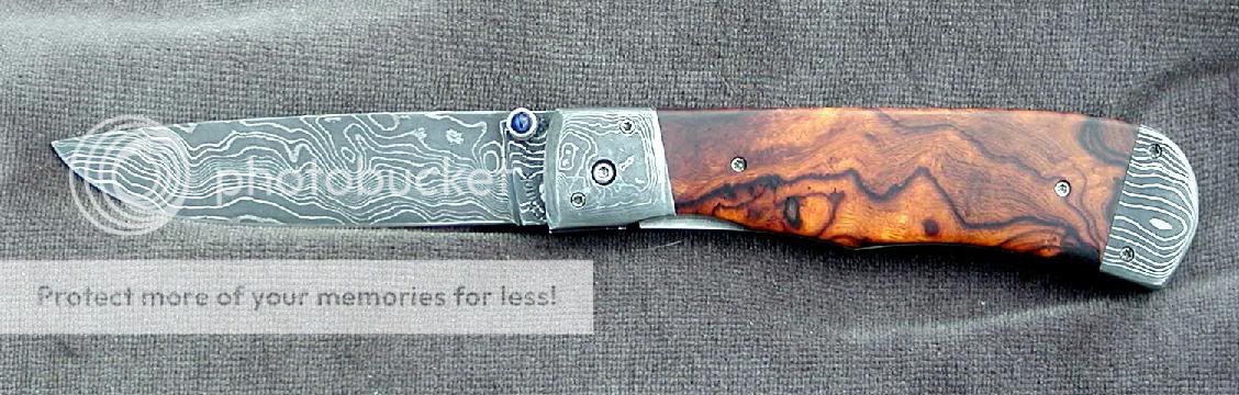

Sigifrith had emailed about his enjoyment of the Spydie sharpener and how he sharpened EVERYTHING IN THREE MILES:D
He also did his Sebenza and his
CHUCK HAWES DAMASCUS FOLDER !:eek:
Here it is. I couldn't bring myself to reduce it. it is lovely...
and here's clipside
C'mon now
Give us details of this beauty...
Steel
stone
bolster
liner
scales
pins
What's the end cap called??
This is among the coolest I've seen...
Has the 204 scratched the blade at all?
INQUIRING MINDS NEED TO KNOW ALL THIS....
