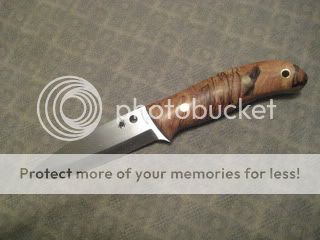

I live in Colorado, so cracks are a way of life here for a lot of natural materials - mainly wood and horn. Bone seems to hold up fairly well, as does micarta and g10, of course. I got mine today, and the wood is beautiful. It has 3 deep cracks, and I'm re-reading this entire thread before settling on a course of action. If the wood hadn't shrunk, the handles would be fantastic. They are bigger than I expected, but very comfortable.
I was disappointed with the rest of the knife though. The tip was bent, the edge wasn't very sharp, and has several chips in it. They will sharpen out, but it will take several sharpenings. The spine has a couple of large dents in it. It looks like someone really screwed around with this knife before sending it to me. All of it is repairable except the spine, and of course, being a second, there's no recourse. I was expecting all the handle issues, but it was very disappointing to see all the blade damage. This is the first time that I've been let down by Spyderco like this.
On the positive side, I love O1, and that's the primary reason I got this one. I'm going to give the scandi grind a chance, and hopefully I'll warm up to it. If not, it's off to Tom Krein and will come back full flat, should be just about perfect in that configuration.

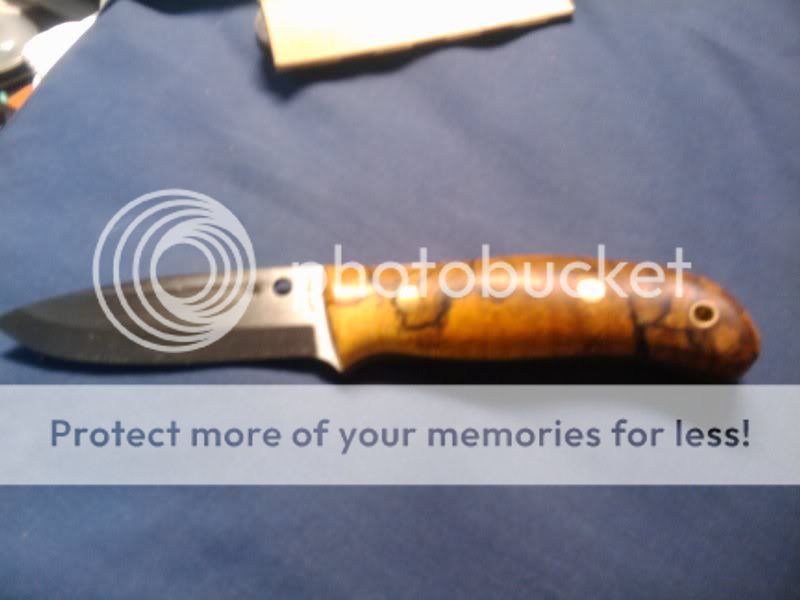

Sorry, I wanted regular pics. Oh well, best I can do in a hurry. :o So far I'm happy with the results. I did think about submersing it in warmed oil but was afraid the glue wouldn't stick well to seal the cracks when finished. If it shrinks again I might try something different but for now this was quick and easy and gave me very good results. :thumbup:

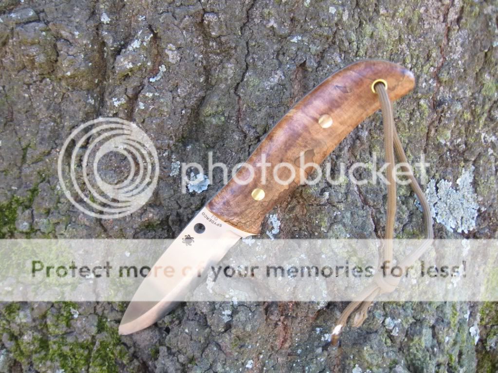

Mine arrived a few days ago, and is typical of what everyone else received. Some of the cracks were pretty long and wide, and the scales had shrunk a bit such that the tang was exposed a tad. But I have the day off and just infused some superglue into the cracks, and sanded/rubbed things back down. Now it's soaking in some warmed BLO. I'll probably let it soak for a week or so in the BLO, and then let it dry for a day or two. Then it'll get a few coats of wax, and hopefully have a long life thereafter!

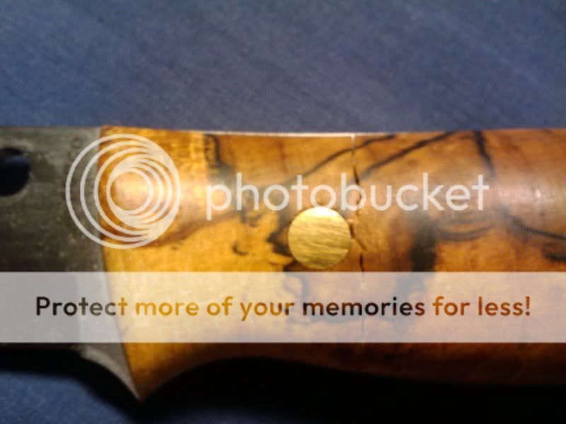

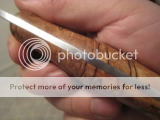

Question: I don't know if you can tell from these two pics, but when I grip or run my fingers across the handles where they are attached to the tang, I can feel the sharp edges of the tang's steel. If I am using CA/super glue to fill the crack I have, would I use this to attempt to "even up" the edge of the wood with the steel? Or, better yet "how would I smooth out the transition between the wood handle and the steel tang"?
Thank you for any help offered.
The wood is shrinking, which makes the steel become 'proud' of the handles...
You could use a really super fine sharpening stone, if the knives are still available when I have the cheddar, I will probably use the white stones from my Spyderco Sharpmaker. I have smoothed steel edges this way in the past.
Really, you don't have to cut the steel down, you just have to take the hard edge off the steel, then it will 'wear' well.
Another option, would be to wait until you fill the cracks with CA, I would suggest black CA, as mentioned in my earlier post to this thread... Then, you will likely want to clean the handle up, probably with some steel wool, or a very fine sandpaper, and at that time, you can cut the bite off those steel edges...
