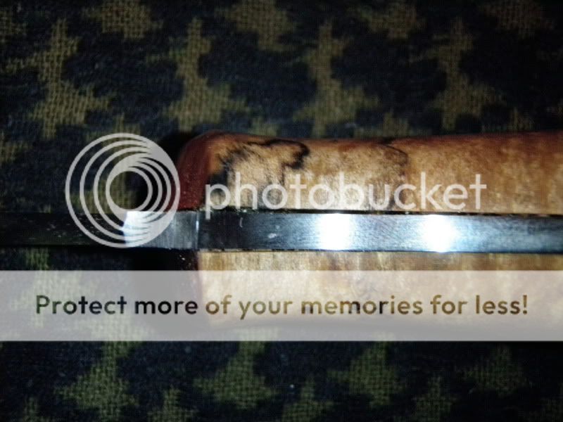

Mine arrived today.No cracks and only a tiny bit of separation of 1 scale.Although scale shrinkage is noticeable.
The separating section...
The shrinkage from both sides.....
Apart from this the knife is 100% solid.It feels really great in the hands.Sharp as hell too.A little crazy glue and I'm good to go.

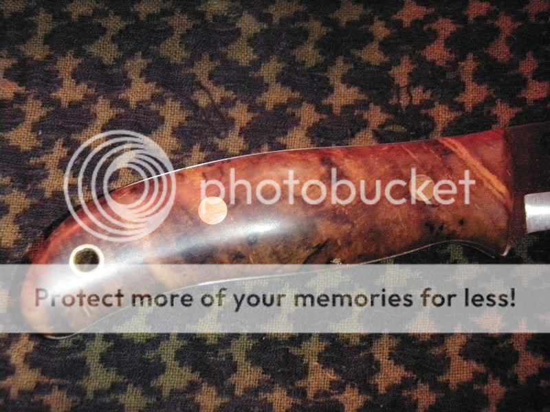

I wound up steaming the handle on mine. It showed more cracks,and caused a little bit of tang/scale separation
I used CA adhesive and pressure to fix the separation. I used the CA to fill the cracks.
I then sanded the wood with 200,400,800 grit paper, and after it all dried, I applied MinWax Maple stain. I did several applications, brushing with 000 steel wool between coats.
When that all dried, I finished with a MinWax polyurethane top coat.
Looks great now, No cracks visible. The handle seems to be on right, and I love the knife.

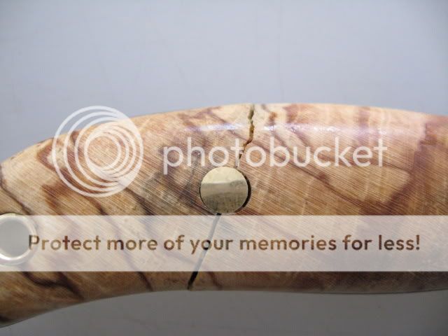

I got mine - a single crack across the width of one scale (through the lanyard hole). Some shrinkage from the tang as well. I filled the crack w/ superglue, then lightly sanded & then soaked for 2 days in boiled linseed oil.
Looks pretty good - we'll see how it holds up.

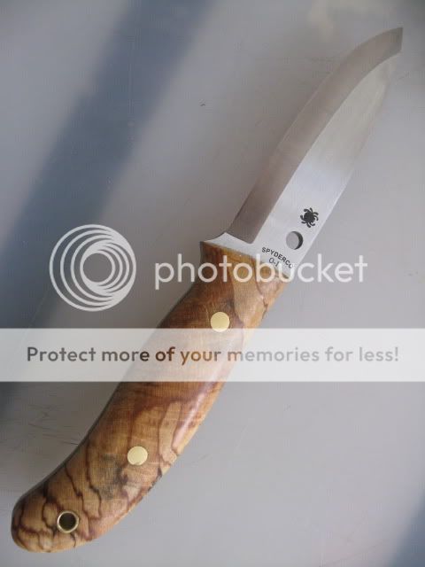

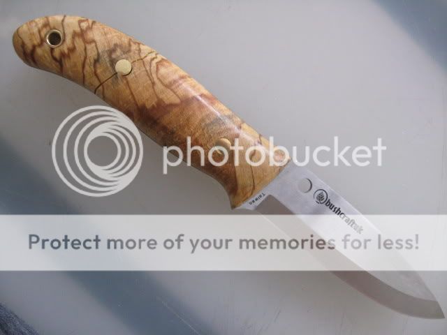

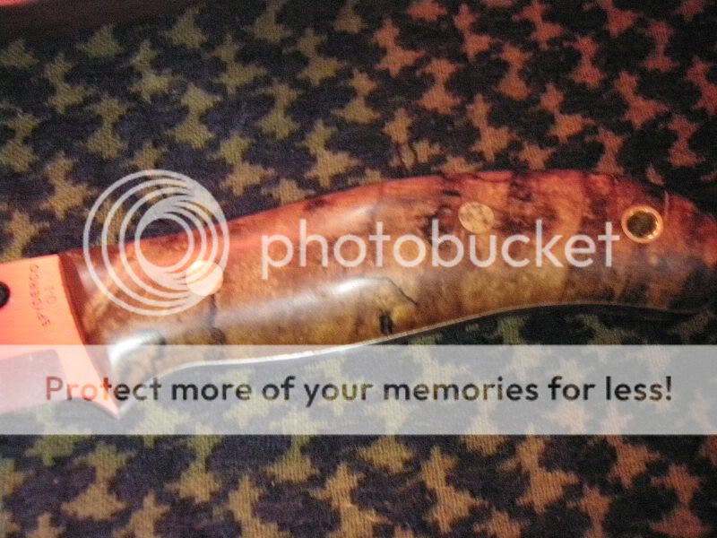

Well, this thread has been dormant for a few days, but I wanted to show my spyderco bushcraft knife. These are not great pictures of a great knife. In the closeup, you may be able to make out the crack that I filled with superglue in the middle of the picture. I also finished the handle with several coats of formby's tung oil finish. The only blemish other than one crack in the handle is that the tip of the knife, and I mean the very tip, is bent just slightly. It should sharpen out in a few passes. I consider myself very fortunate that my knife not so cracked as many that have been posted.
attachment.php
attachment.php
wow hlee, that's shiny like a holiday!

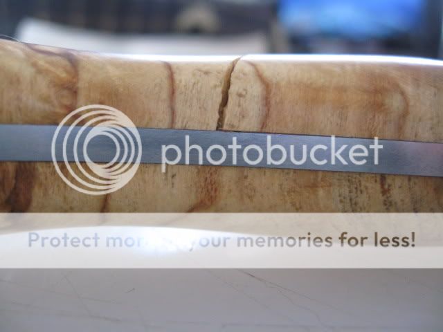

I waited a few days we started to warm up here and lots of moisture in the air. Even with the Bushcraft in the basement of the house it was able to soak up some moisture and start to close the crack. Then I went and used it to shave down some fatwood from the "Menards" Forest (lol), just to see how sharp it was straight out of the box. It was pretty sharp. I'm still working on my sharpening skills (they leave some to be desired), but it have been practicing with that and a few other blades & it seems like it's working so far. As I was using it, I noticed the handles started to feel like they were meeting the tang steel much more & after using it, the crack closed more. I then waited a day and a half after that and then used some super glue to fill in what was left of the crack. I think it will do nicely. It just has to perform, I'm not putting it on a shelf display, it's a worker.
