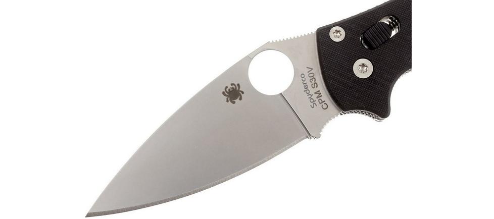

Here is the fake PM2 Tanto, the comp lock is absolutely terrible, you can very easily tell and feel that this is not a Spyderco, unless you've never handled the brand.
Also there are visual features, like the F'ed up spider logo, the font is off compared to the real PM2 and the ricasso line does not go past the hole like it should. Also, the liners are still not nested, which is good, this is the most obvious thing to check for so as to not buy a fake PM2.
Also, it says "Golden.Colorado U.S.A.Earth" on the back, not "Golden, Colorado U.S.A, Earth". Check for this, too.
So, good, there are still pretty distinguishable visual features on the knife such as this that would let someone know it is not real. Because it definitely doesn't feel anything close to real, feels like a terrible backwards liner lock.
