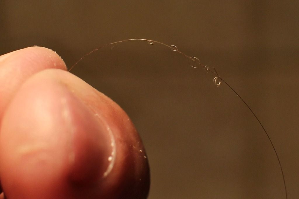

40 degree microbevel. A few quick passes on the sharpmaker with the regular fine rods. I might be able to get this steel sharper than super blue.

Very nice, excellent show of skill.
I am finding very good performance with my HAP40 Delica too. I cut a lot of heavy plastic sheeting and various other construction materials, ran it into some dried grout on a tile floor with minimal damage to the edge, just a little flat. I have also hit a few nails cutting along boards, again only producing a flat spot in the edge. No chipping or concern of it from what I have experienced so far.
I sharpen with waterstones to a 2k finish, shaving sharp but aggressive and has worked well so far. I will probably try a finer finish after seeing your photo though, looks like it gets pretty sharp ;)

Thanks man, you were actually one of the first people on this forum to offer me some sharpening advice several years ago. As far as edge finishes, I am going straight back to a 1200 grit dmt finish as that is way more functional for my daily use and is still crazy sharp on this steel. I had to take it up at least once though just to confirm what I already knew from how it sharpened at lower grit.

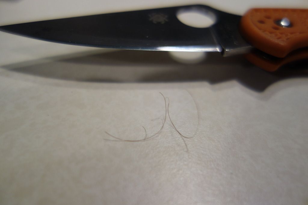

Lances pic is better but I was having a hard time not cutting through the hair.
This is a freehand bevel around 25 degrees finished on the UF stones. I had a bur after reprofiling so I cut it off on the edge of a spyderco medium stone and then put a 30 degree microbevel on it with the sharpmaker using the medium and fine rods only.
