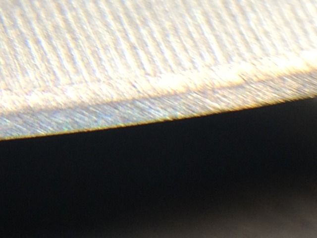

I was having some binding issues while cutting and decided to thin the edge a bit. I was maintaining the factory bevel which was fairly nice but I would guess it was around 40 inclusive and that is much too thick for me. I started with my Kohetsu 800 and finished with the 2k much sharper now with better cutting performance and no binding. Probably 30 inclusive now.
Here you can see the old edge (1200 DMT) on the lower half and the 800 grit new bevel starting on the shoulder.

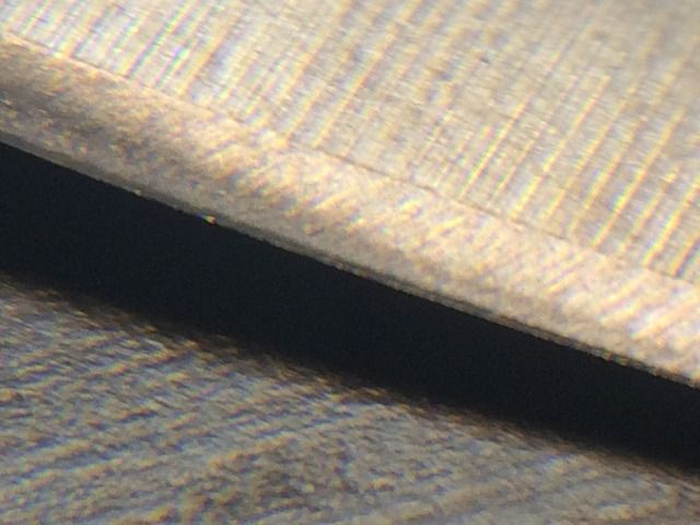

And just before the the new bevel is complete,

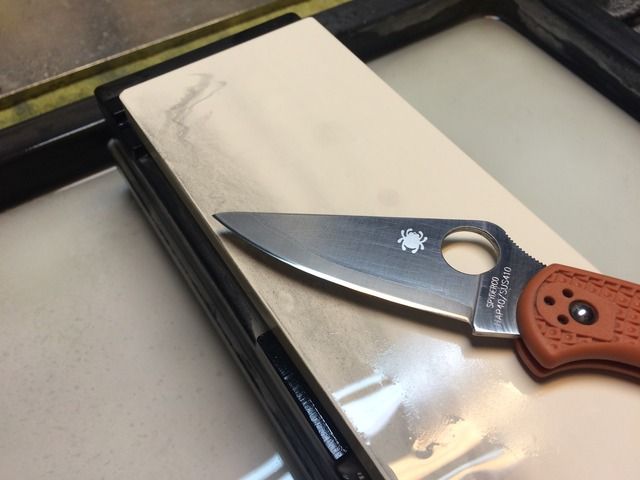

The edge is not very shiny in person but caused all sorts of issues with pictures so this is the best I could do,

Interesting. I have read others stating that the factory edge on their Hap40 Delica/Endura was around 30deg inclusive. My experience, however, was the same as yours...factory bevel that appears to be around 40deg inclusive. Haven't had the wherewithal to do a new bevel yet. Thanks for the pics!
Hmmm... Both my HAP Delicas came around 30 degrees. All my Taichung Spydies have been coming with 40-45 degree bevels but my Seki knives seem close to 30 degrees. I took one of my HAP Delicas down to around 25 degrees and put a 30 degree microbevel on it with the sharpmaker and it is wicked. I have been running my Super Blue Delica at 20 degrees with a 30 degree microbevel for a long time and will do the same with the HAP Delica when I find the time. I love this HAP40 myself.
