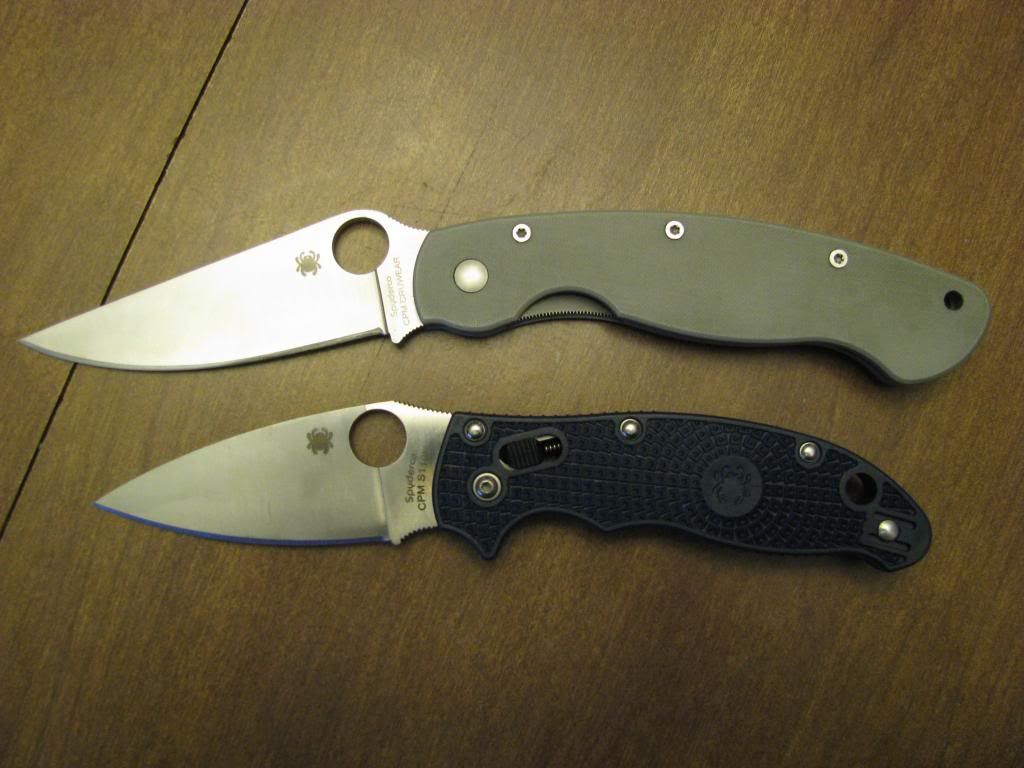

They are out:D
This is my only Manix though, so I cannot comment on interchangeability. I like it just the way it is. Unbelievably light.

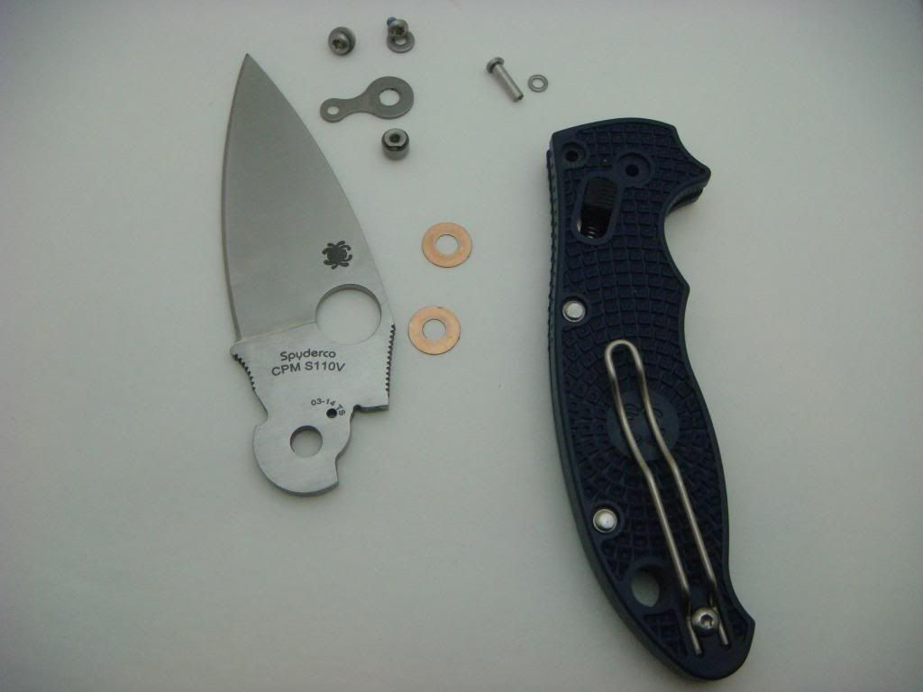

I just got around to milling out one of the rivets,until flat with the washer, then punching it out.Afterwards,I was able to spread the FRN handle scales enough that the blade, pivot,washers,and pivot arms just fell out.Note - All without damage to the scales.

Cool, the dilemma you face now is that you have to remove the other pins to re-assemble with another blade, as fitting the pivot & figure 8 liners needs specific lineup with the flat sections....
